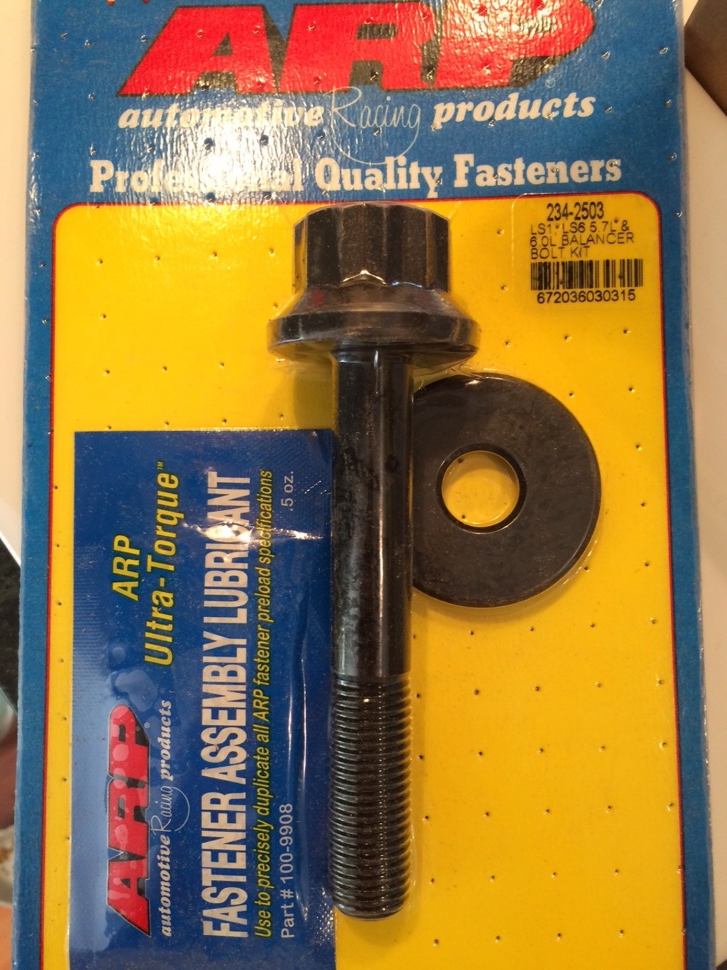

This is the correct bolt right??

For the balancer yes.
I've never felt the need to spend the $$$ on ARP though. You'd have to do 5 cam swaps to cover the cost versus a stock TTY bolt.

Yeah it's certainly more expensive. But seems more straight forward to just torque to spec than the whole tighten and then extra 1/4 turn or whatever it is to stretch.
speaking of which, what is the torque?

240 lb/ft I believe.
Also, the stock bolt is very easy to torque. I just drop a line on the bolt head with a permanent marker and have at it.

Put a little dab of blue loctite on the threads. Ive had one of those bolts back out while driving...not much fun...
