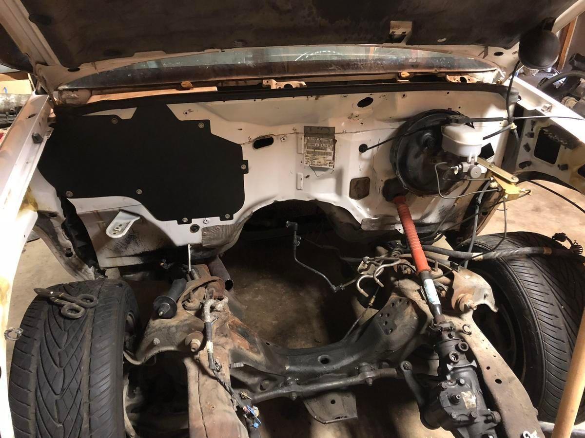

Got a little done tonight, not as much as I had hoped due to some unsuspected stuff.
First thing I did was clean up the firewall. Then I got my HVAC delete installed.

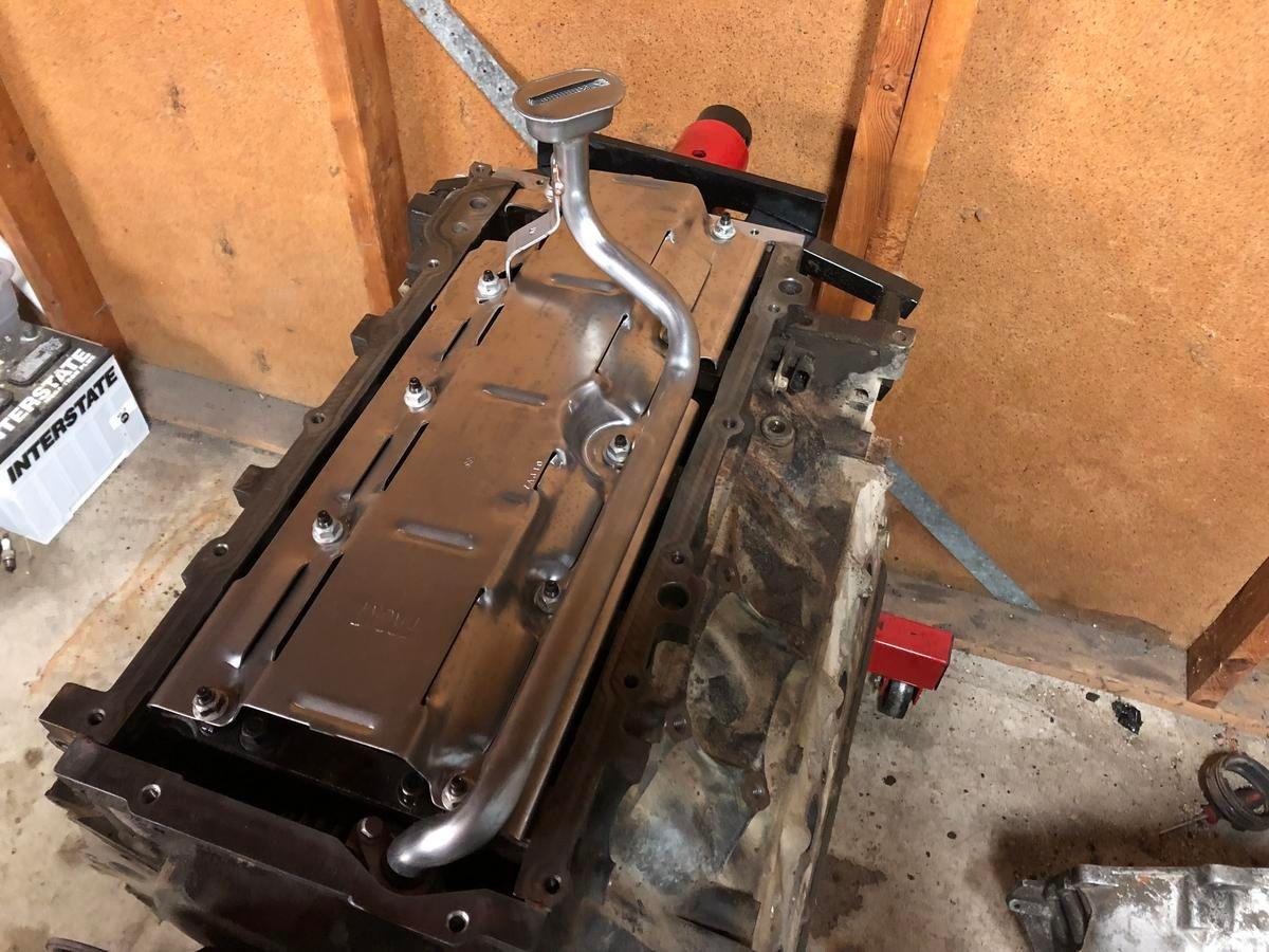

After that I tore my engine down to the bare assembly. I was going to leave the valley cover on, but noticed it leaking pretty bad. I pulled the wire harness for the knock sensors and saw they were both broken and one of the ports was filled with oil. I am pretty sure I am just going to ditch the knock sensors. On solid mounts they won't be hugely beneficial anyway.
I did manage to get the new pan kit installed and everything stripped down on the engine.

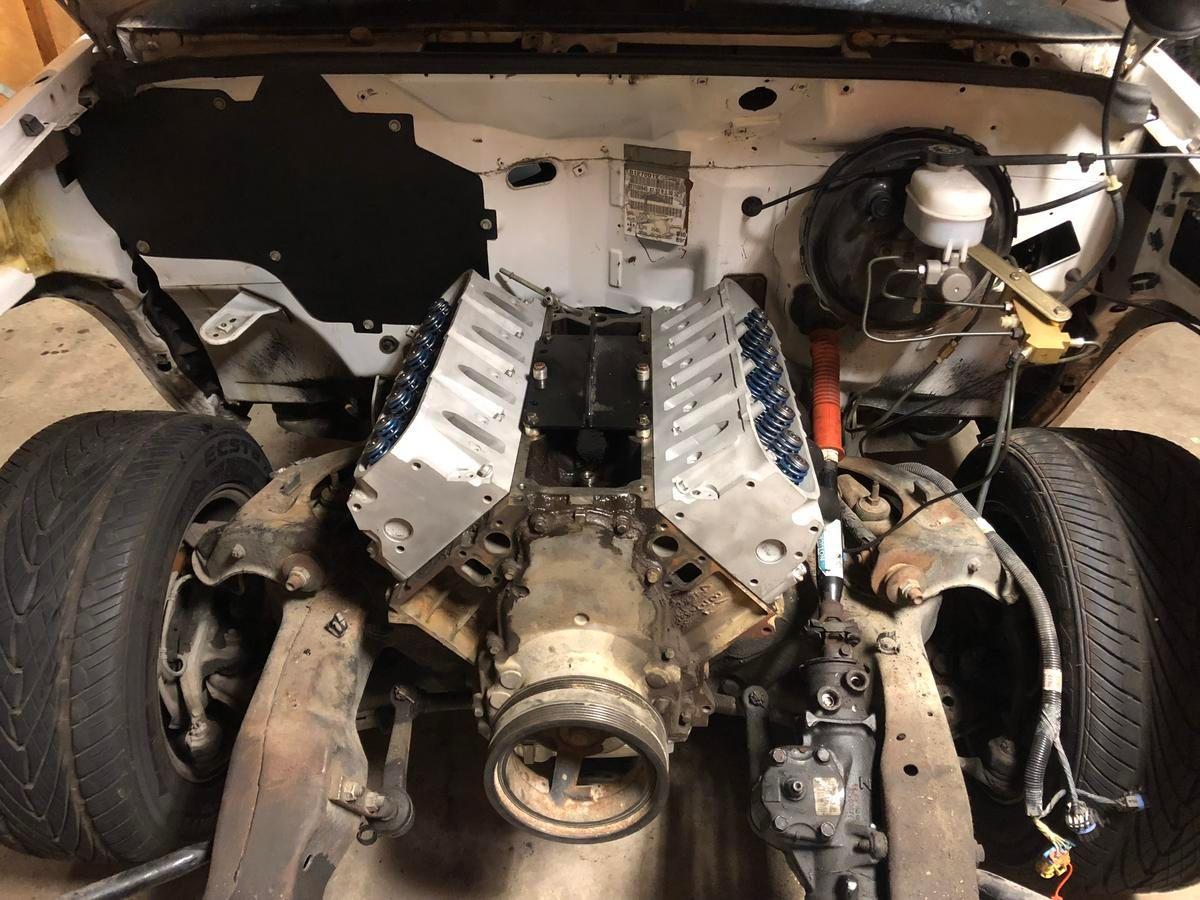

Tonight I got some engine work done. I cleaned up the deck surface with a gasket removing wheel. Also because I am paranoid I cleaned out the bolt holes about 2,900 times. Got the heads on and torqued down. It will likely be a few days before I can work on it again, but next up should be getting it in the truck and test fitting the headers.

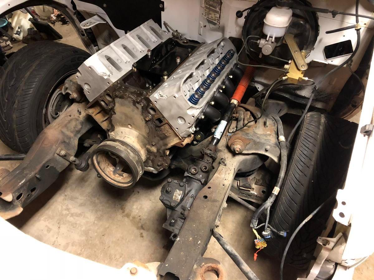

I got a little more work done the past couple days. The engine is in place and the driver's side manifold clears...barely. The Passenger side does rub the control arm just slightly. I plan to clearance it by taking a little off the edge of the control arm. There is a pretty healthy amount of ground clearance, which is nice. Also, I'm pretty sure there won't be an issue running the truck intake and maybe even the engine cover.
I had a few more pieces show up. Nothing too crazy, some braided sleeve, a few sensors.
Engine after being installed:
Clearance from the driver's manifold to the steering shaft:
Where the passenger side manifold hits the control arm:
Ground Clearance:

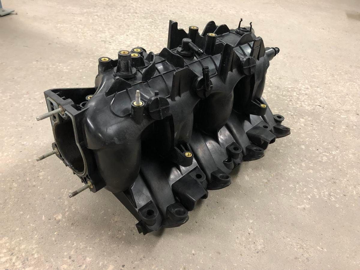

I fit the 4 port steam crossover I have and test fit an old intake manifold. I will be using a different unit as this one has some cut off barbs and a few of the brass inserts have pulled out.
Everything seems to fit fine. I was hoping the factory engine cover would fit under the hood, but knew that was asking a lot.
The intake I will be using was very dirty, so I spent a little time cleaning it up.
Stripped down the the bare manifold.
After cleaning. (Not perfect, but a lot better)
