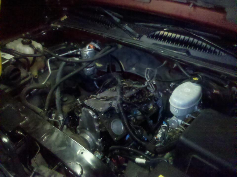

well its 4:00am here, got the shortblock set in the truck, bolted the trans up, converter, and installed all the sensors..didnt start on it until 11p.m. and called it a night around 3a.m. dropped it in by myself since theres no one up this late that could help. wasnt to bad, went smooth.

Old 07-30-2012, 04:08 AM
  #46
03sierraslt's Avatar
Join Date: Jul 2004
Location: Western PA
Posts: 19,004
Received 216 Likes on 172 Posts
Your making progress.

its getting there. hopefully ill be able to atleast fire it up and let it idle within the next 3 weeks. just waiting on push rod length checker to come in the mail..then to order pushrods. first start video will be posted. stay tuned in!

Don't forget the ground on the back of the block when you put the heads on... LOL
Old 07-30-2012, 09:56 PM
  #49
iamkeniff's Avatar
Join Date: Apr 2007
Location: Gonzales, la
Posts: 5,365
Received 3 Likes on 3 Posts
It would have been easier to put it together on the engine stand imho. But so far you have a pretty good platform going on
Old 07-30-2012, 11:17 PM
  #50
2doorfury's Avatar
Join Date: May 2011
Location: Franklin, IN
Posts: 1,173
Received 2 Likes on 2 Posts
i figured it would of been way easier to get to the bellhousing bolts with the heads off..and i didnt have to take hood off. it really wasnt too hard putting the heads on in with the engine in. yeah, torquing them would of been easier out, but id rather take that that then sqeezing my hands behind the heads and try threading in bolts.
