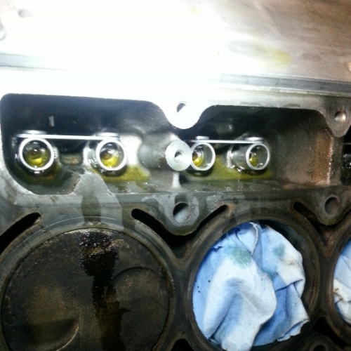

Heres those coolant steam vent block offs

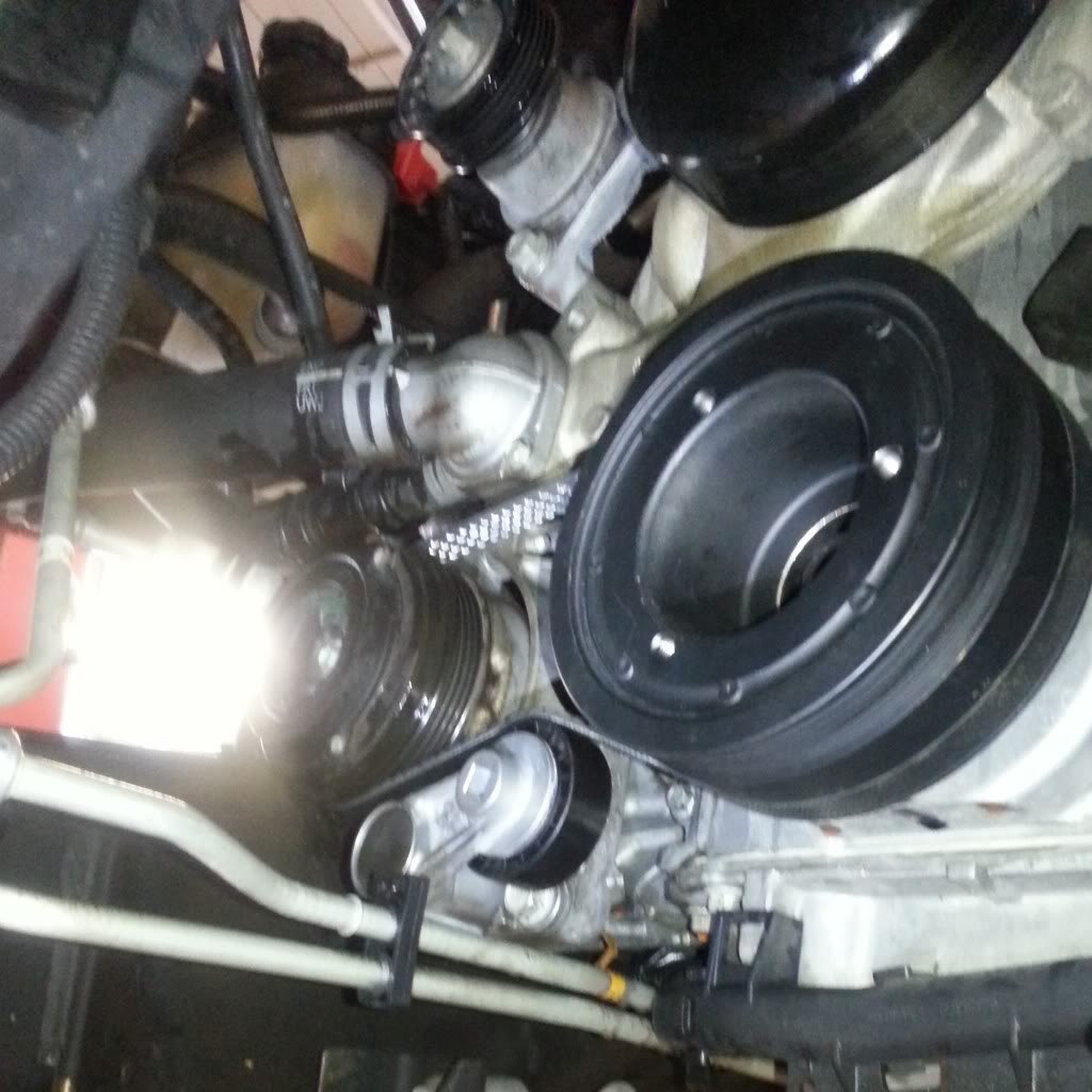

I got myself a A/C tensioner for a 03 and ordered the bolts from GM, with the ASP crank a 34.2" belt was a snug fit but I'm glad I went that route over the 34.6" that ASP suggests, put the belt behind the crank, route over a/c, flex tensioner then hook onto crank, its to tight to do any other way

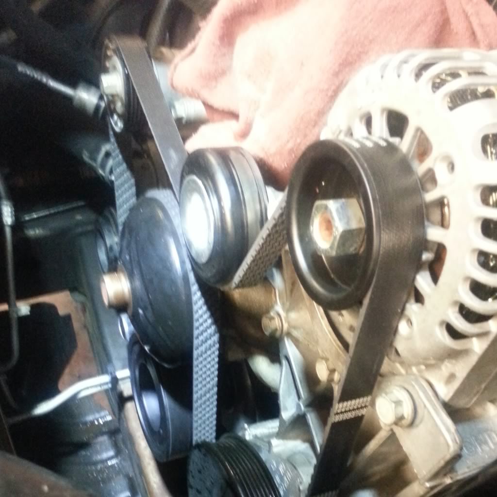

with the ASP over drive alt, I tried making a 89.5" belt fit but it was to small to hook under the idler, so the next step up is 90" which is the one ASP suggests

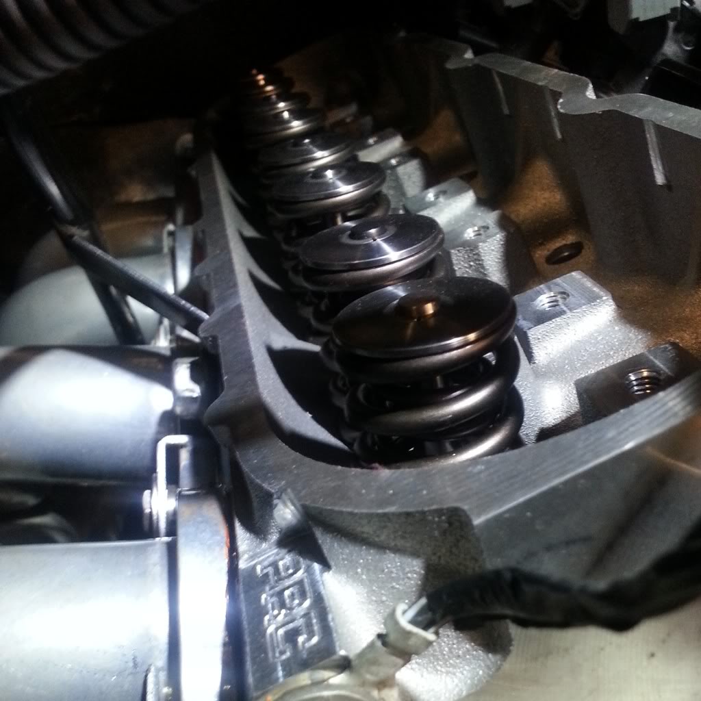

I just like this one haha, I may have to retake a better one with my good camera before the push rods come and I button it up

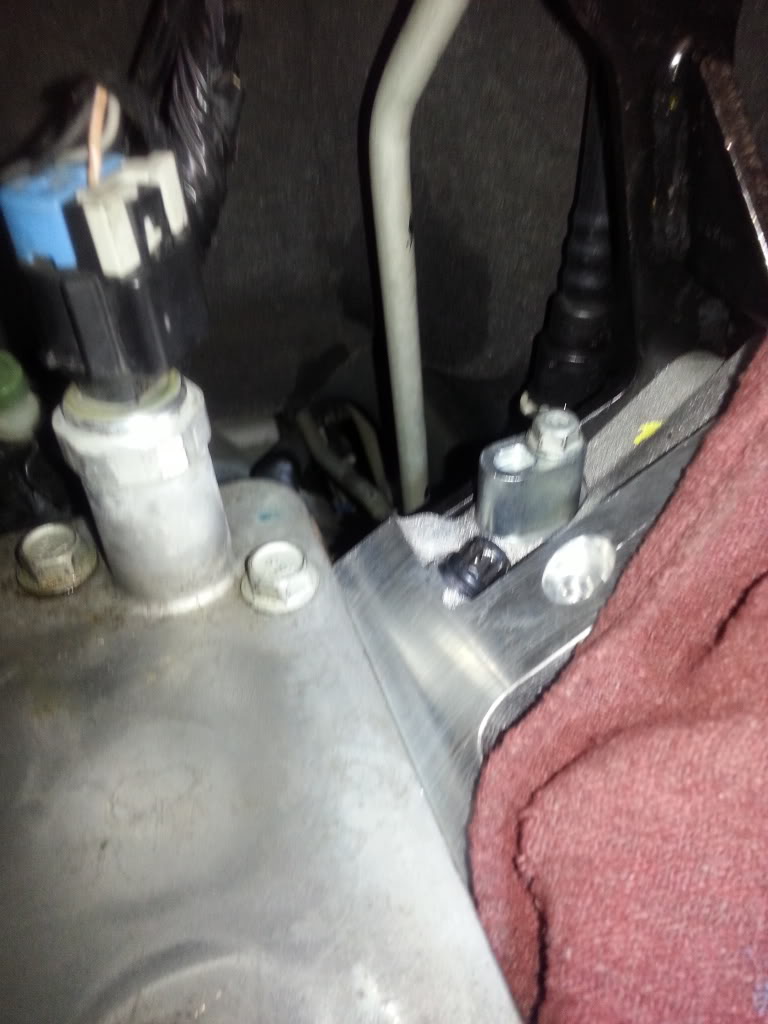

I forgot to upload this one, Brian tooley lifters installed
