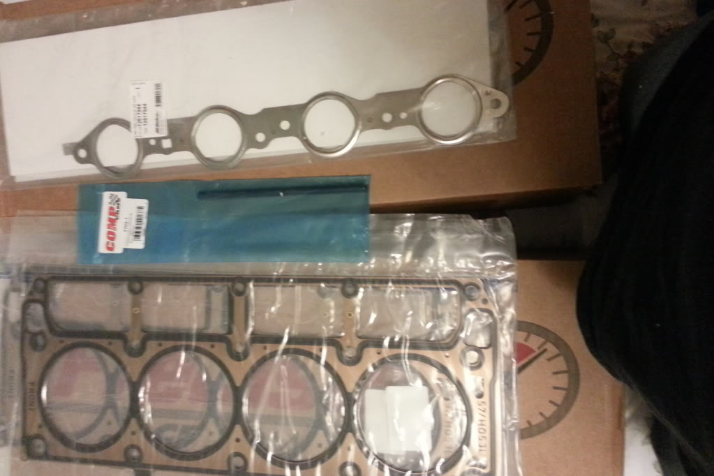

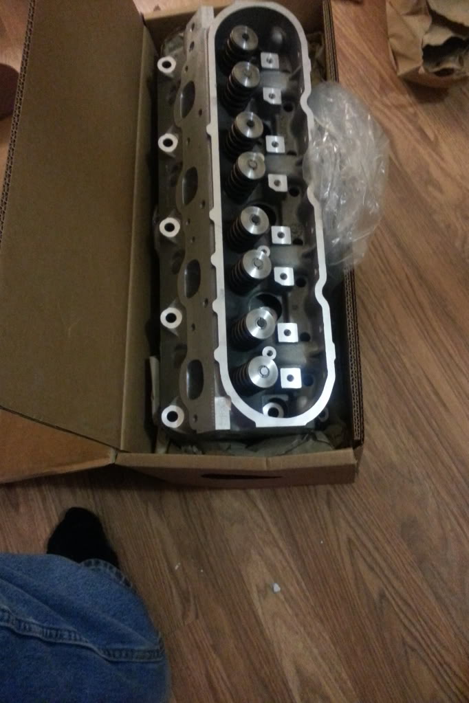

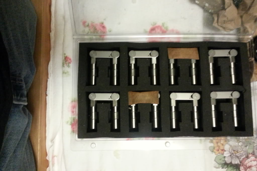

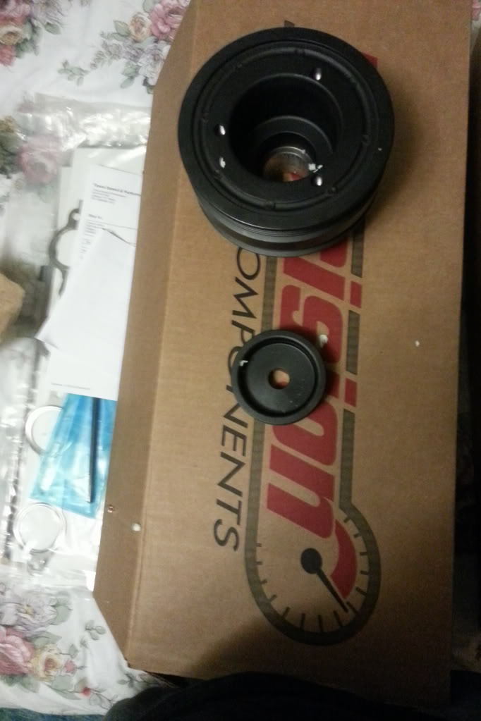

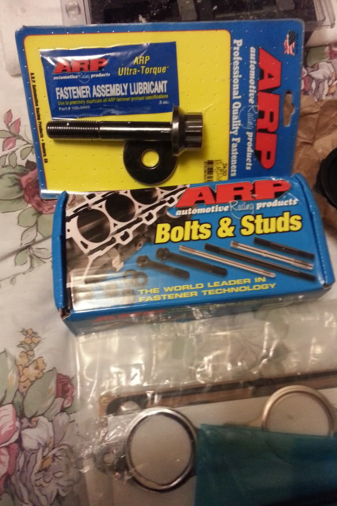

the only packages that I cared about showed up today!
Brian tooley link lifters
PRC Stage 1 243 heads shaved 0.035" /w double springs
ASP underdrive pulley's
Gaskets
ARP Head Studs + Crank Bolt
& Comp Cam Push rod length checker

I don't have the instructions in front of me, but for the ARP studs, the larger ones it said I believe 3 steps to final torque of 80 ft/lbs....easy enough
but the small ones was like final torque of 25 ft/lbs....so do I do 3 steps with those?
torque the large ones to say 20 ft/lbs first pass and the smaller ones to like 5 ft/lbs?
install all the studs.
Do the first torque value for the large studs. Then "snug" the small studs . then go to the 2nd and 3rd values for the large studs. Last torque the small studs down to the value specified by ARP
Then drink and beer because you are done

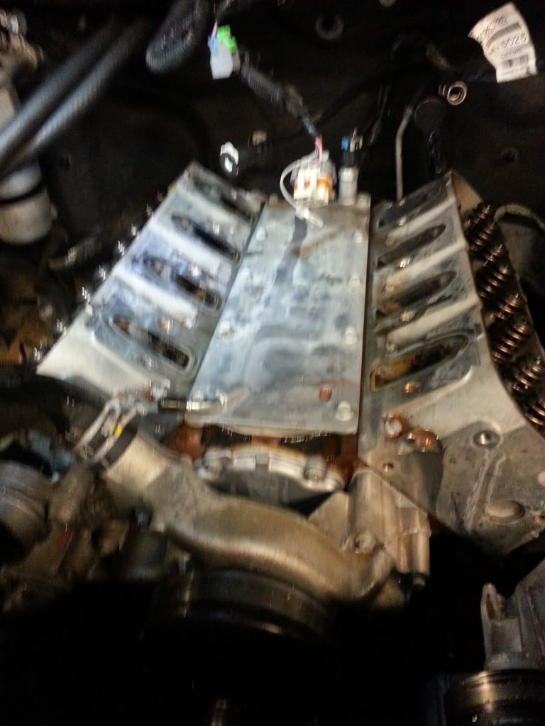

coffee time then undo head bolts and pull not bad for2 hours

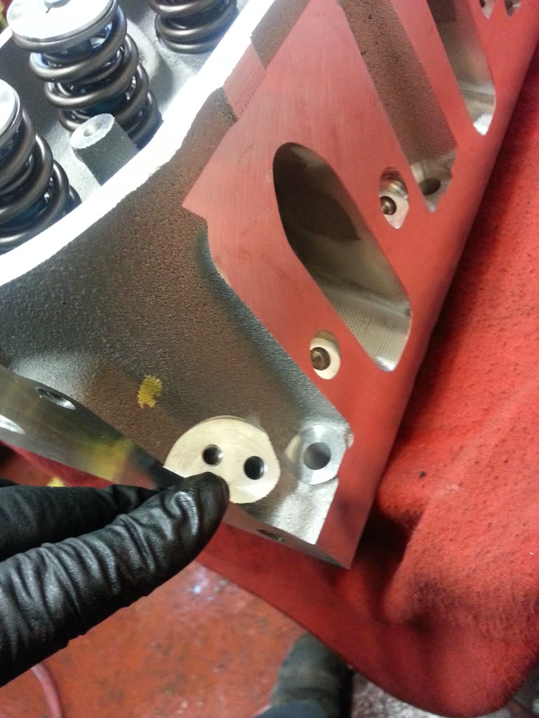

Ive hit a snag
for the coolant cross over tube or steam vent I think its called. My factory heads the rear one is blocked off. The prc heads that hole is open. What can I use to plug it?

Old Dec 14, 2013 | 01:09 PM
  #29
RS/SS 4.8's Avatar
10 Second Truck Club
Joined: Jul 2012
Posts: 1,258
From: San Antonio Tx
Just transfer the ones from your factory heads to the new heads. It should have a 10mm bolt holding down a "plug" on the rear of each head.
Old Dec 14, 2013 | 01:18 PM
  #30
AUTOT3K's Avatar
Joined: Sep 2012
Posts: 1,327
From: Calgary, Alberta, Canada
No my old heads the coolant hole is like welded over or riveted so theres no plug to transfer over
