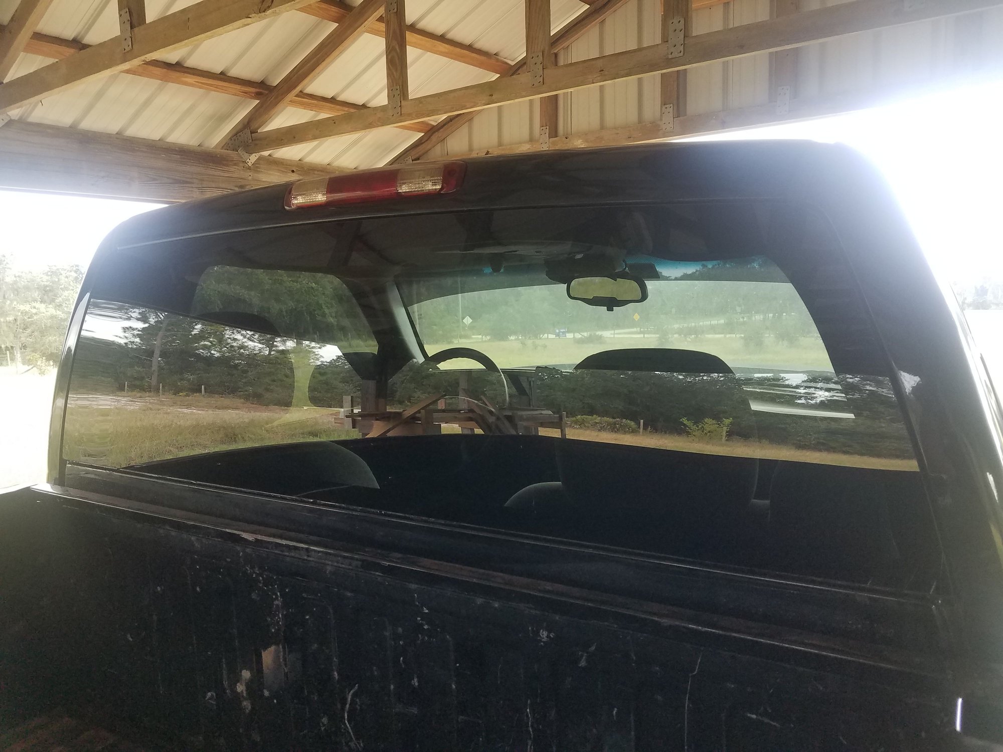

New window who dis? Finally ditched the slider that got broken into twice. I hate sliders but I also hate lack of window tint. Now when I do all the other 100 things it needs I can bump some beats and not have window rattle.

loved my slider, never got broke into (even when i tried - that time i locked myself out), and made driving with the window down SO much better.
