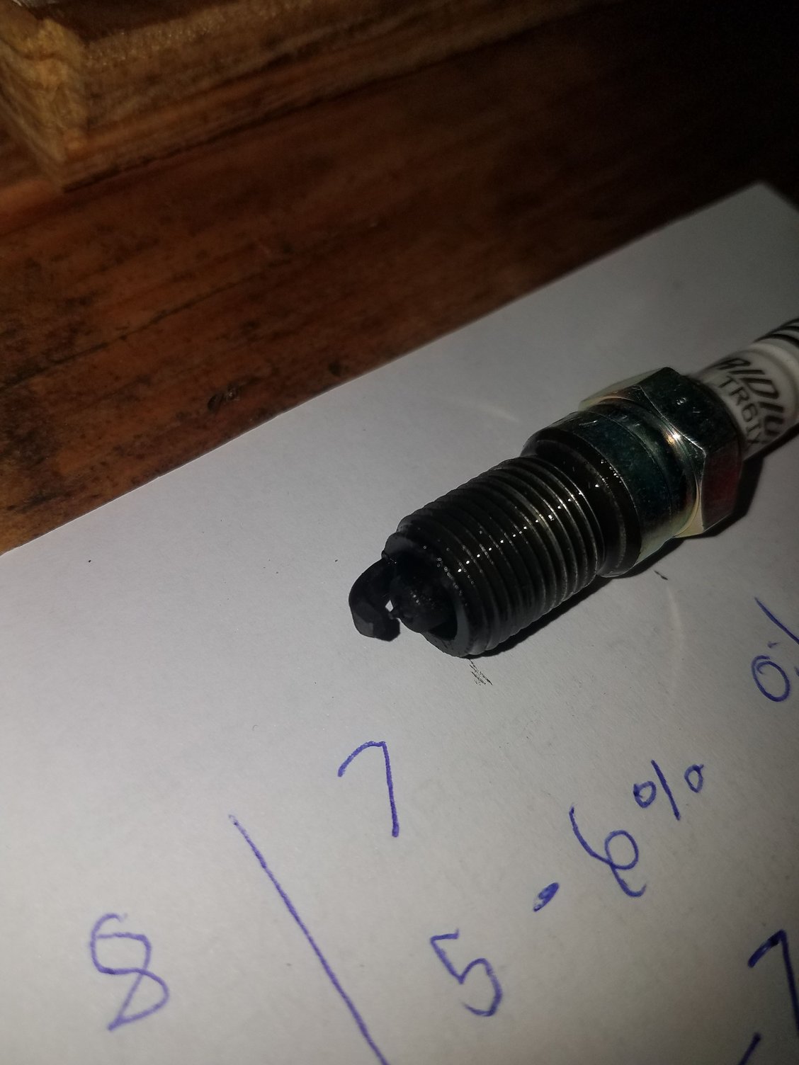

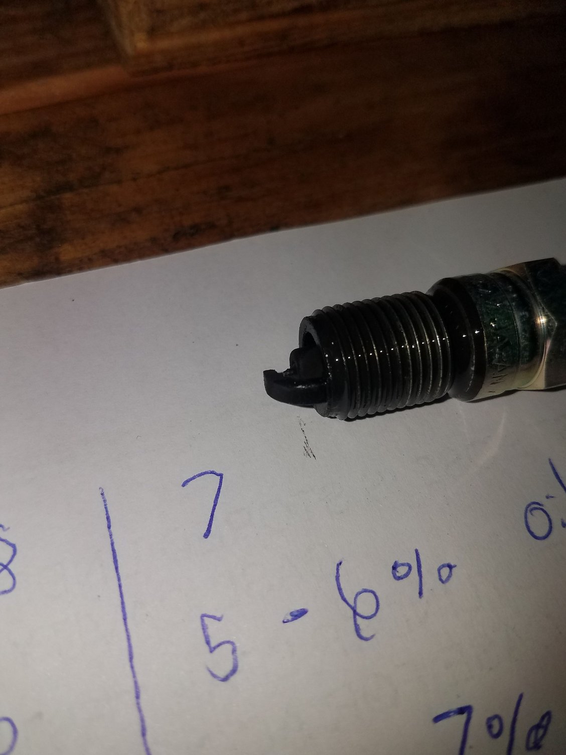

Just finished a leak down test. Started the truck let it idle up to temp then pulled in the shop and shut it down. Let it cool for about an hour so I could touch the headers without being burned and the entire test took about 45 minutes. Worse cylinder was #7 at an 8% drop. #7 plug also looked blacker than the rest. First 2 plug pictures are #7 the last pic is what all the others looked like.
