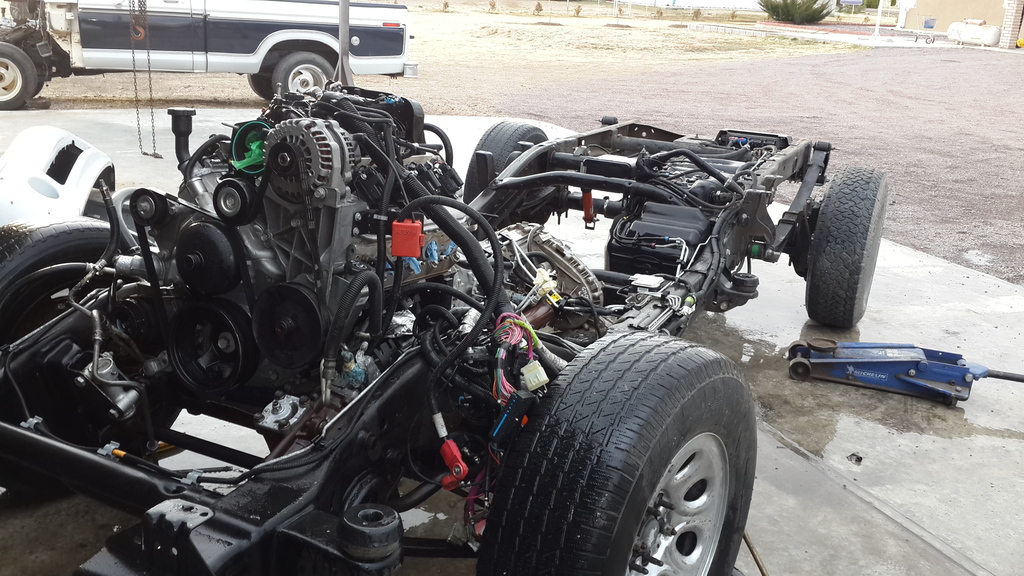

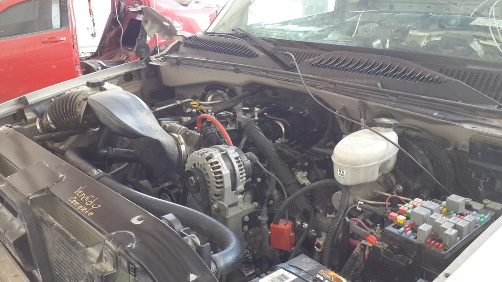

Finally working on the truck. I have it almost done now, gonna put up some pictures i took along the way.
Engine on the frame

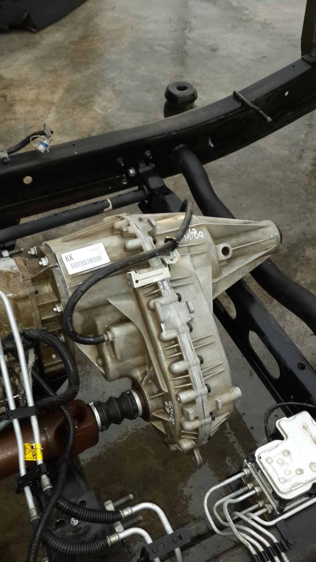

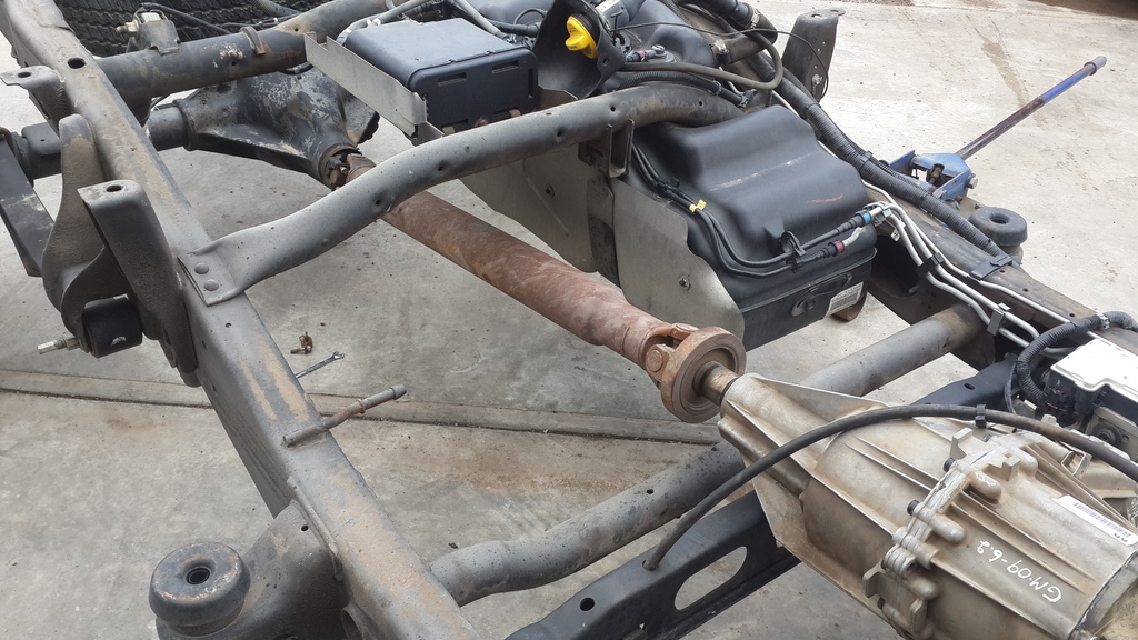

For a transfer case i used one out of a 09 AWD Yukon since the output shaft on the 4l80e is different then the 4l60e i couldnt use the original one without modifieing the output shaft so i went with this trasfer case. I just had to put in the transmission another speed sensor cause the older ones had the sensor in the transfer and the newer dont so i just put in the sensor as if it would be a 2wd and it seems to work.
With the drive shaft i got lucky, went and got one out of an 04 4WD Tahoe and it fitted without having to cut it up!

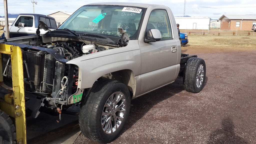

This is how it sits now, have done a bit more to it but not much. Will post some more pics when i get some. Its running and driving now seems all to work. Quadrasteer seems to work good also. Wanna get it to the muffler shop today so i can start tunning a bit

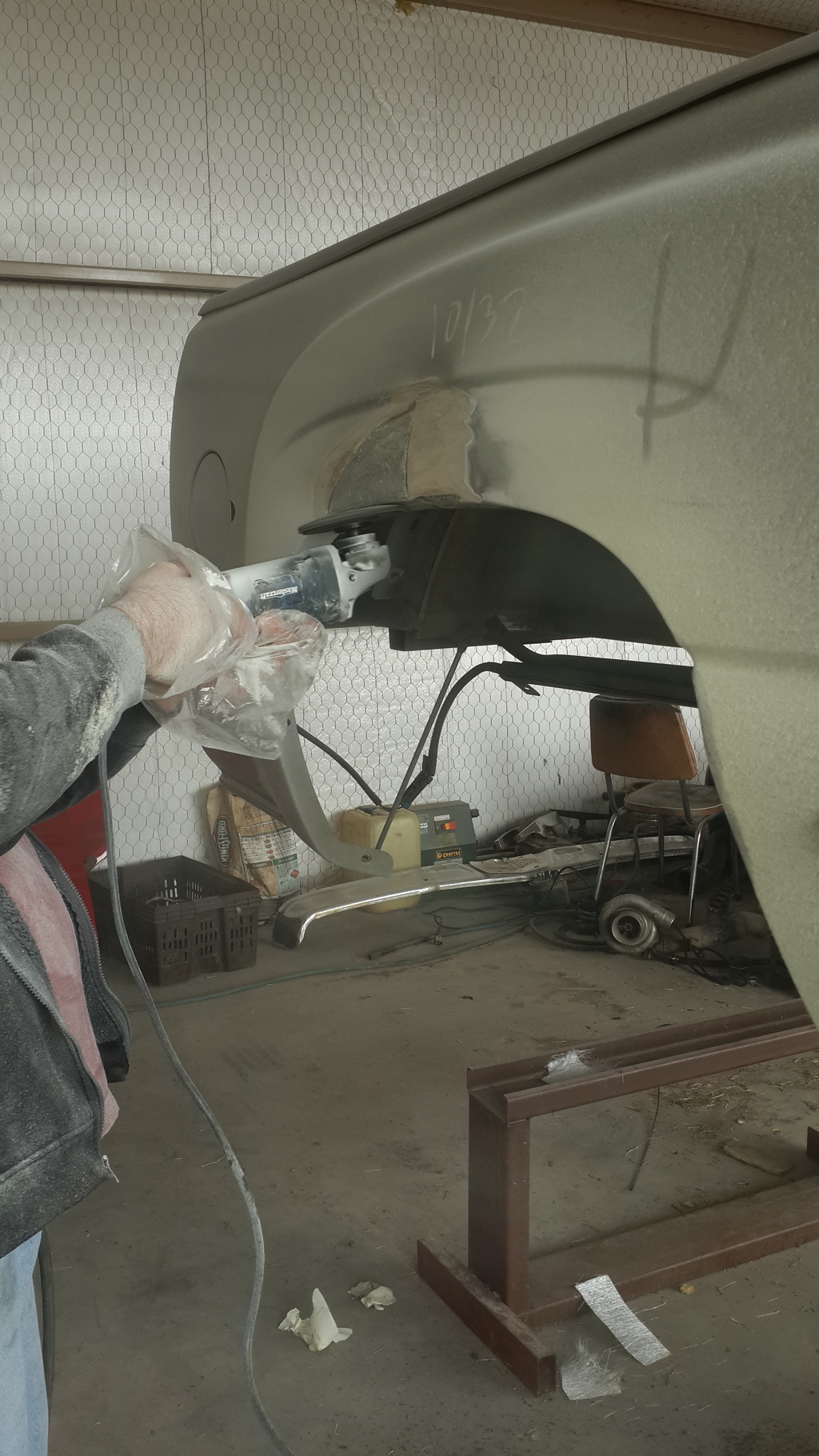

And a pic of repairing the bed!

Update:
I got it almost done now, just gotta do the buffing and i wanna do it tomorrow, and some interior work and shes done!!

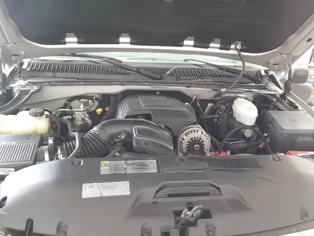

Engine bay cleaned

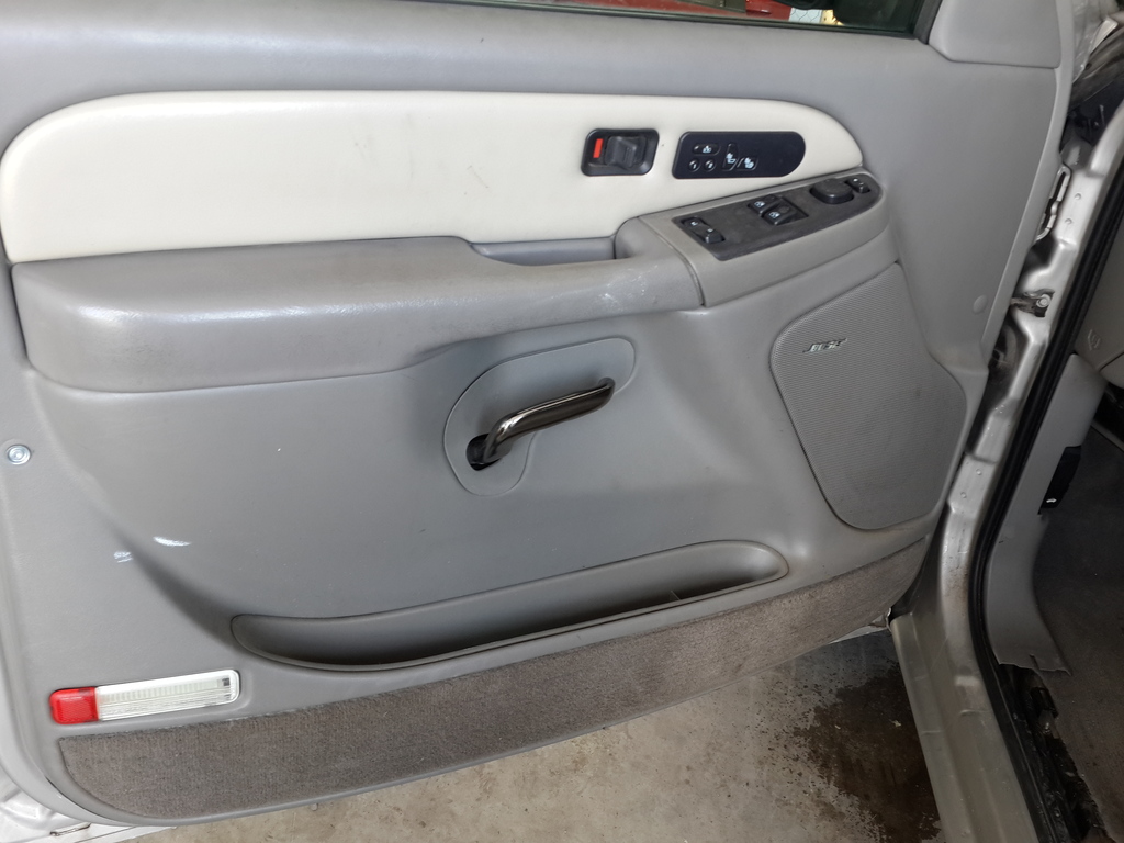

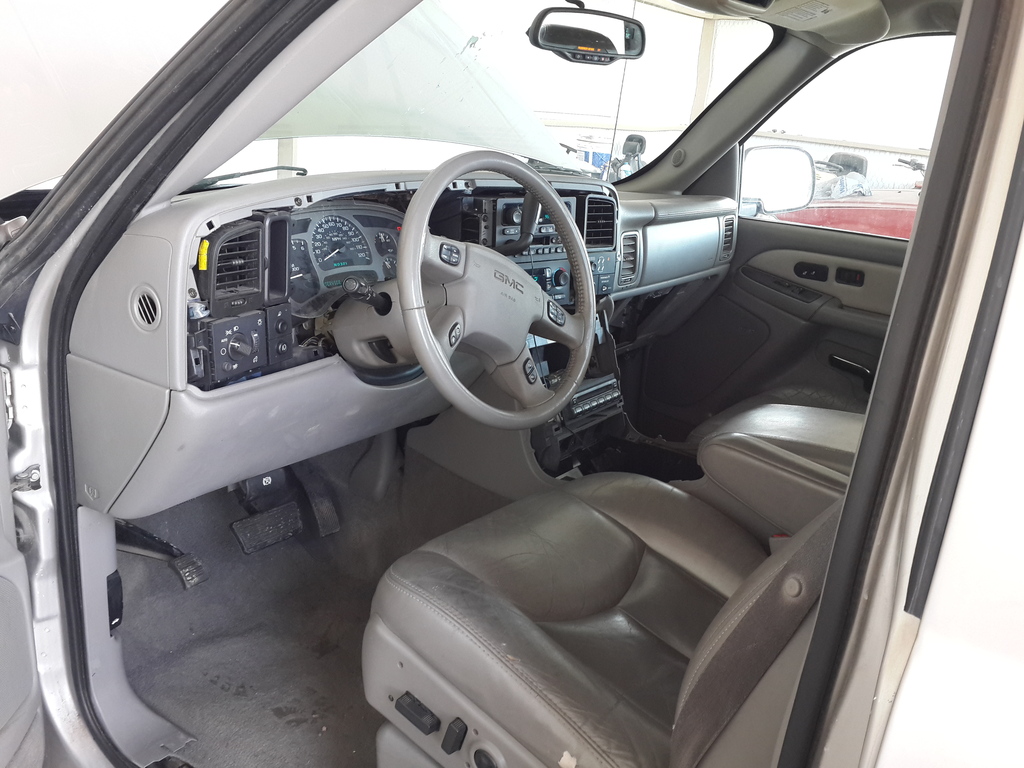

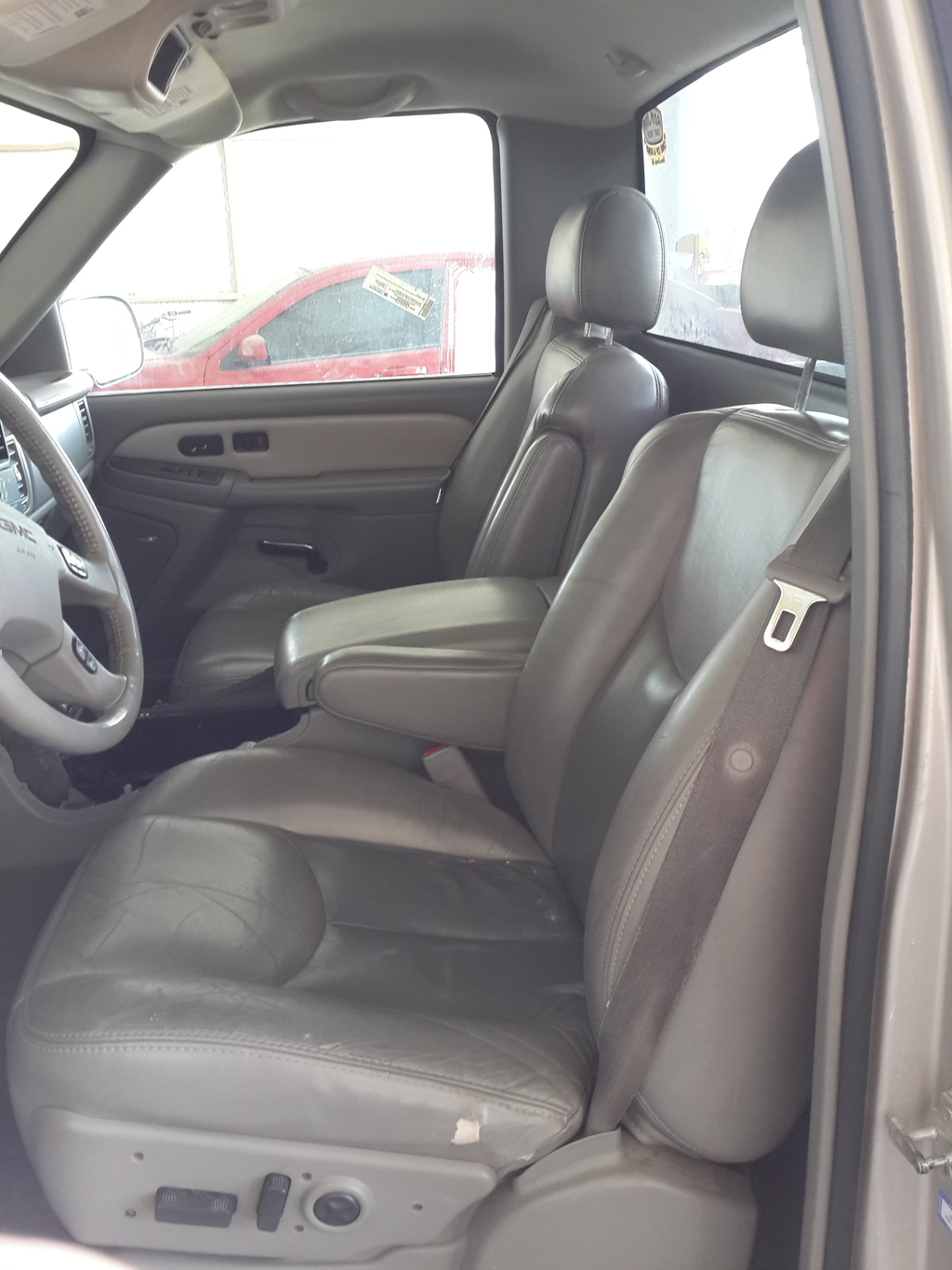

How the interior looks now

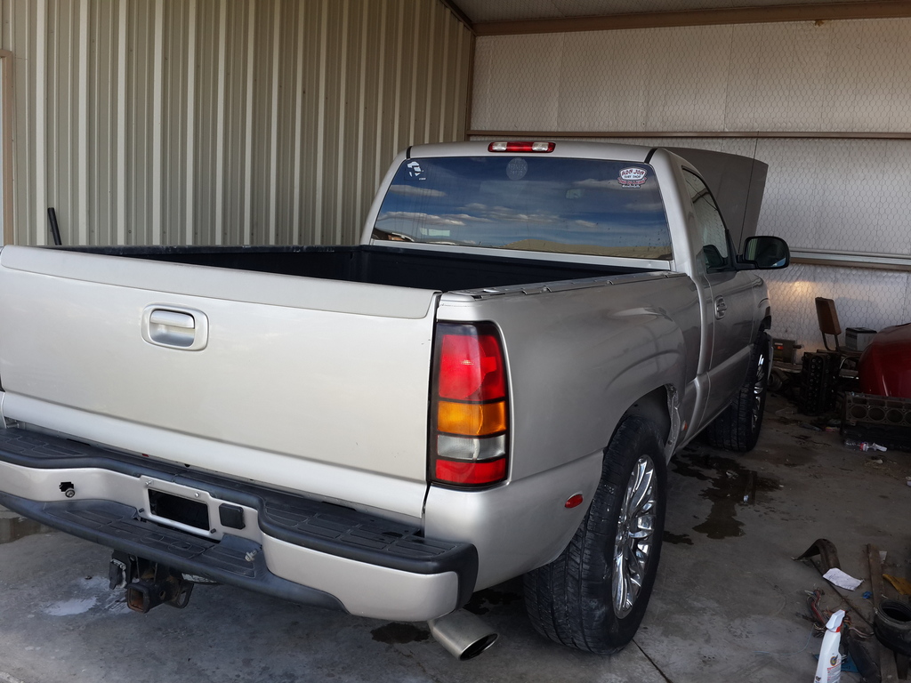

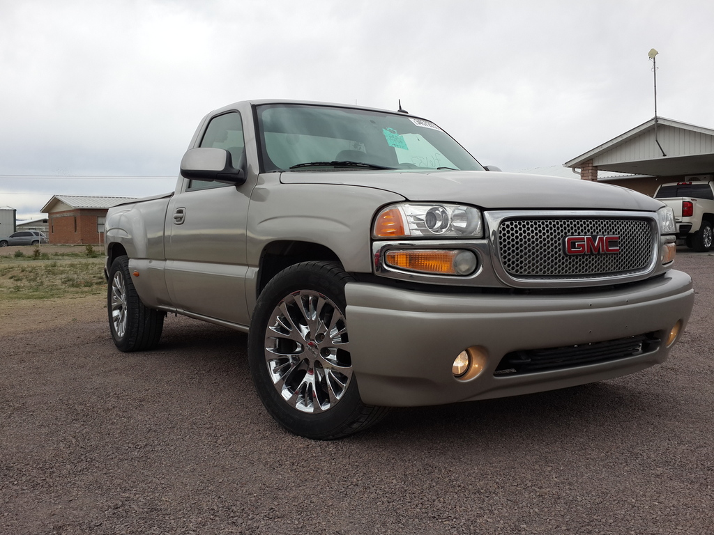

Exterior
I wanna get it done this week so when its done im gonna put some more pics up

Awesome build tire size looks pretty beefy, what's exactly does a 6.0 to ls3 conversion consists of besides bigger Pistons
Old Apr 10, 2015 | 02:03 PM
  #60
denalircsb's Avatar
Joined: Jan 2014
Posts: 78
From: Nanton AB
Thanks!!
You'll also need to change the heads and intake and thats it if you build it off a 6.0.
