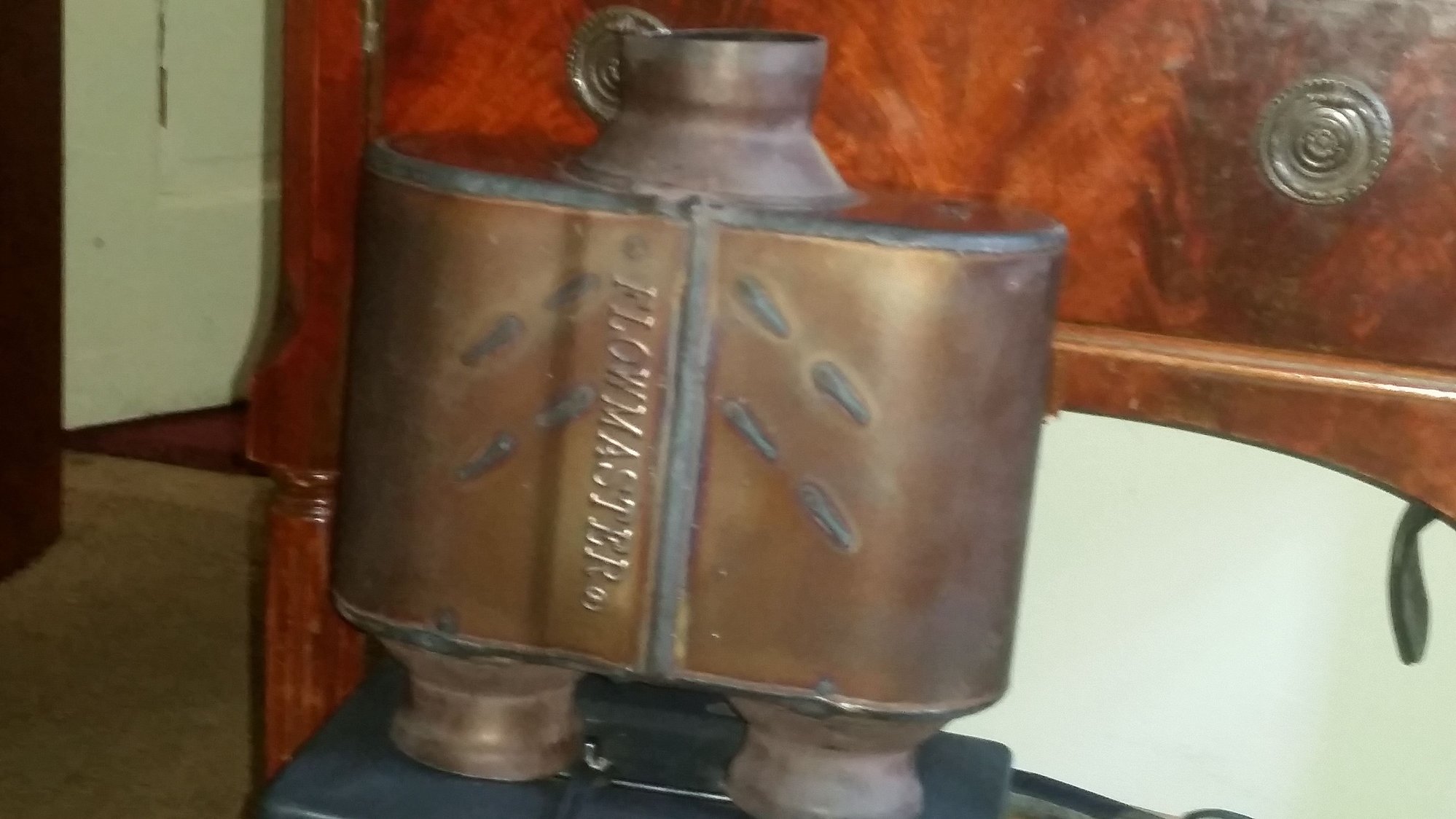

Old Aug 12, 2016 | 04:40 PM
  #60
X_Racing1's Avatar
Joined: Sep 2014
Posts: 312
From: Southern Colorado
Also picked this up today for 10 bucks. I'm going to do a lighting style exhaust dumping in front of the rear right side tire.
