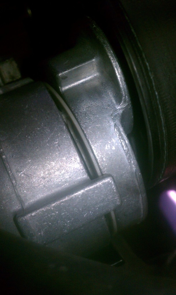

Here's the tensioner looking from the passenger side.

My belt is about 115". Can't go any smaller. There's only about 1/8 turn on the tensioner

Thats weird, I am running a size smaller then the number I gave you, it was tight but went on. I am running the same belt I had when I had my p1, with a 3.5 or 6 pulley. But i did reconfigure my idlers( old style bracket) Still 3'' diff.

I have the redesigned bracket. And a 130a alternator.
