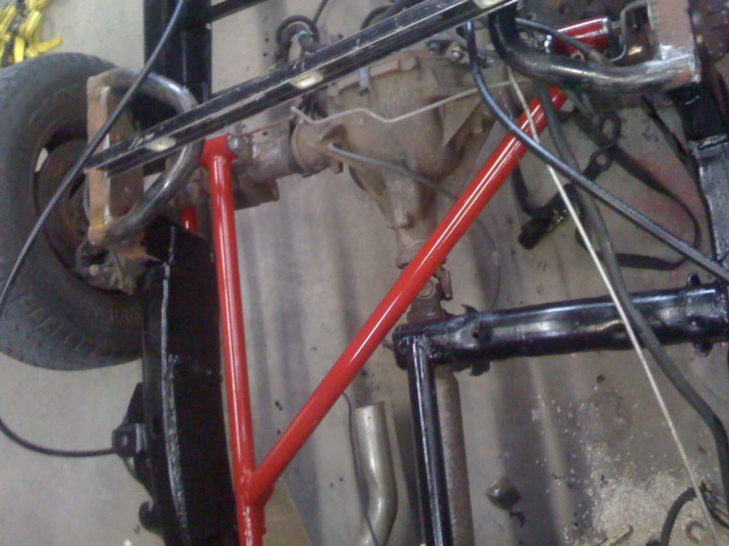

On a side note I was just thinking....
that crossmember that the rear of the gas tank hangs from is directly in the way of the top bar for the torque arm. I think its so bad that notching it is not really gonna help. Its gonna have to come out. Now how do you retain the factory tank and basically remove the right half of that crossmember???

Could you just c notch that bar? IMO if you cut about a half circle out of it then use a nice piece of pipe cut in half to "box" it in, i think the strength will still be there.
Dustin

Here's a wishbone setup that removes half of the gas tank crossmember. Looks like it'd work for you. I'm not sure where that brace that runs parallel to the driveshaft connects to though.
Come on guys, are you trying to talk me out of the alternate route? lol!
