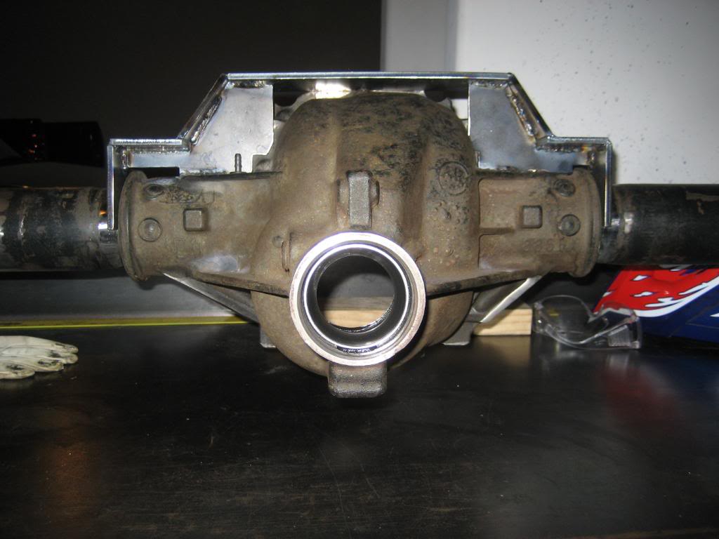

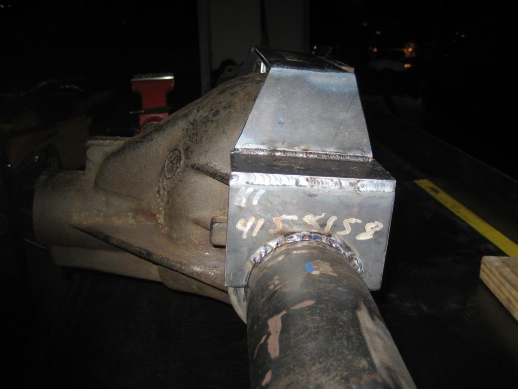

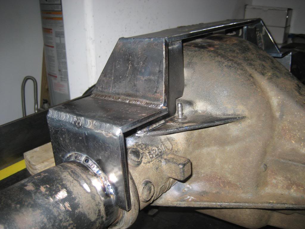

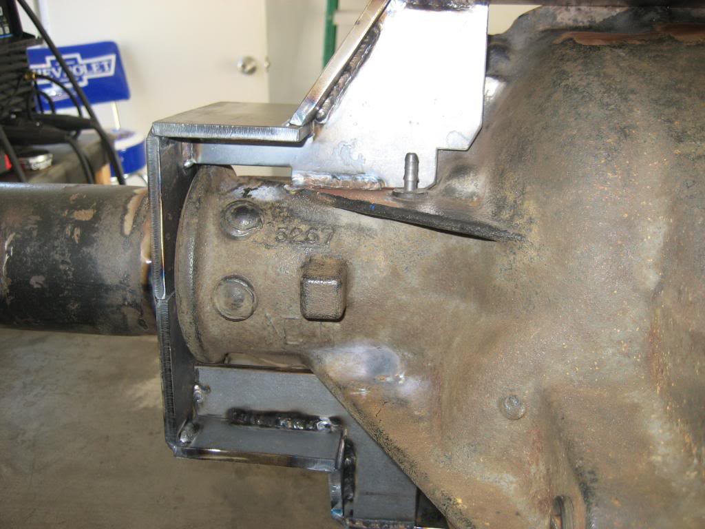

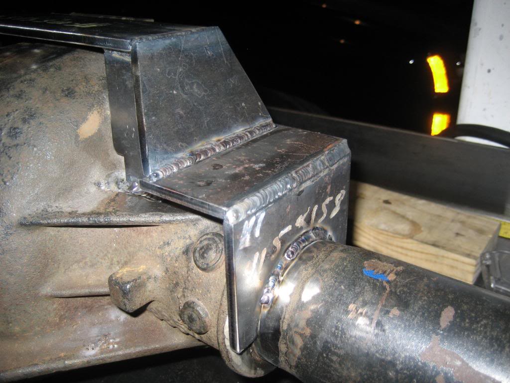

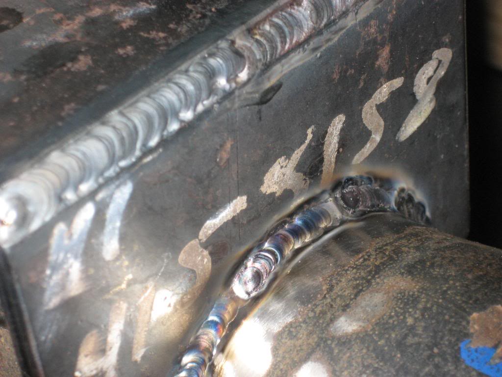

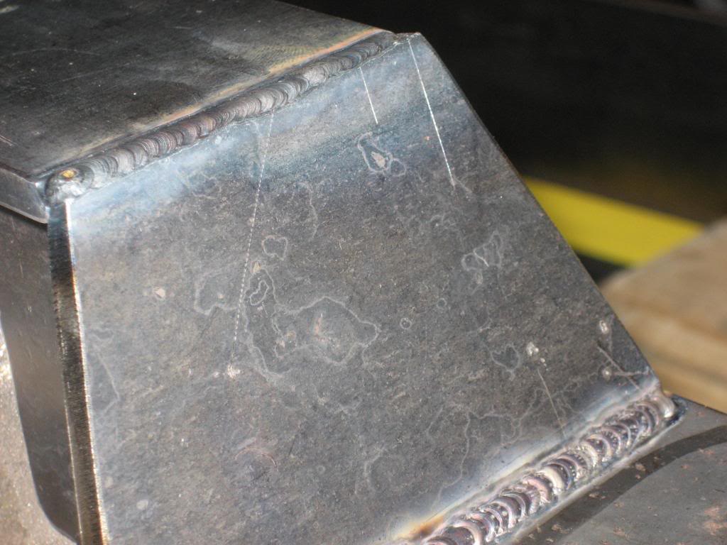

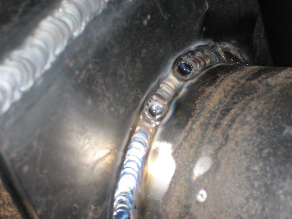

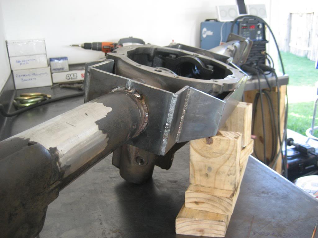

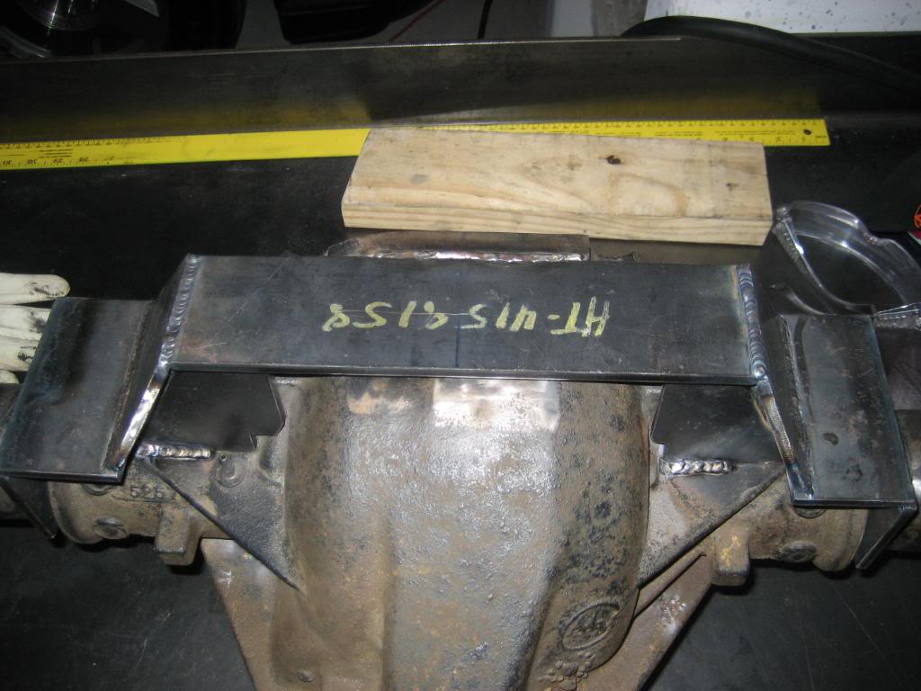

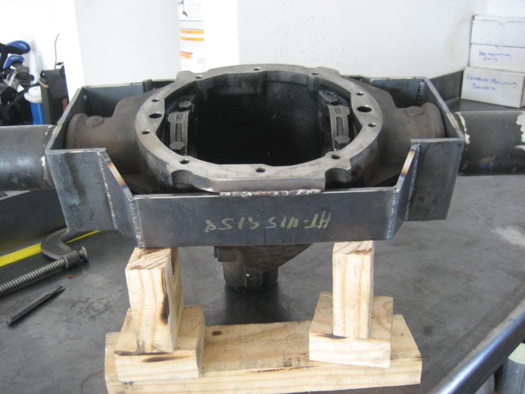

Finished upper housing brace welded on for good:

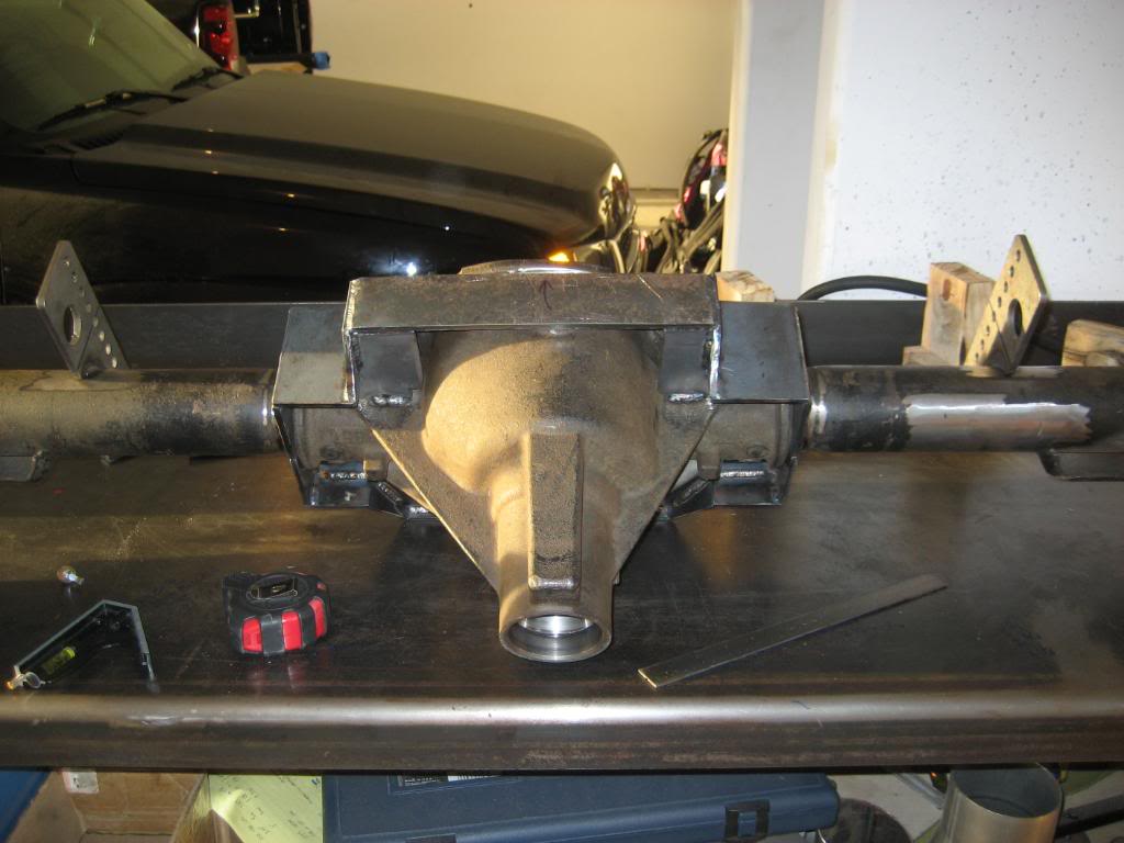

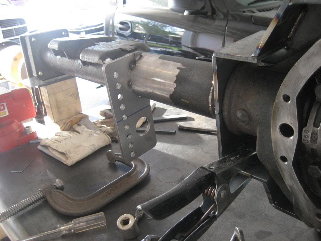

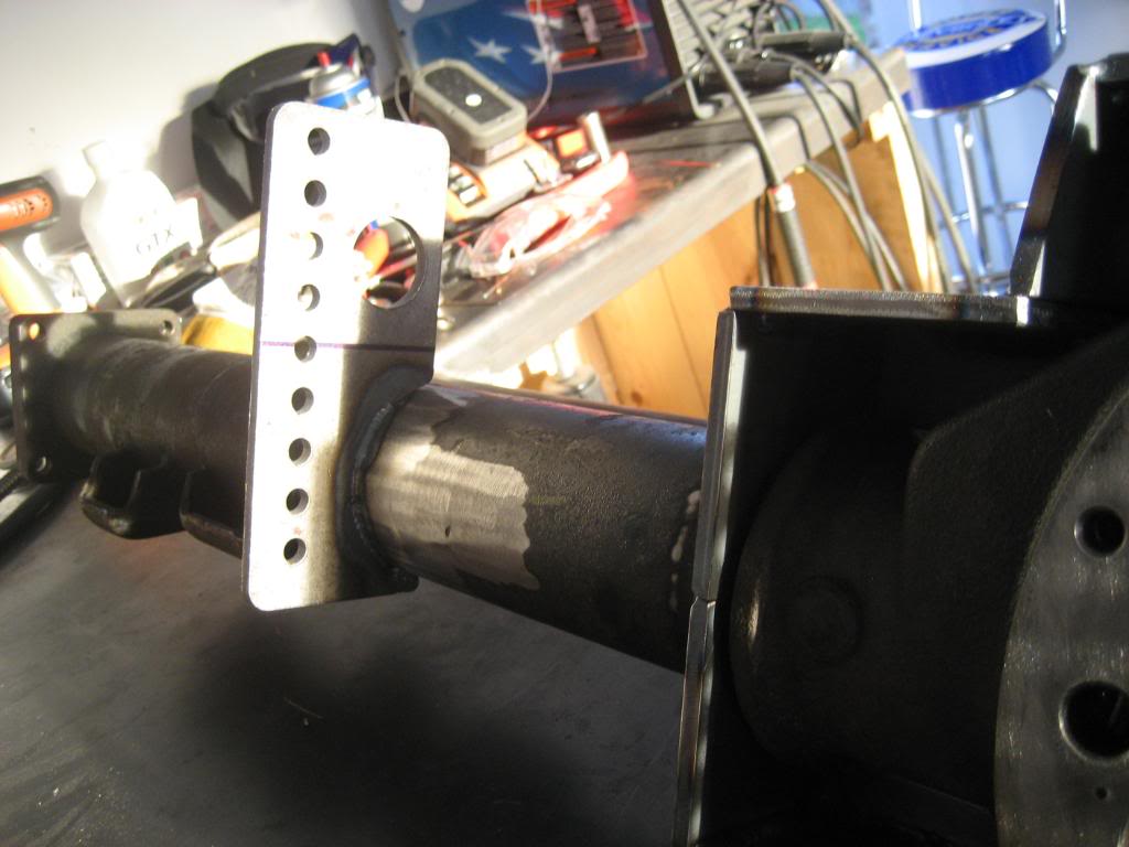

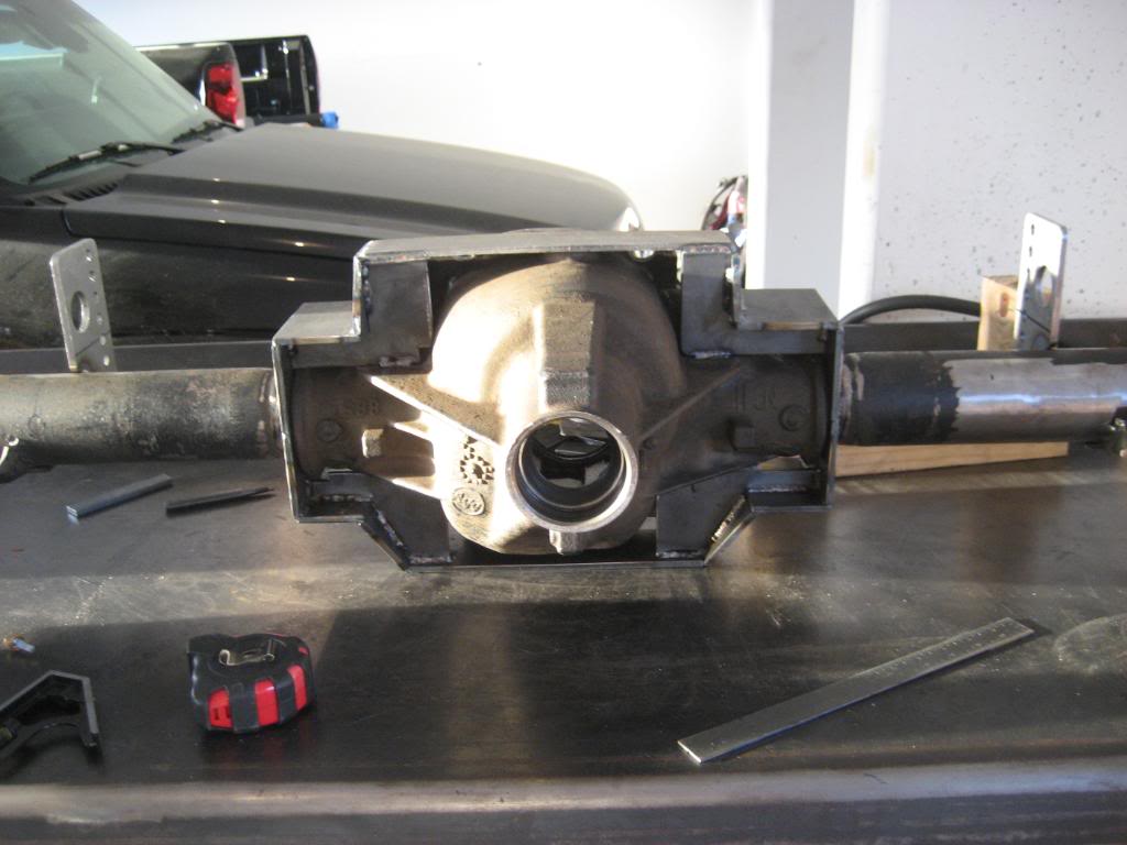

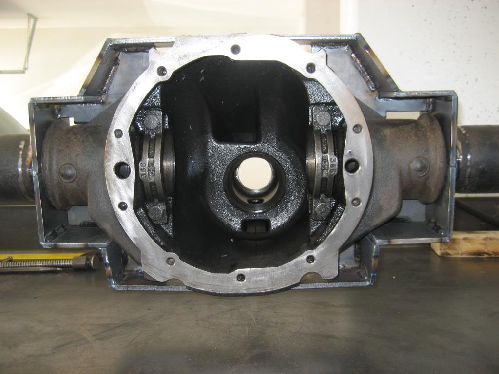

Finished housing brace w/o tabs for the rod end mounts:

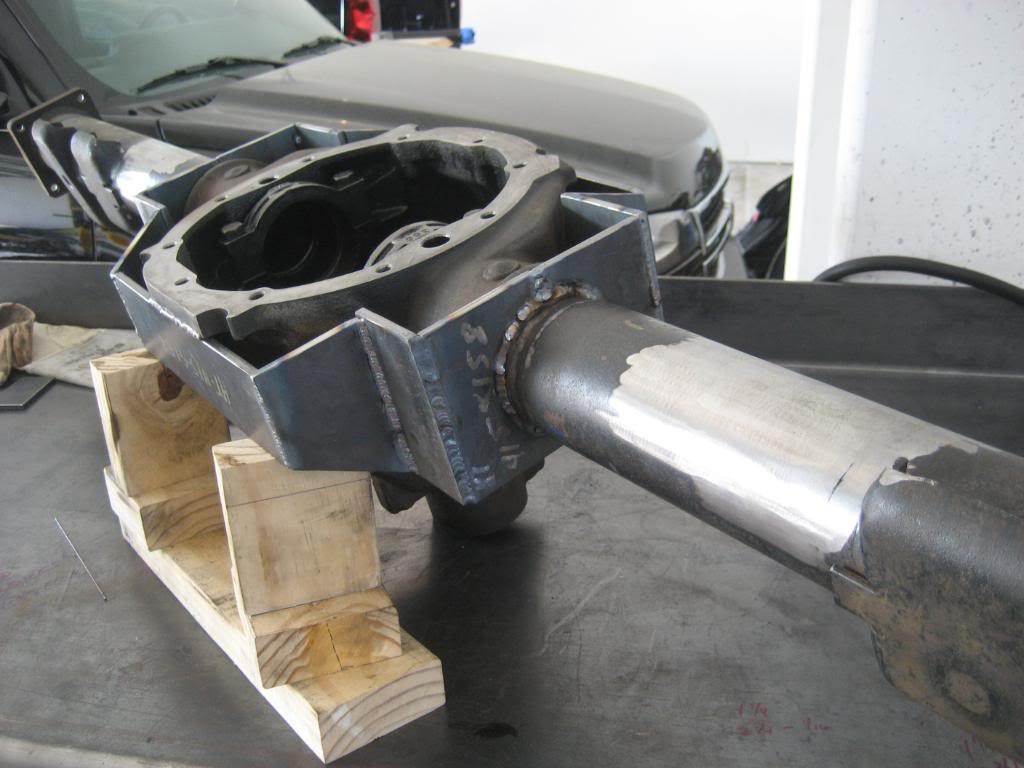

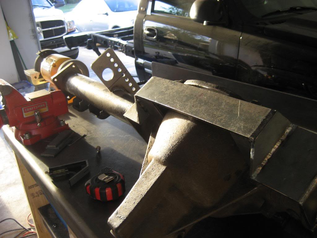

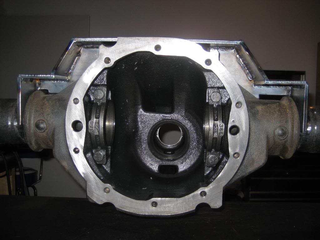

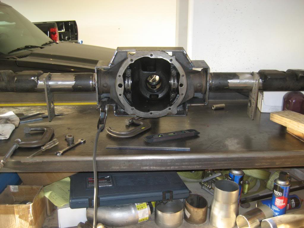

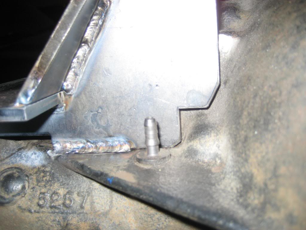

...and the new lower shock mounts and more pics of the complete housing:

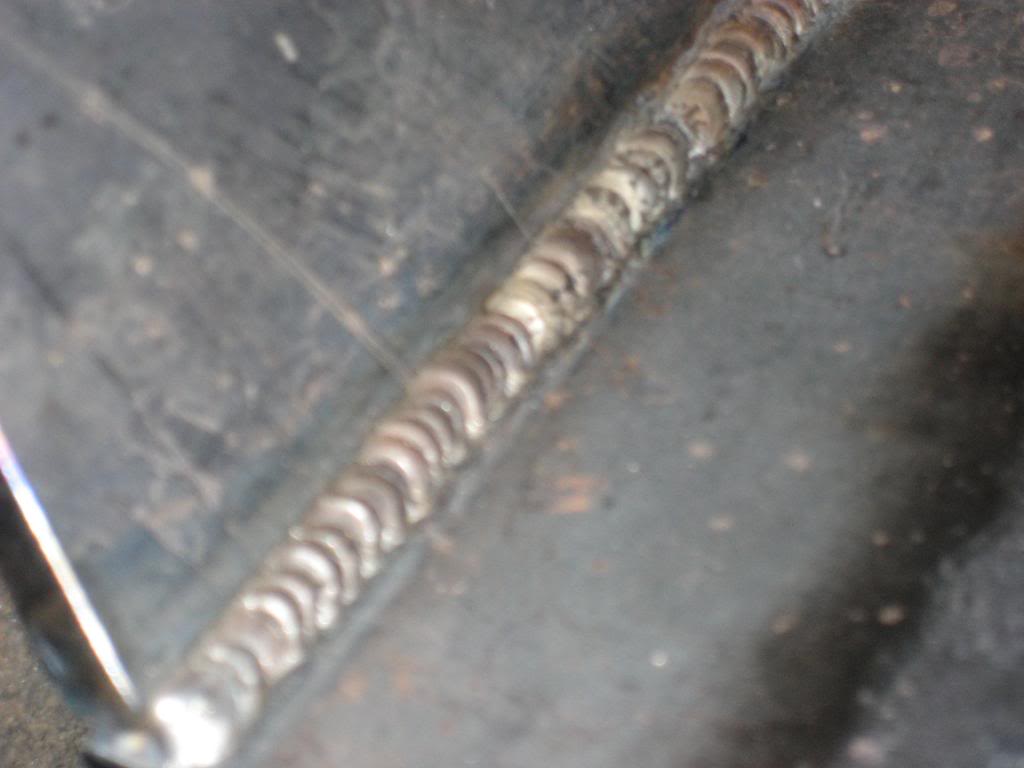

Now ya'll take it easy on my tig welding skills, I have less than 1 hour of arc time under my belt.

the welds look better then i could do lol that torque arm is going to be one nice peace when done

Ok man I was just curious, mine is ran all the way to the back, it is bad(the rapp-crack), just was wondering how a bigger case muffler would sound.. I am willing to bet there is no crack if you dump it a lil after the muff.. BTW your tig work looks good, you have the machine set damn good, it took me a long time to get the feel of a tig, so I say *** it and mig alot of my stuff... Good looking build you have...

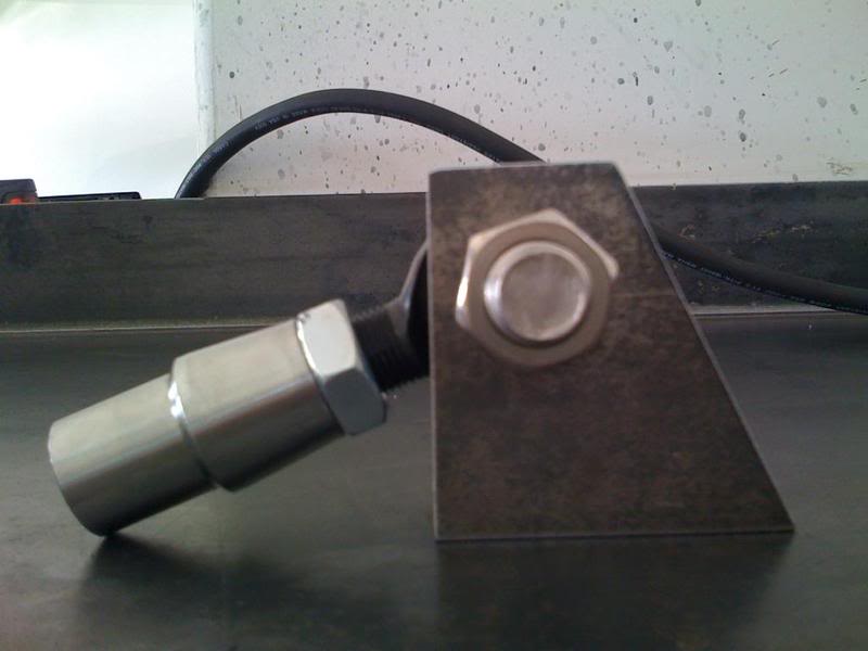

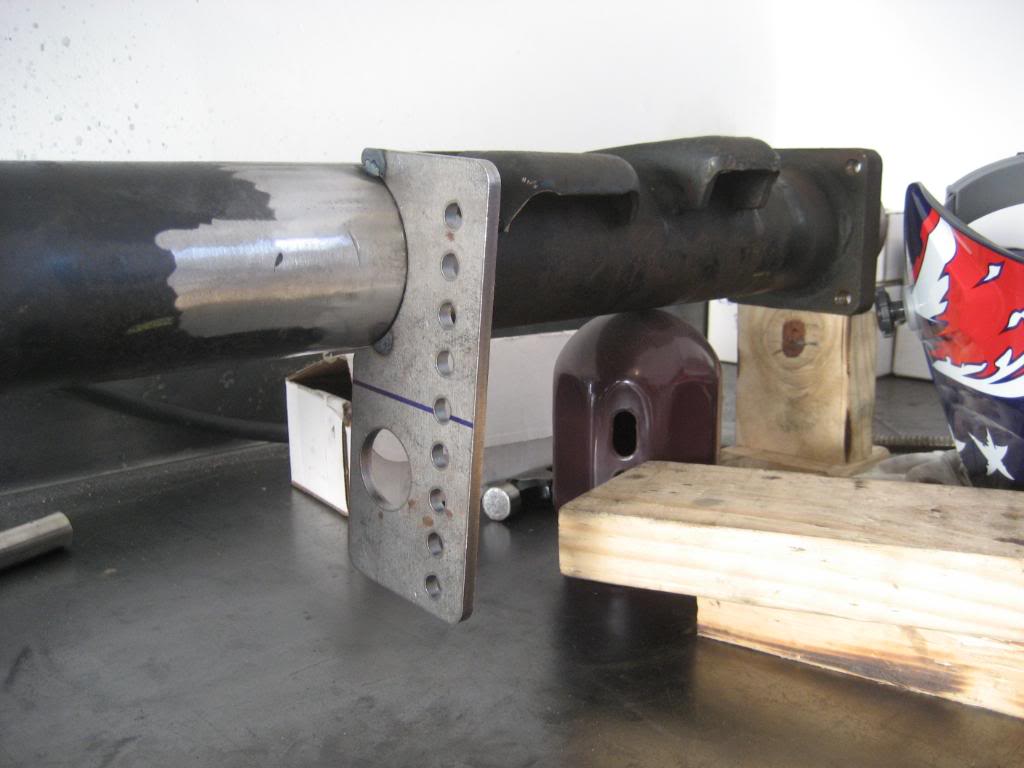

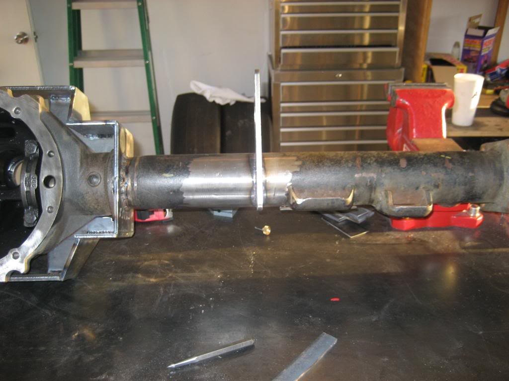

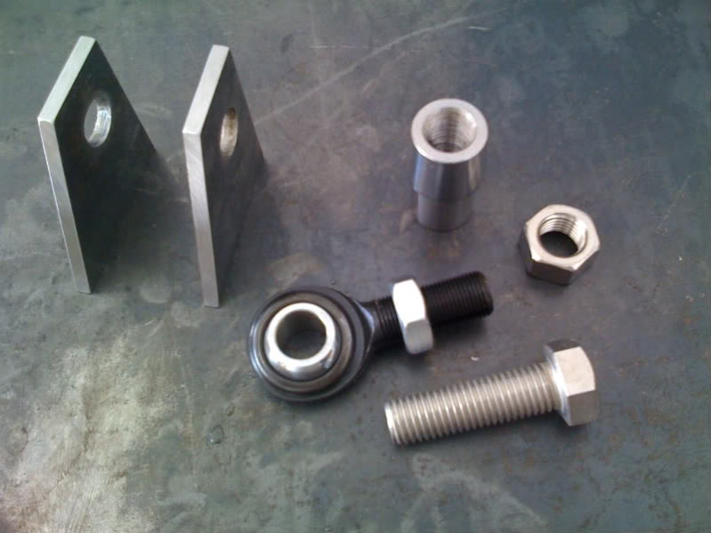

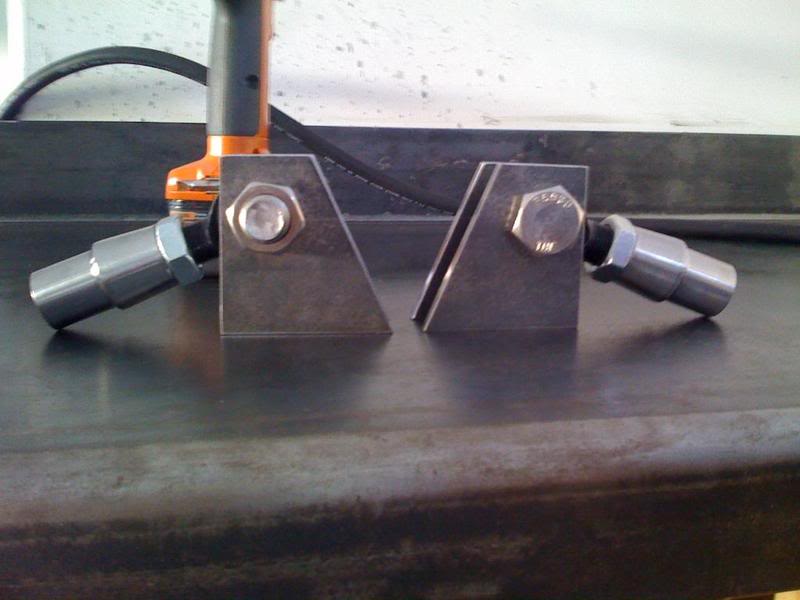

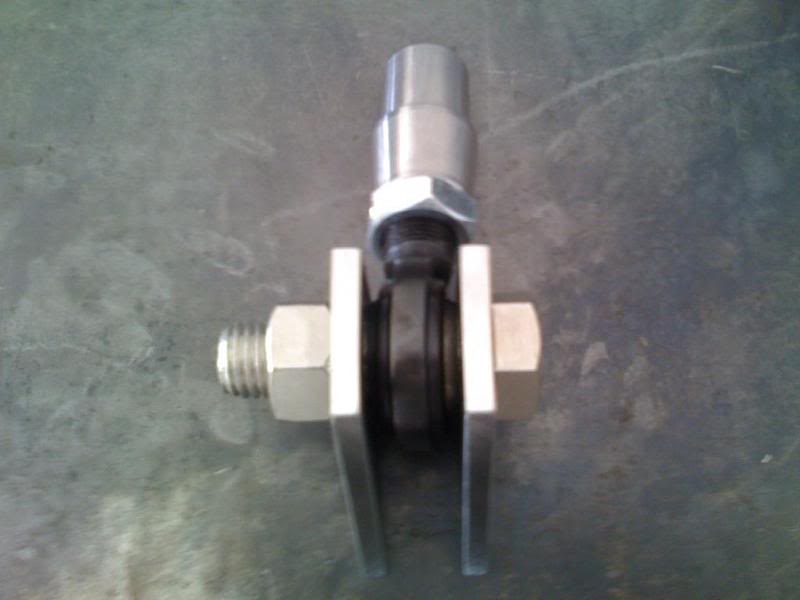

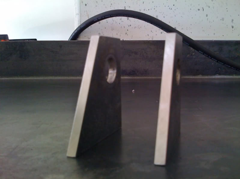

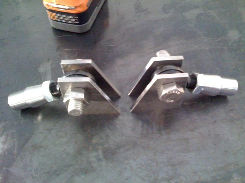

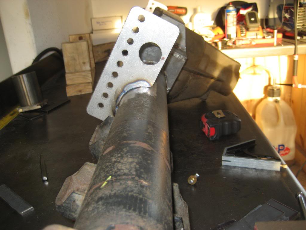

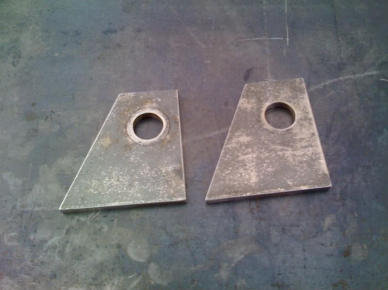

I made a little progress today. Got the torque arm brackets cut. I should be able to get them welded on to the housing tomorrow and get the rearend back in the truck so I can get started on the upper shock mounts. BTW these are 3/4" chromemoly rod ends. Here are some pics...
