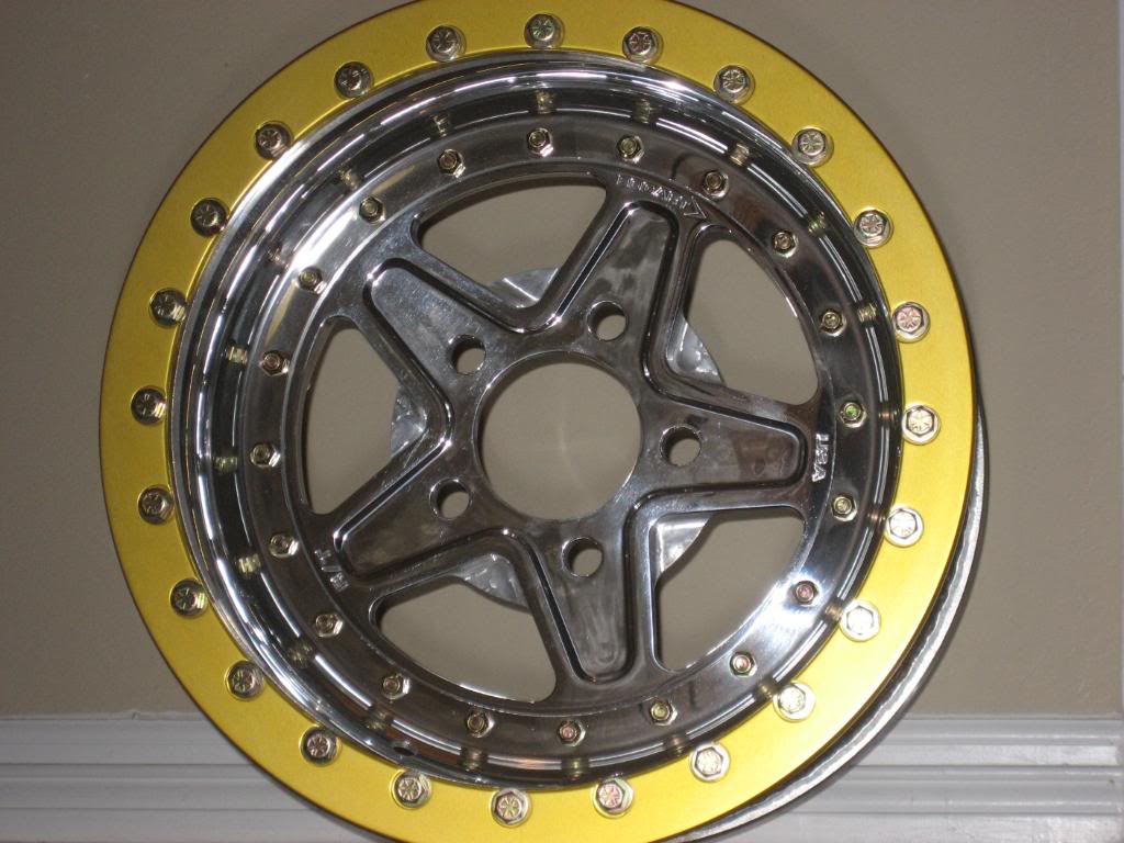

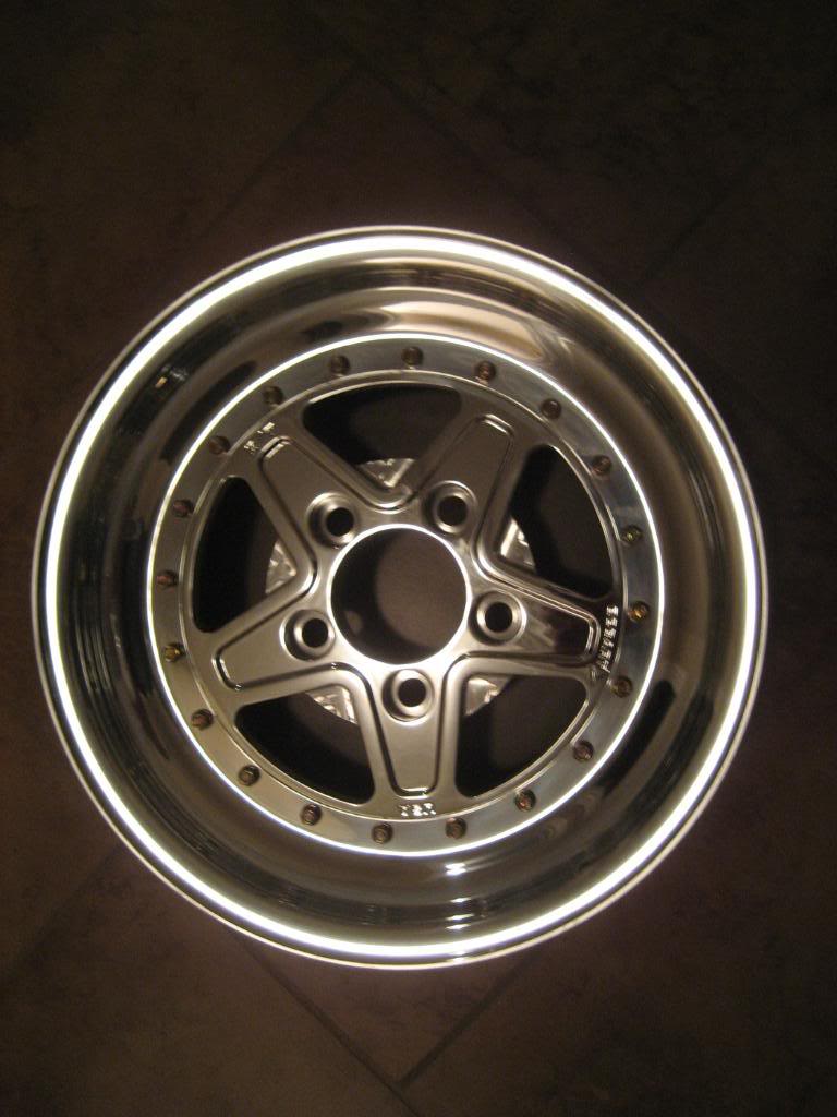

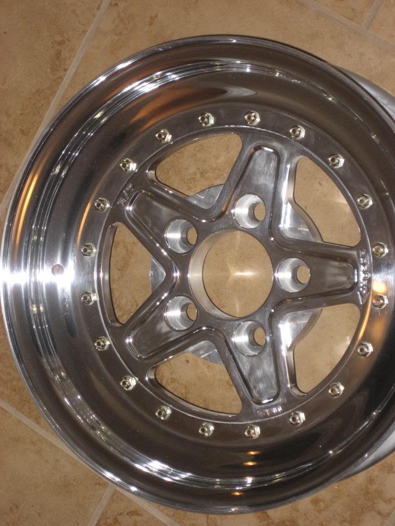

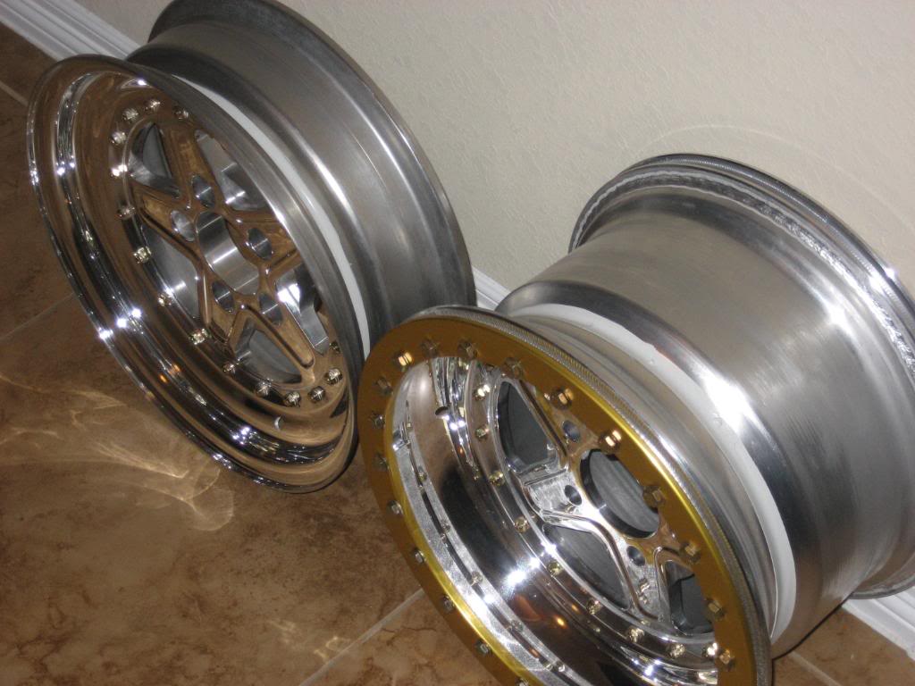

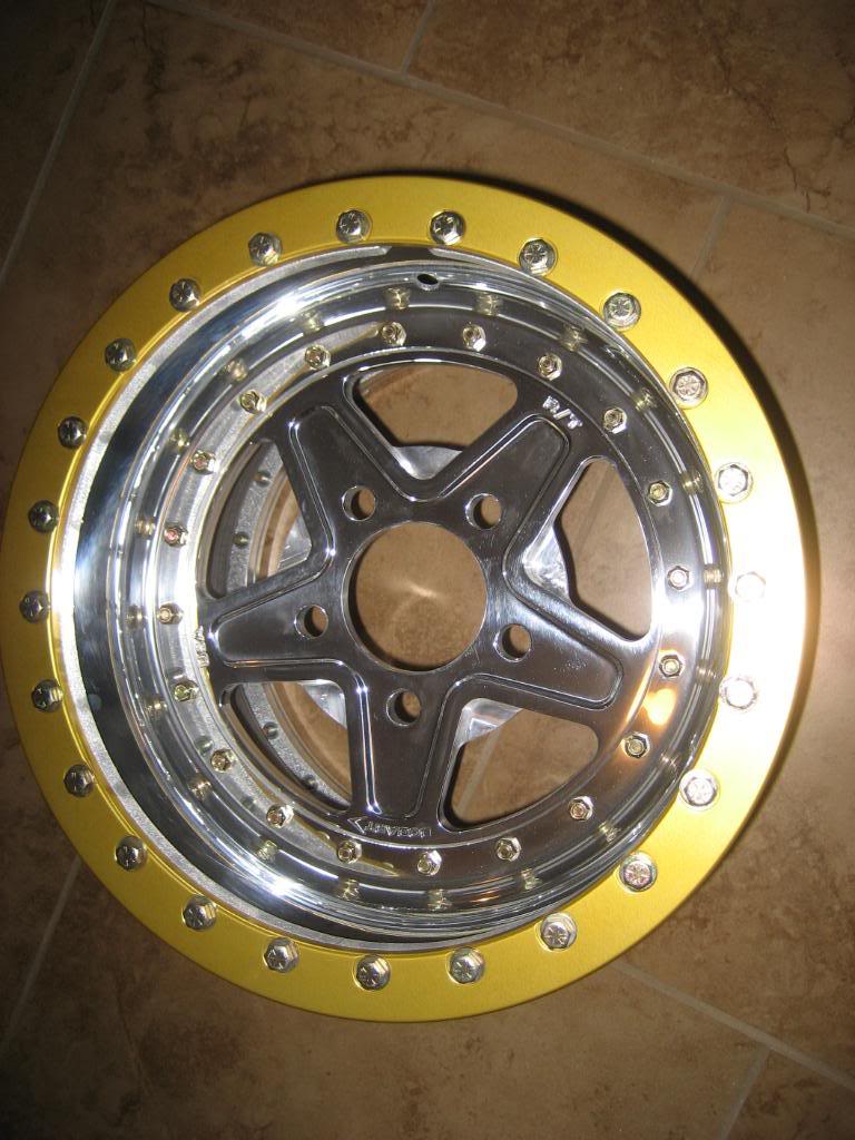

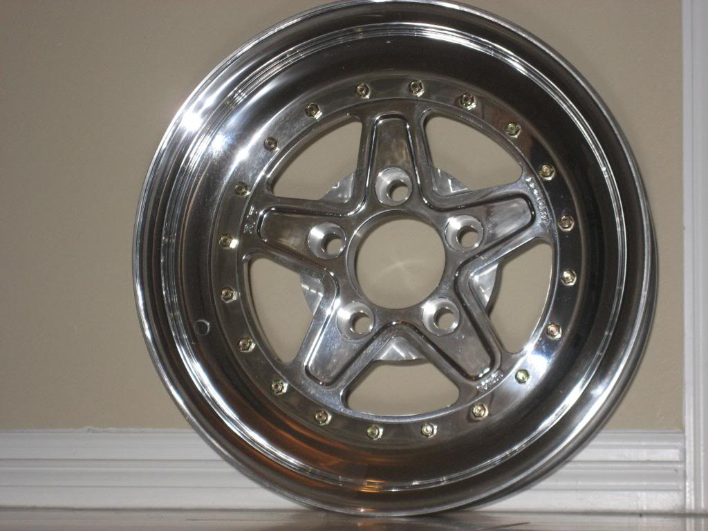

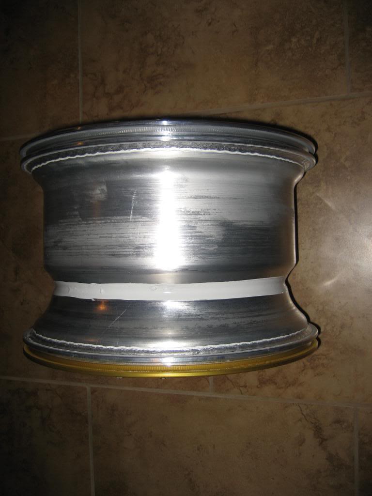

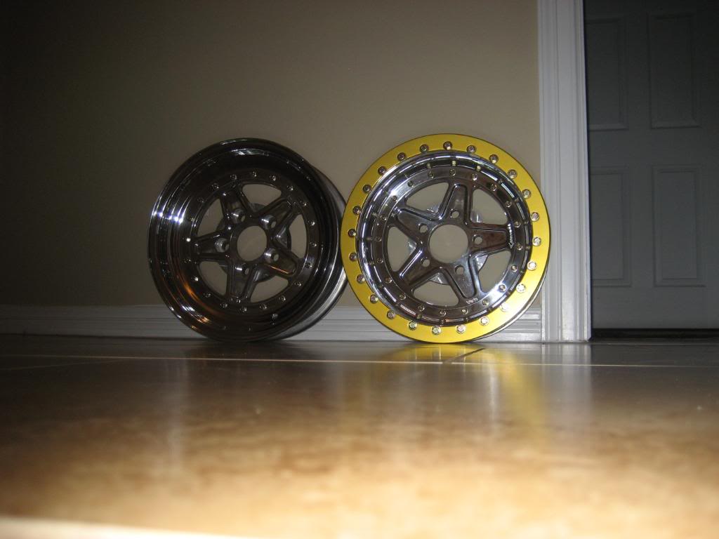

Bogarts came today.
Rears are 15x10 bolted R/T's with double bead locks.
Front are 15x4.75 bolted R/T's.

those are some very nice wheels there going to look badass did'nt know they made a double beadlock def wont get any rim spin thats for sure have you sent out the axles and hubs to get redrilled? if so which bolt patern you going to run im guessing 5x4 3/4

Those rims look very good!! What backspacing did you go with?
They will do a single or double beadlock on any of there rear wheels I think. Just costs a little more. Axles, Hubs, brakes sent out yesterday. You are correct 5x4.75 pattern.
6-1/2 rear, 2-1/4 front

I edited my post with the backspacing info. I had my wife measure them while I was out of town and she messed up a bit. The backspace is actually 6.5 on the rear and 2.25 on the front. Which is a bit strange because I thought that Rich and I agreed on 7" in the back. I'm gonna fit some tires up and see what it looks like. I want the rears to tuck completely so if there is room to go further, I'll send them back.
One other problem I ran into today. Moser called and said that they can't do my front hubs in 5x4-3/4 bolt pattern. Something about them not being able to weld the existing holes up and be able to machine the hub back flat on the back side because the bearing housing is in the way. I told them that there were numerous people on here that have had them done by moser (I'm assuming this is right) and I didn't understand why my hubs were a problem. They asked me for names so they could pull some invoices but I don't know any of your names. If anyone reading this has had their hubs done by moser please pm with your name and an invoice number if you have it. They said they would have their shop foreman call me on tuesday, but they are acting like it can't be done. WTF!
