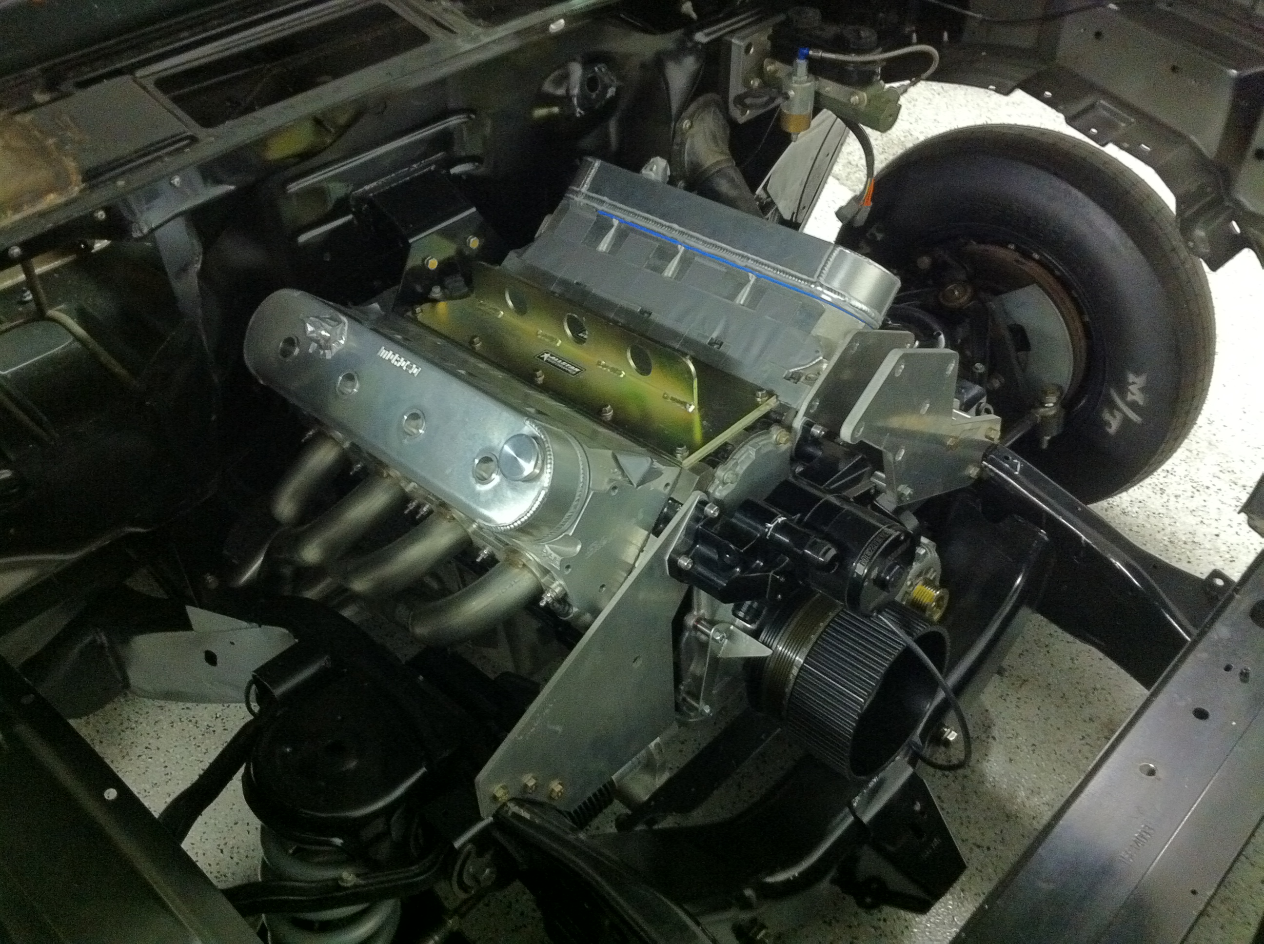

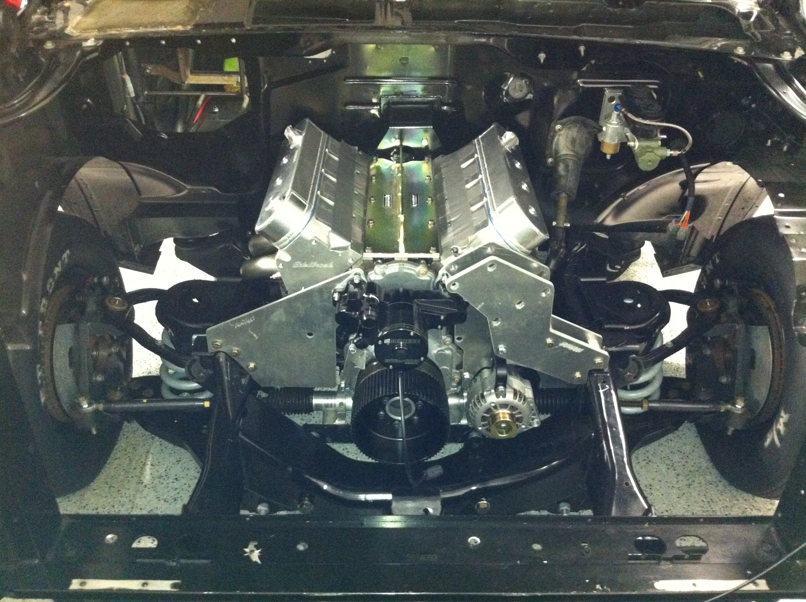

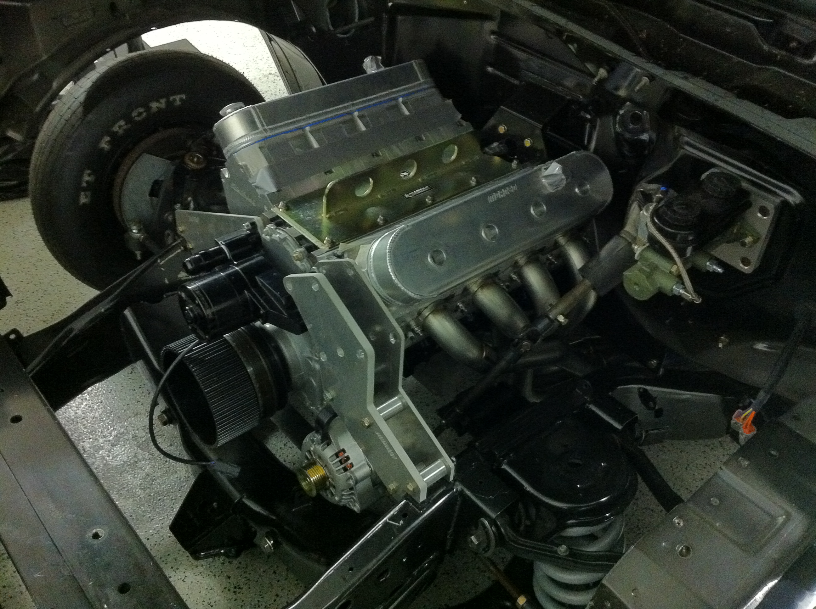

Thanks for the compliments guys. Finally making some progress and I'm fired up.
Yes they are some old *** edelbrocks I bought from spoolin on here. They flow insane amounts of air on the flow bench.
I pulled the motor back out today and fixed a few things. I had to "clearance" the alternator a little and move the rack back about .450" so the alternator would fit. I also had to cut a hole in the mid-plate for the cam sensor plug.
Put the motor back in with the alternator mounted and threw the headers on it. I can't stop taking pics of this thing.
