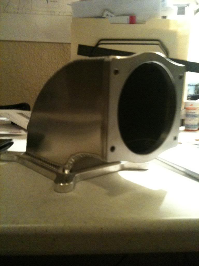

Obtaining this elbow was not pleasant. Long story but it's hear and looks great. Thanks Aarron.

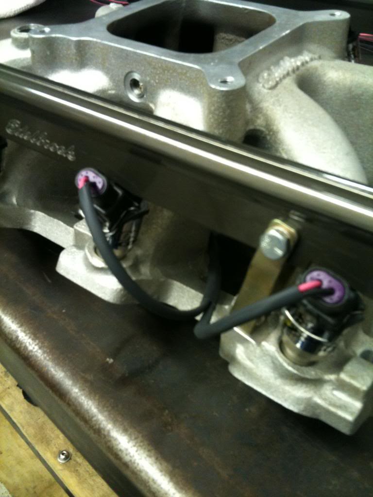

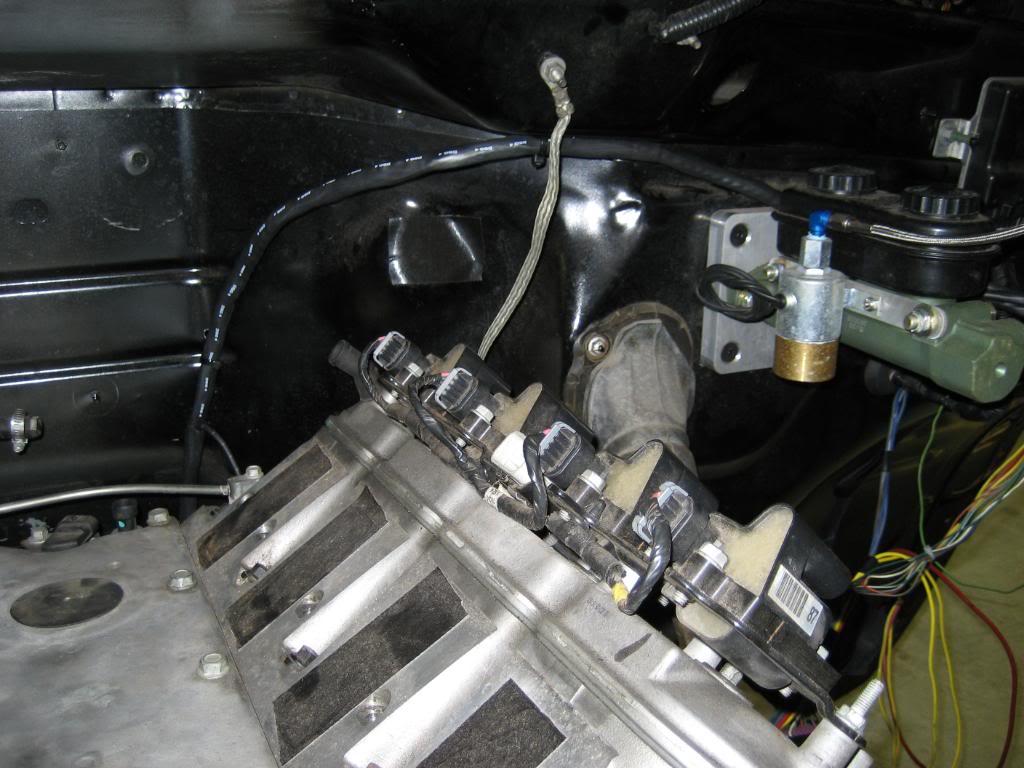

Started on the injector harness...

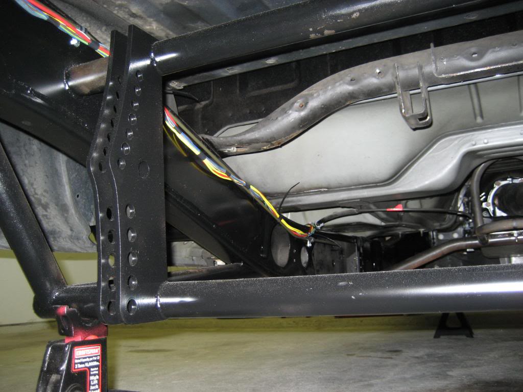

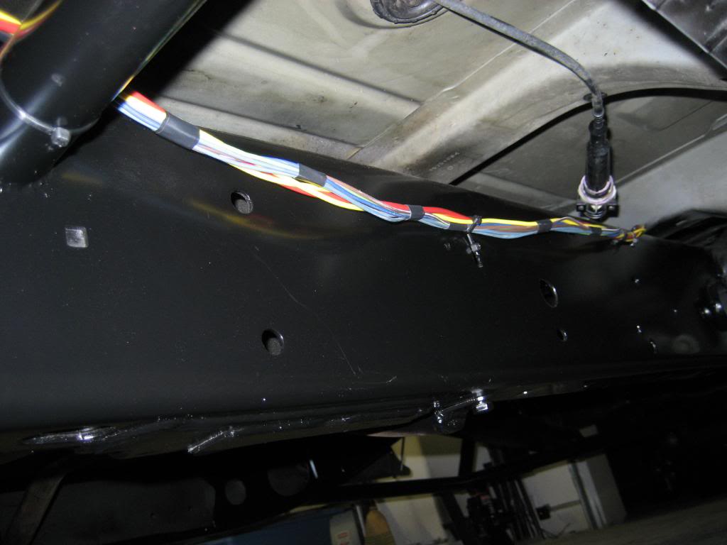

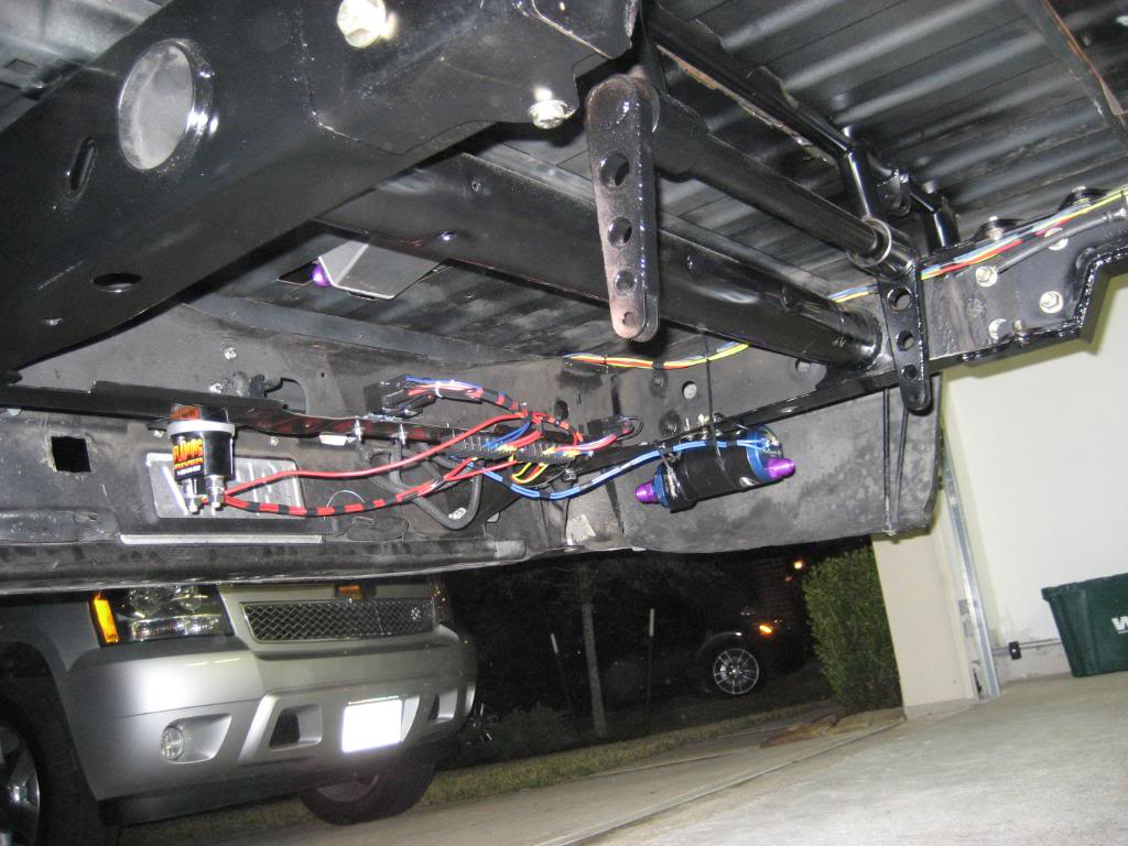

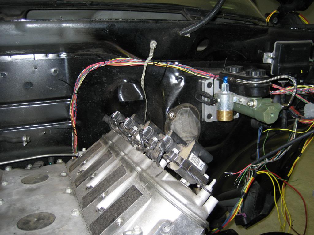

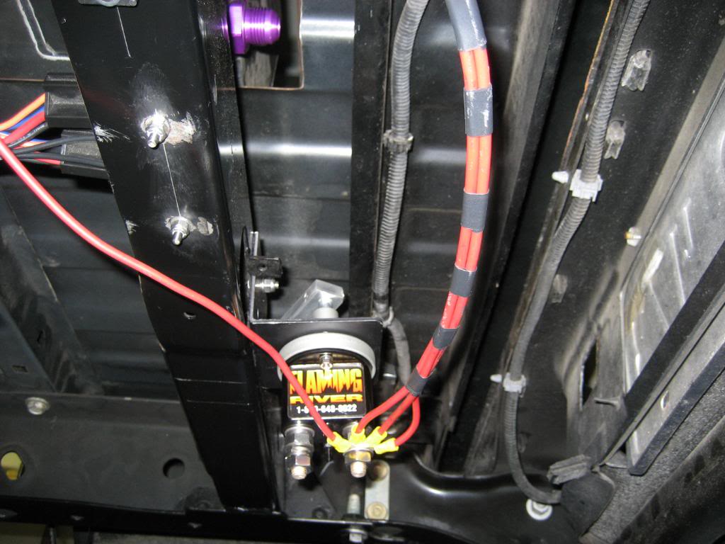

Got all the wiring laid out for the rear of the truck. It will all be heatshrinked for looks and protection, but thats a project for when I've got it back running and making sure everything is gonna work.

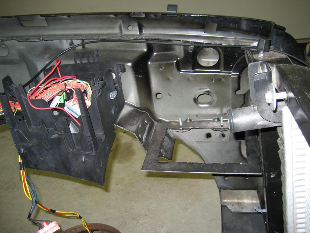

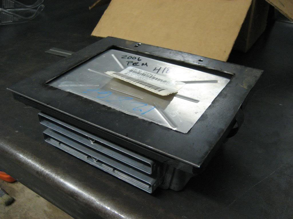

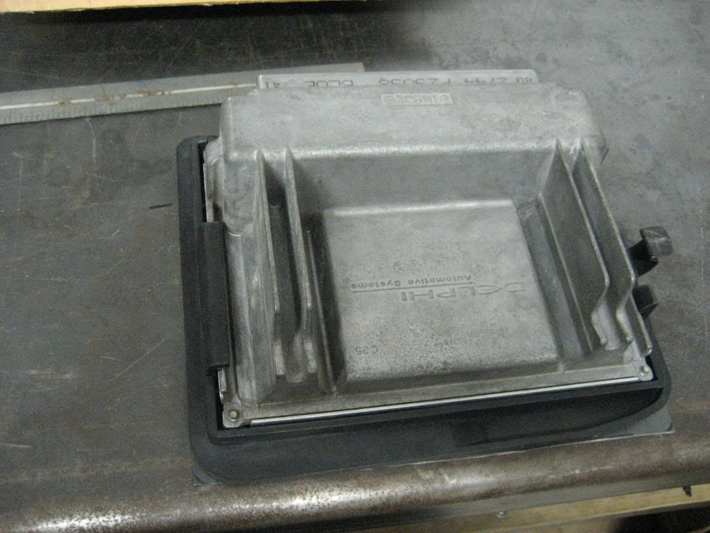

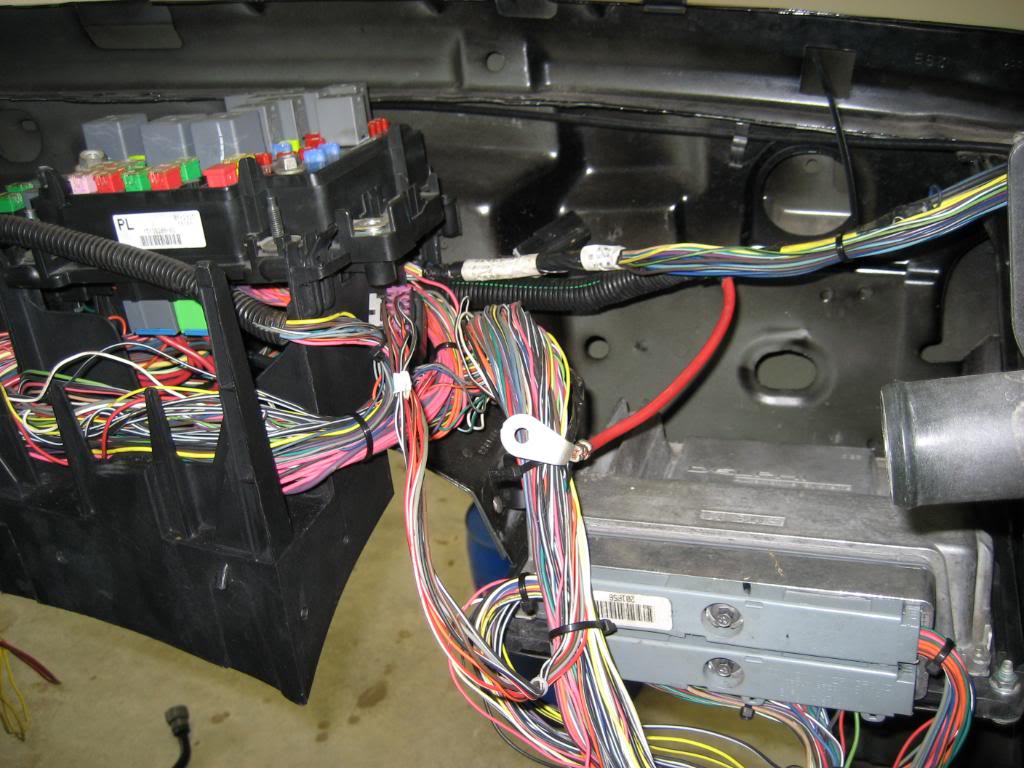

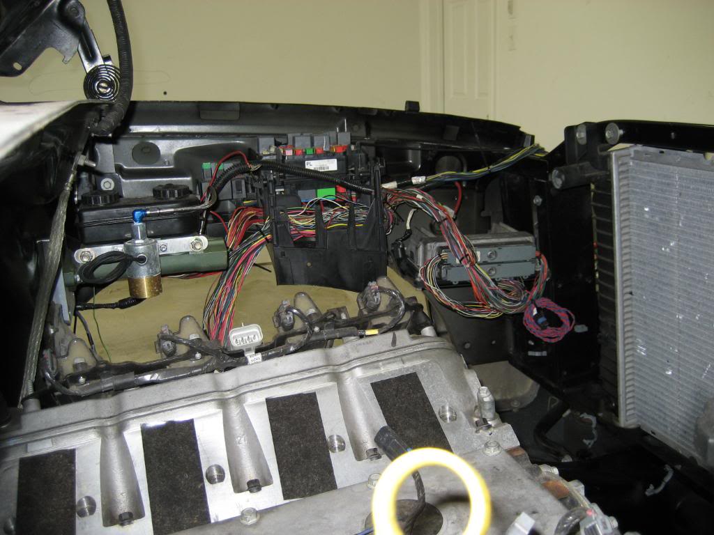

Next up was trying to decide where and how to mount the pcm. Decided to mount it where the battery used to be. I cut the back side out of the stock pcm bracket so that it was flat and cut a piece of steet for a backing plate to help stiffin it up. It acually went together easy and looks good too.

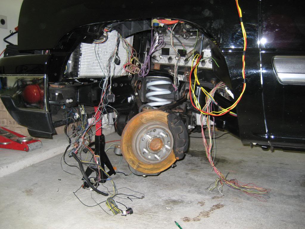

Got a wiring nightmare on elm street

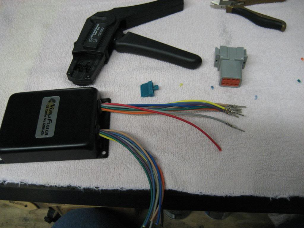

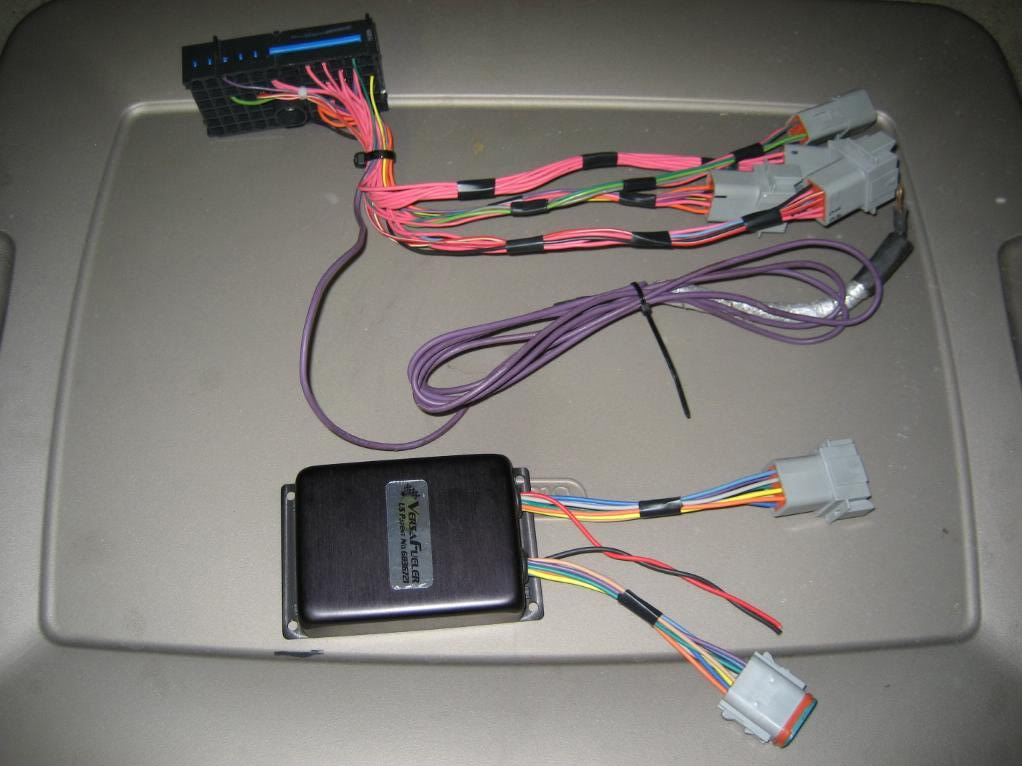

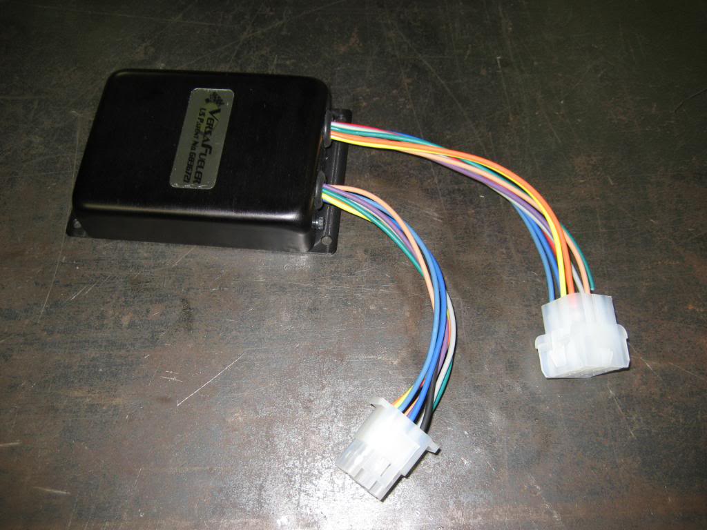

My new versafueler came back this week and this has some cheap shitty multi pin clips on it so I decided to fix that with some of my own.
Here is the finshed versafueler and the simplified part of the engine harness that runs to the fuse box. This stuff will be heatshrinked on final fitment.

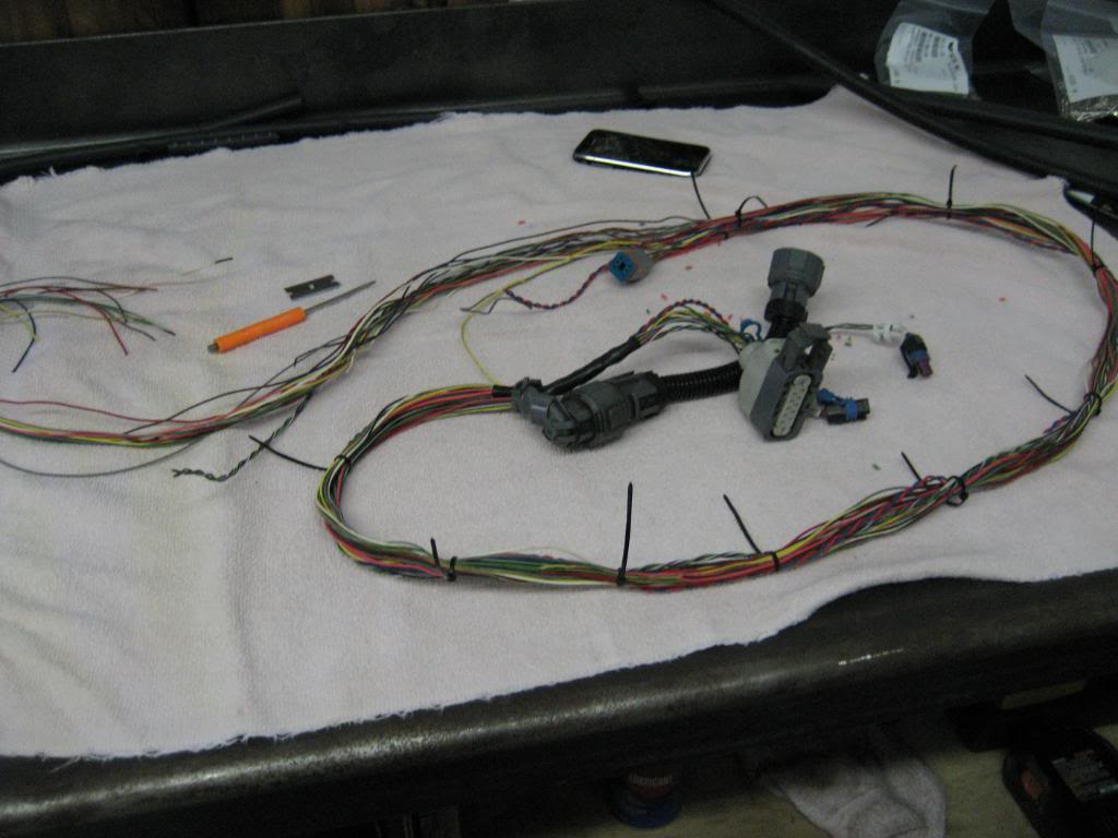

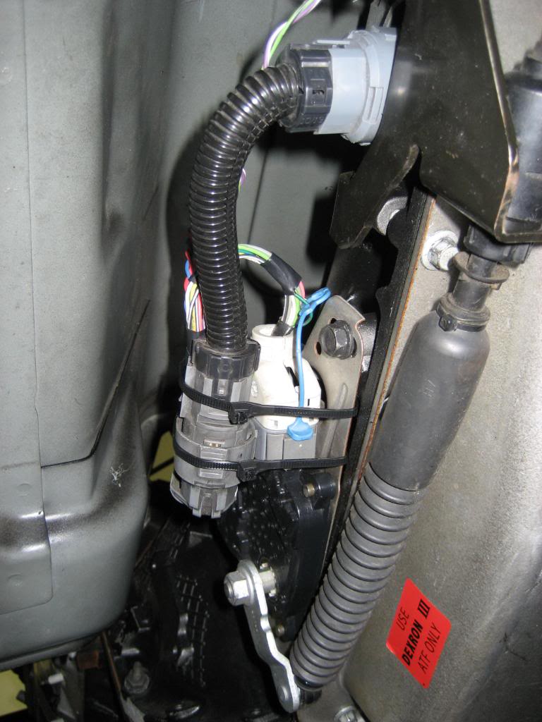

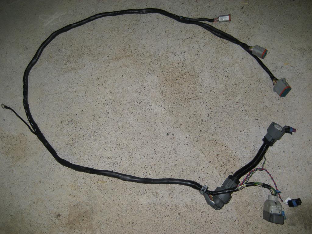

Next I moved on to the trans harness. You can see I dummied it up the fire wall and over making sure it would fit, then I took it appart heatshrinked it and added my multipin clips. Looks much better now.
