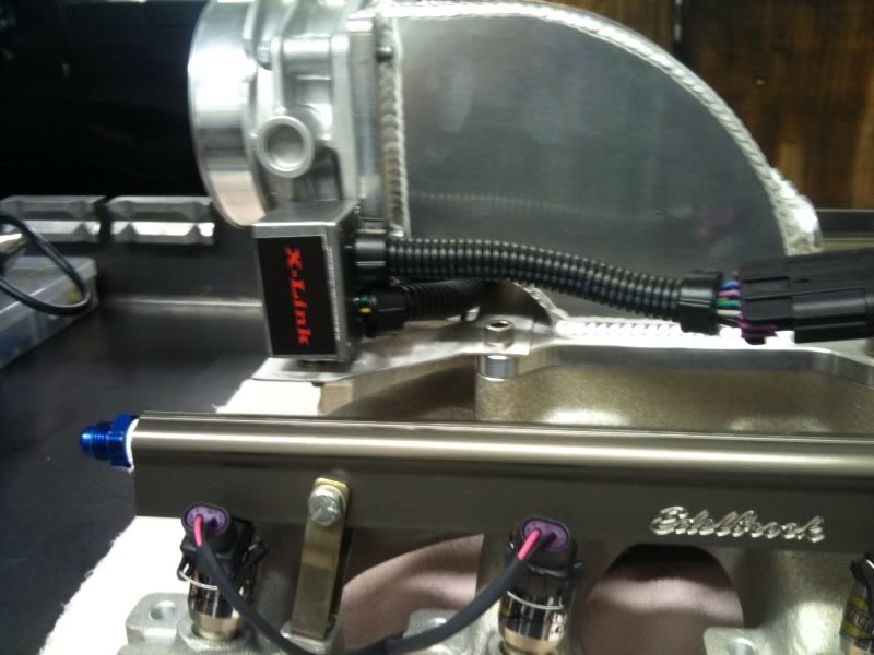

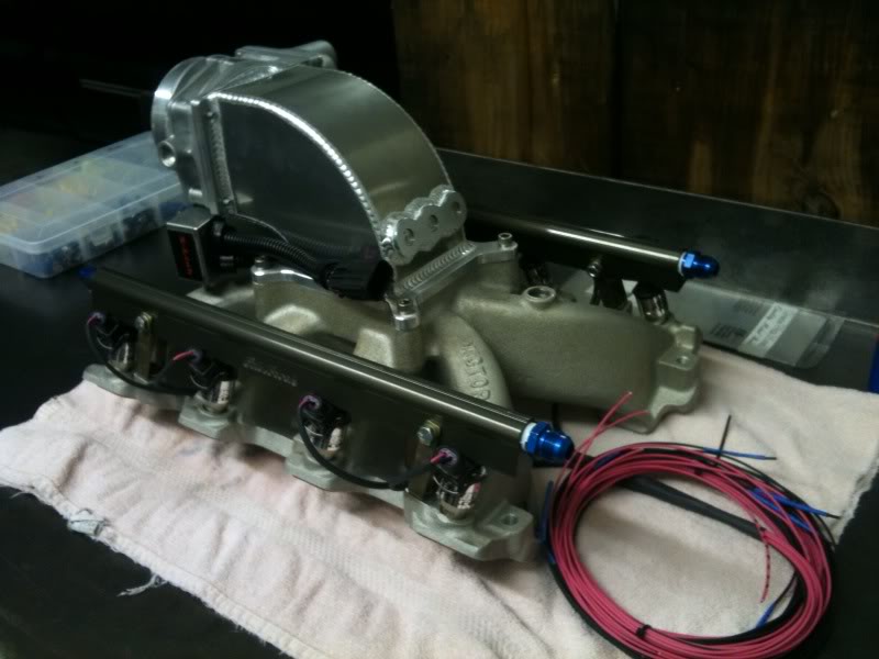

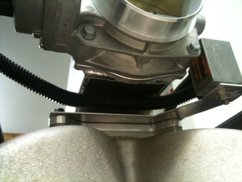

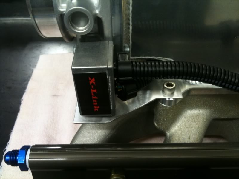

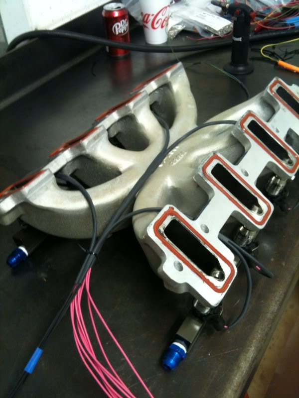

Here's some pics of the injector harness progress, and a bracket I made for the x-link...
