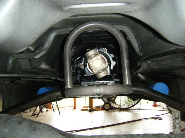

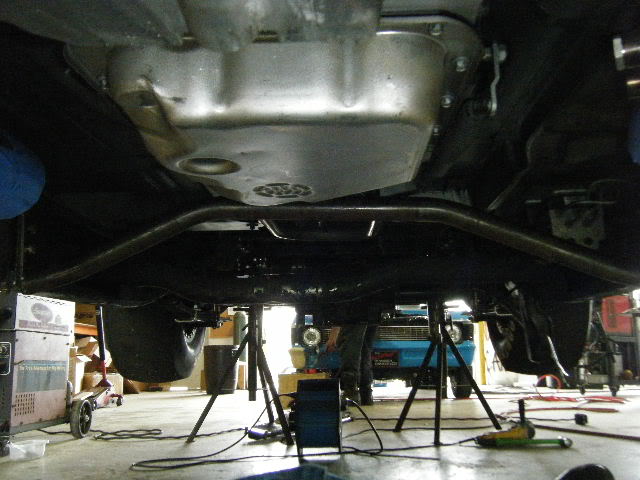

Got more pictures from the crew over at madman's. This is the new trans x-member. One of the main reasons I wanted them to do that was that I had a bad feeling that the motor was not in the truck level after I did the 4l80 conversion. Brian told me that had to lift the back of the motor about 3*. They also integrated a drive shaft safety loop. Looks like I gained some ground clearance and lost a little weight too.
Looks good guys, I appreciate the photo updates and excellent customer service.
