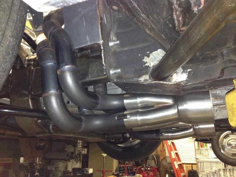

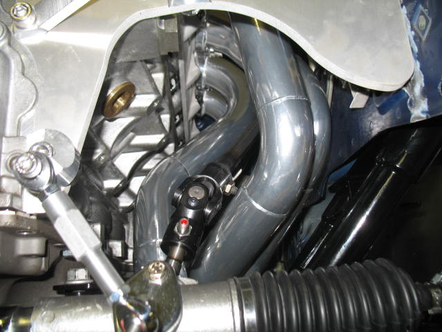

Split flange and slip on collector as in the link(more options for routing individual primaries around frame rails, steering shaft, etc) or all 1 piece like off the shelf headers?
Couple of examples:
Old Nov 21, 2016 | 02:21 AM
  #2178
Blown06's Avatar
8 Second Truck Club
iTrader: (32)
Joined: Apr 2006
Posts: 5,662
Likes: 47
The right side will likely be 1 piece. Not much in the way over there.
On the left I will have to deal with the steering stem. So I was maybe anticipating one or two tubes that will have to be separated.
I'll be using a double slip collector to make **** easier.
