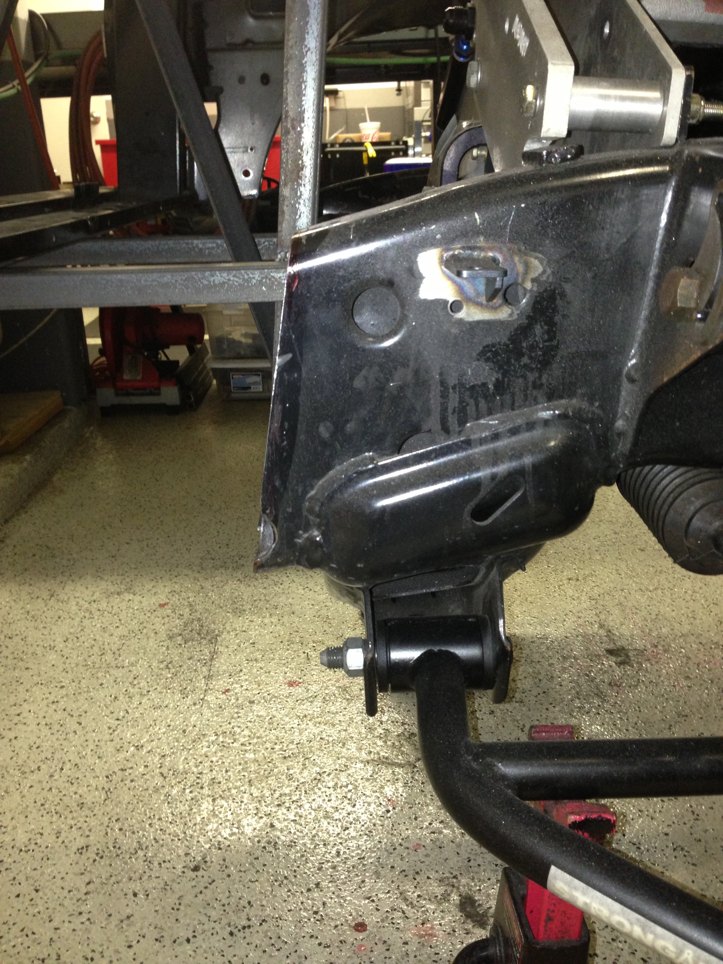

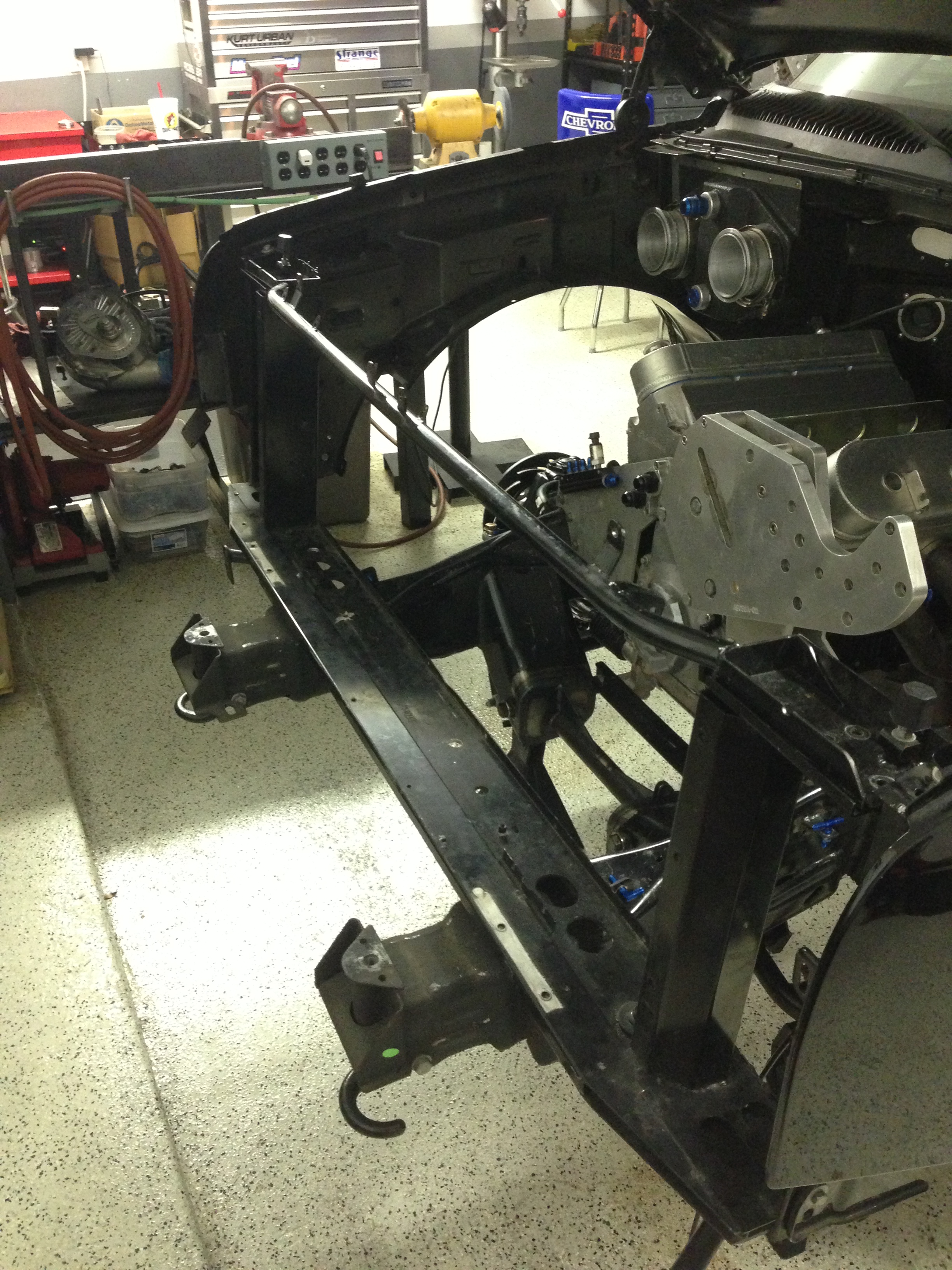

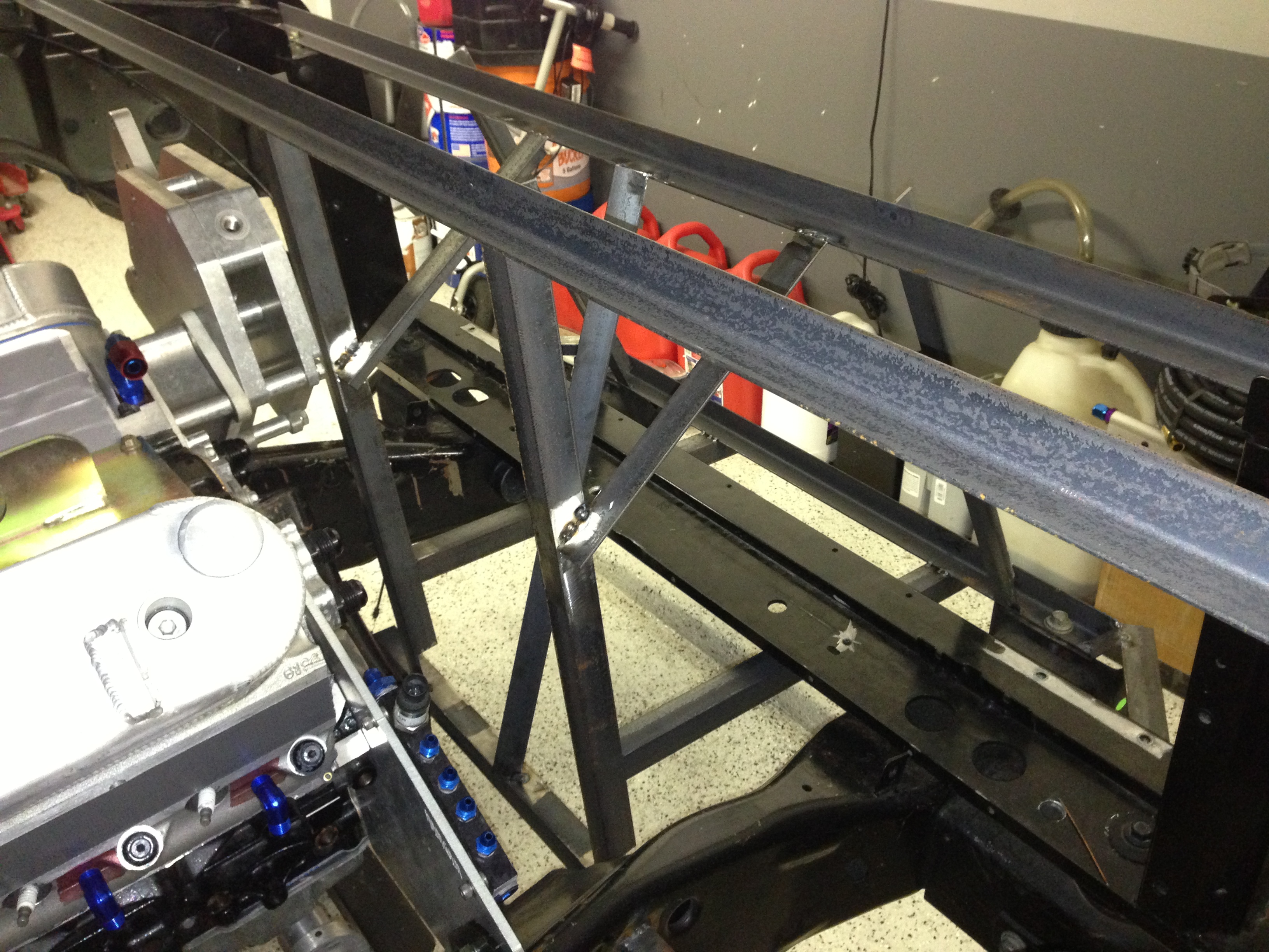

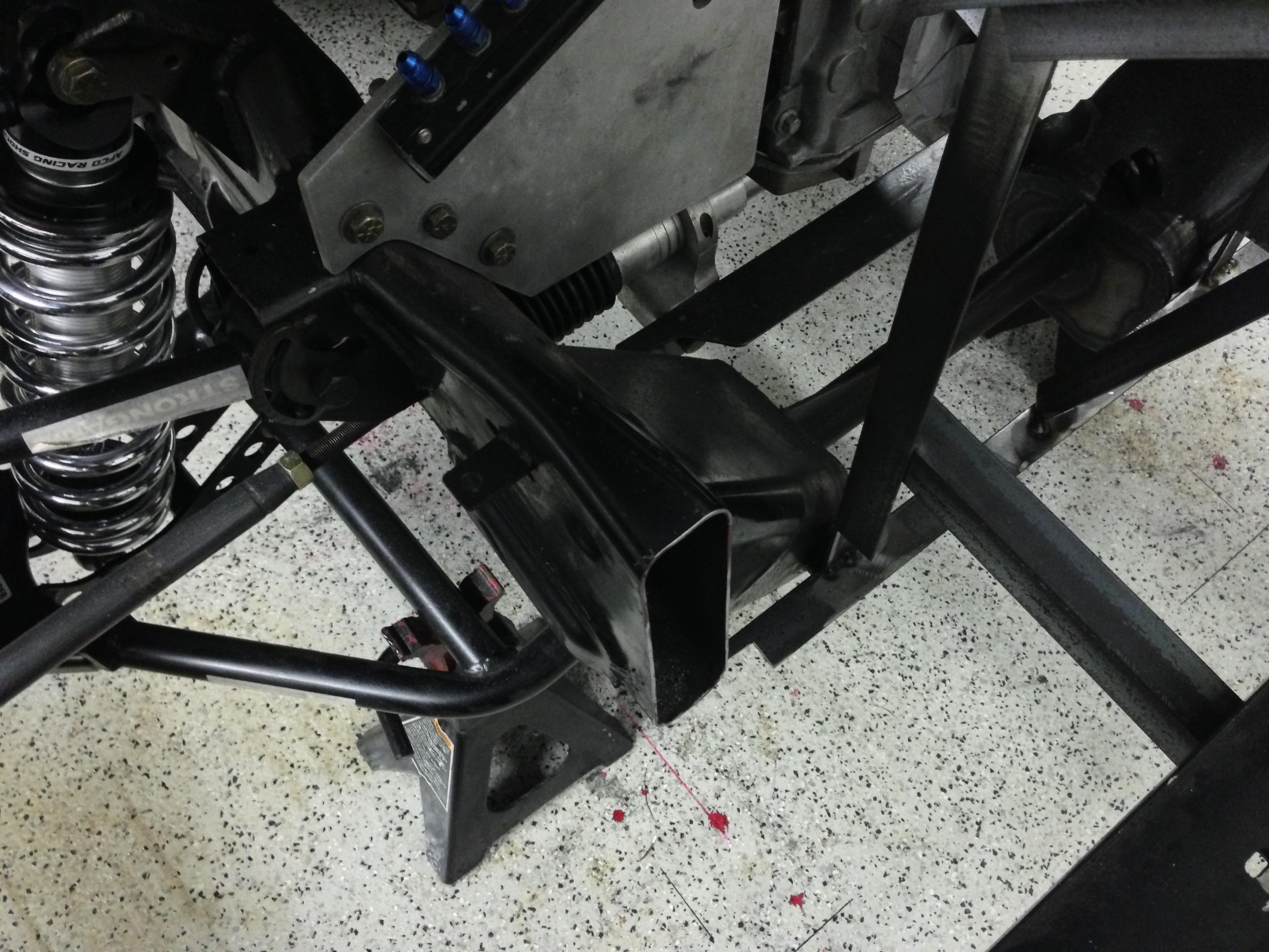

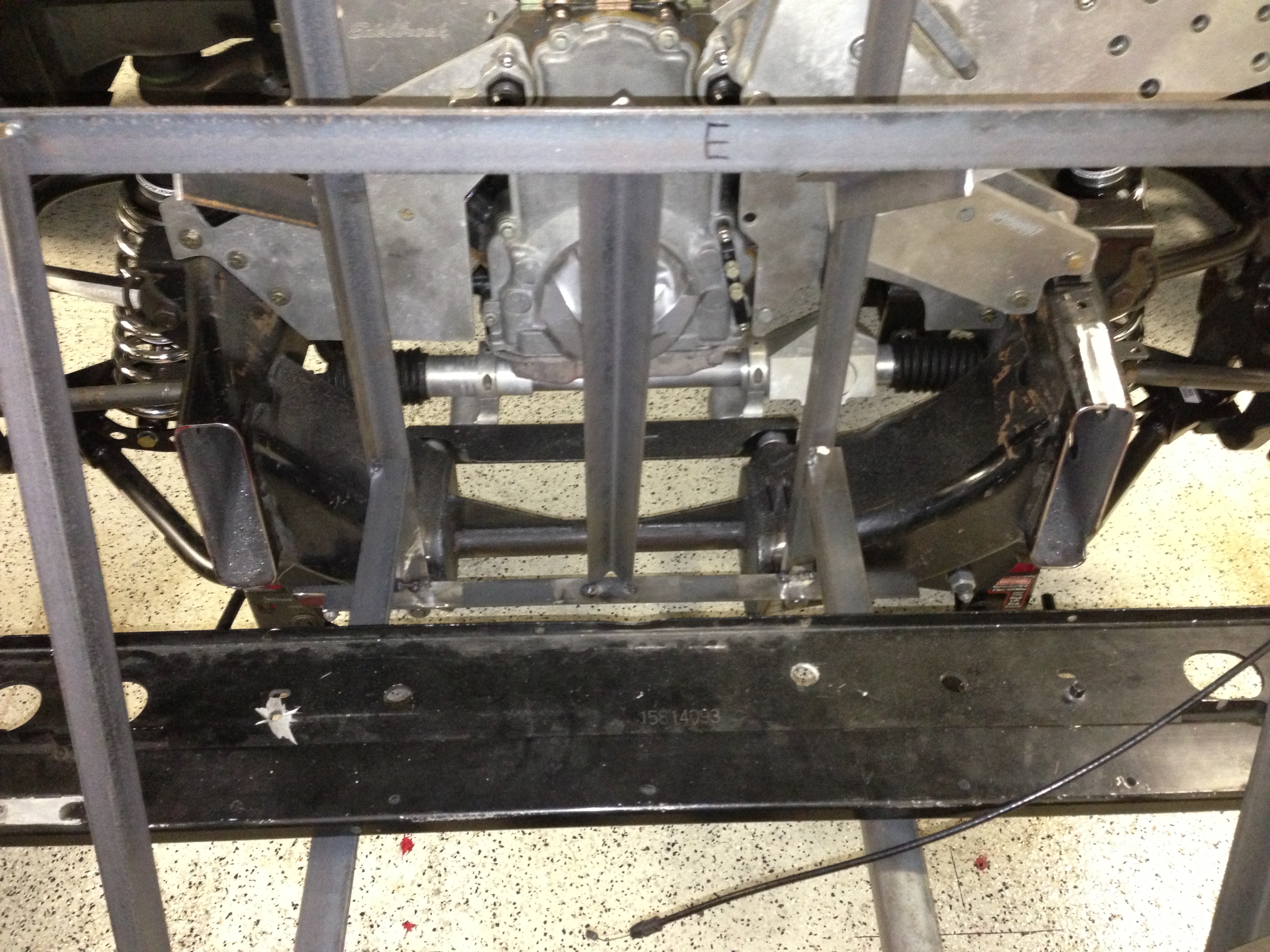

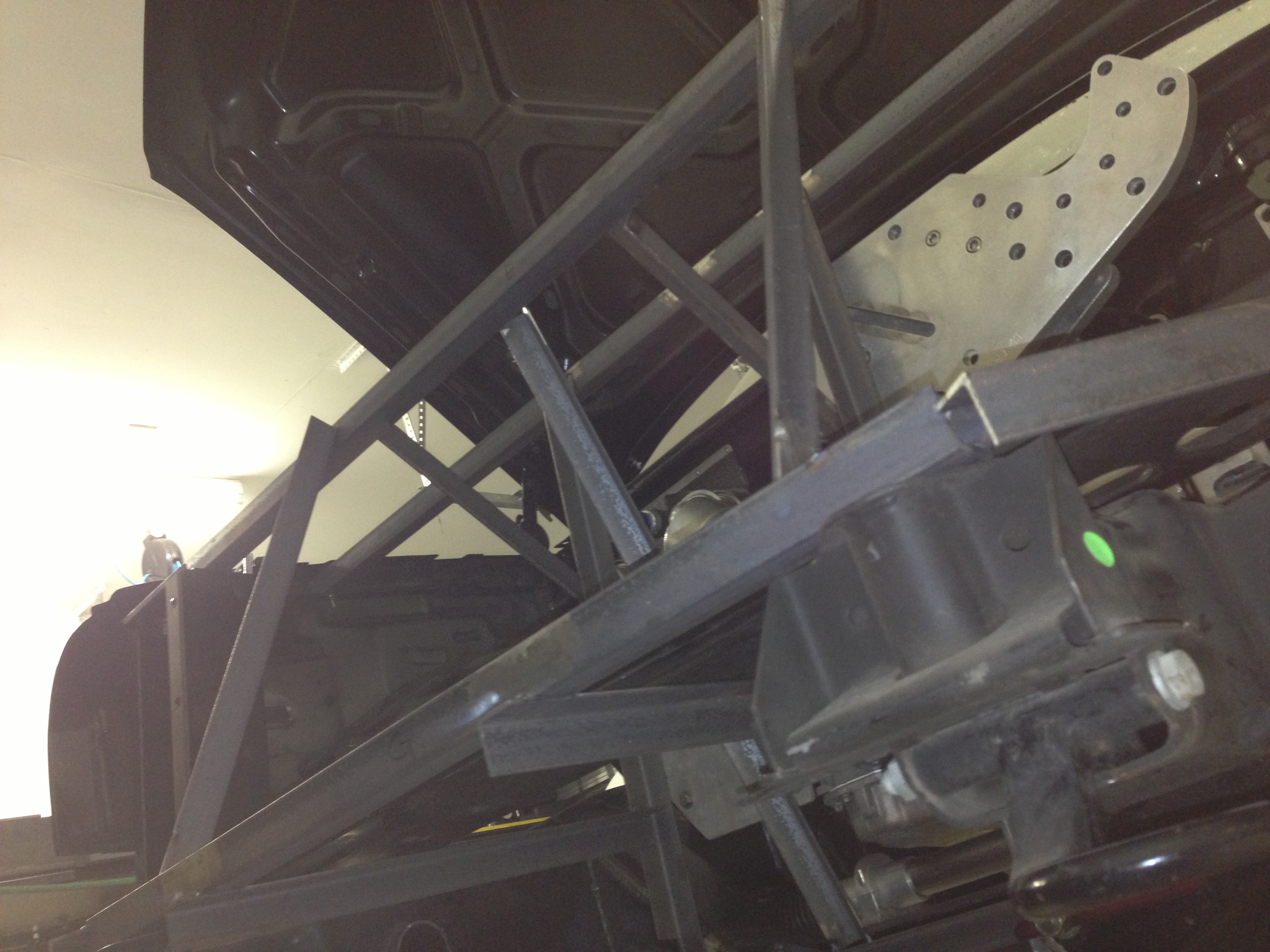

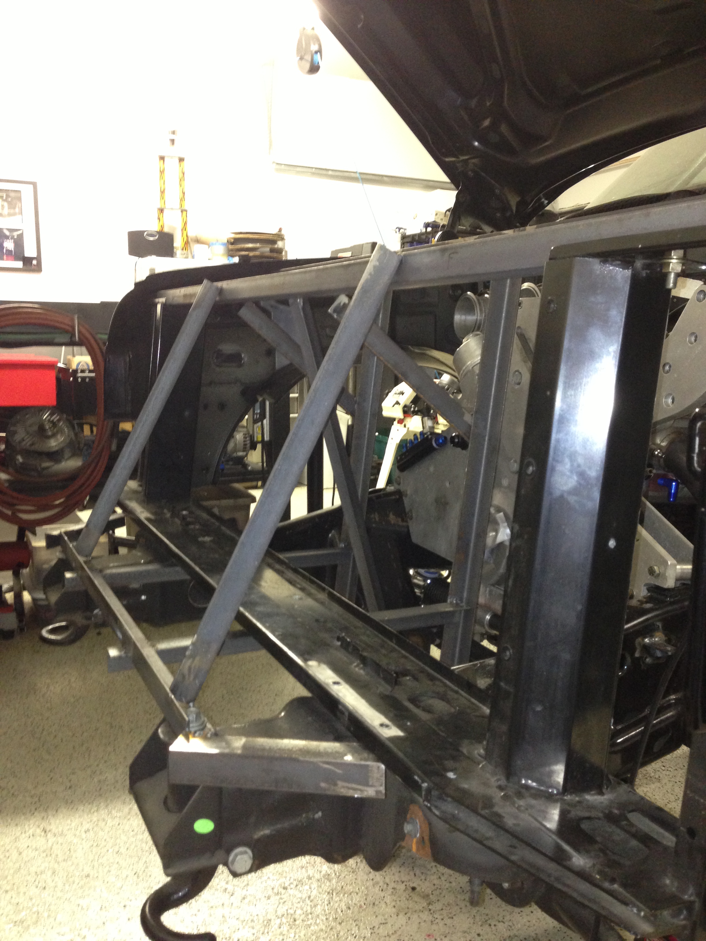

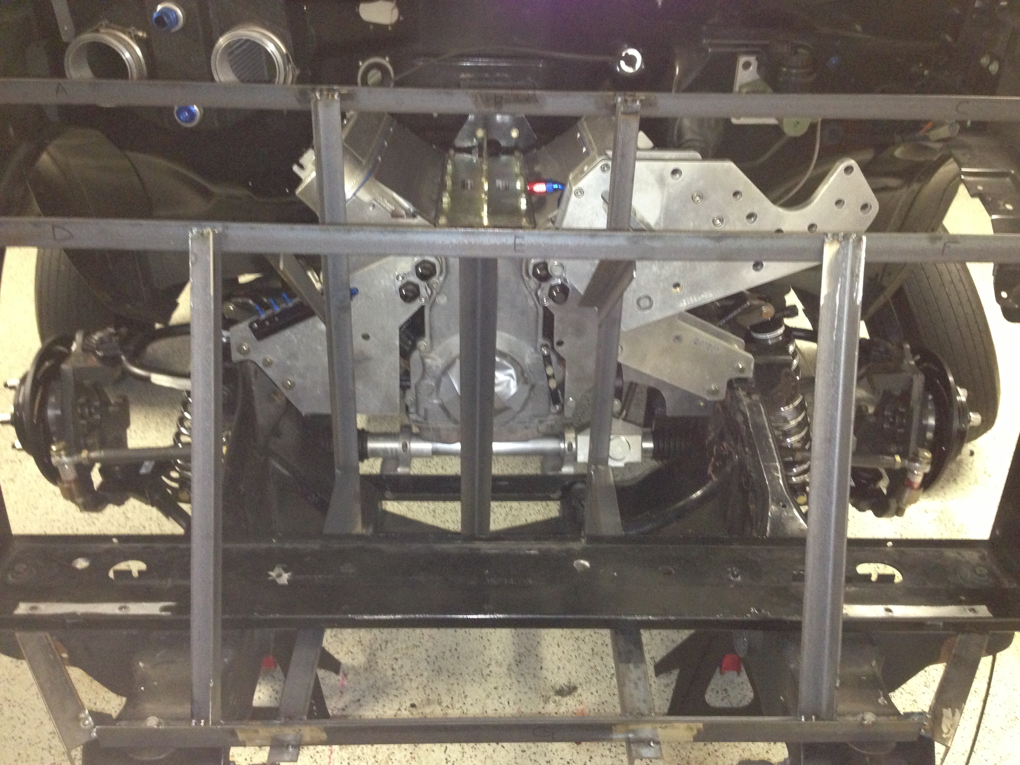

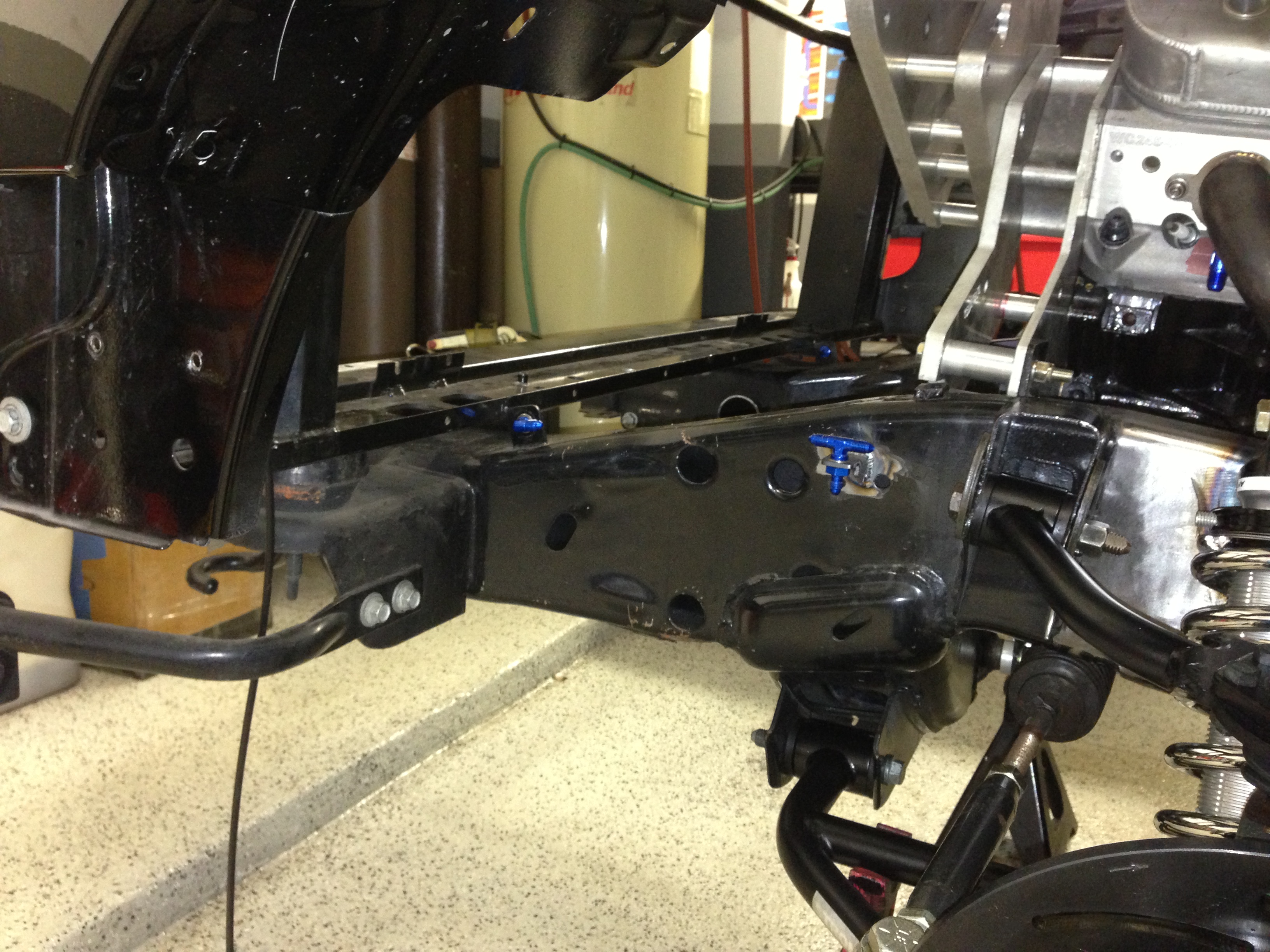

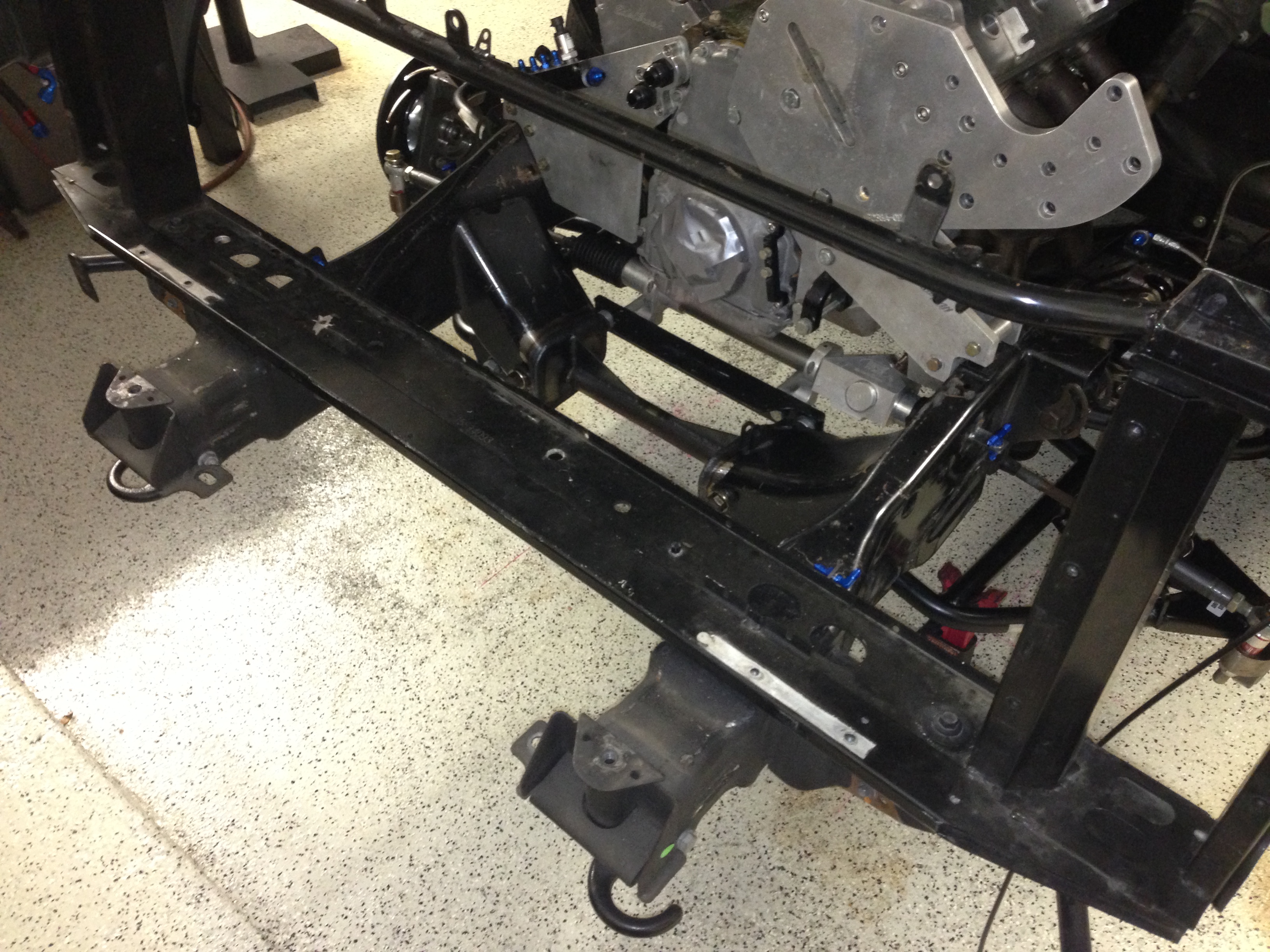

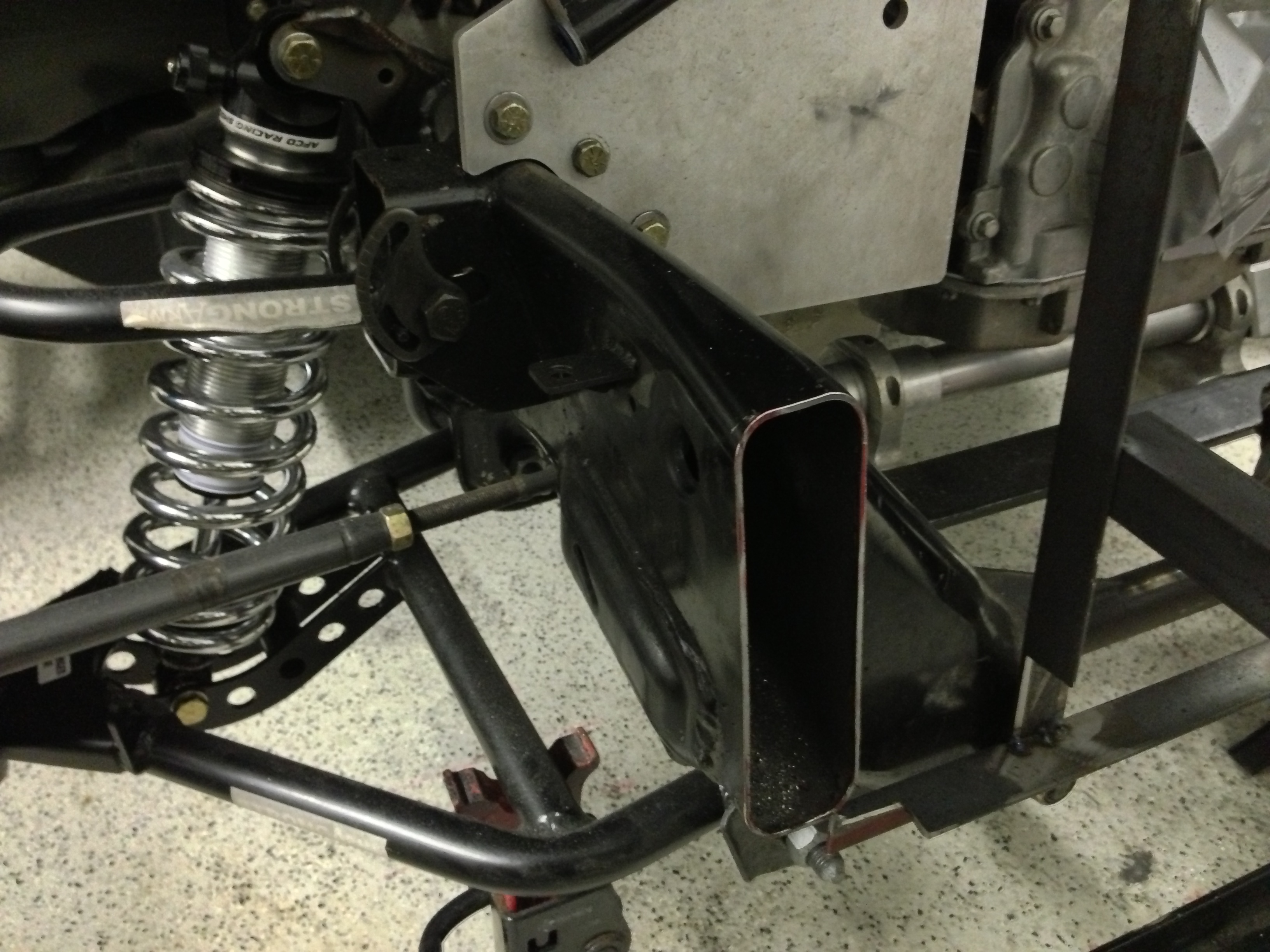

I changed my mind and decided to whack off the front frame horns and replace with CM tube. Here is where I'm at so far.
Some pics before I started:
Some pics of the bracing:

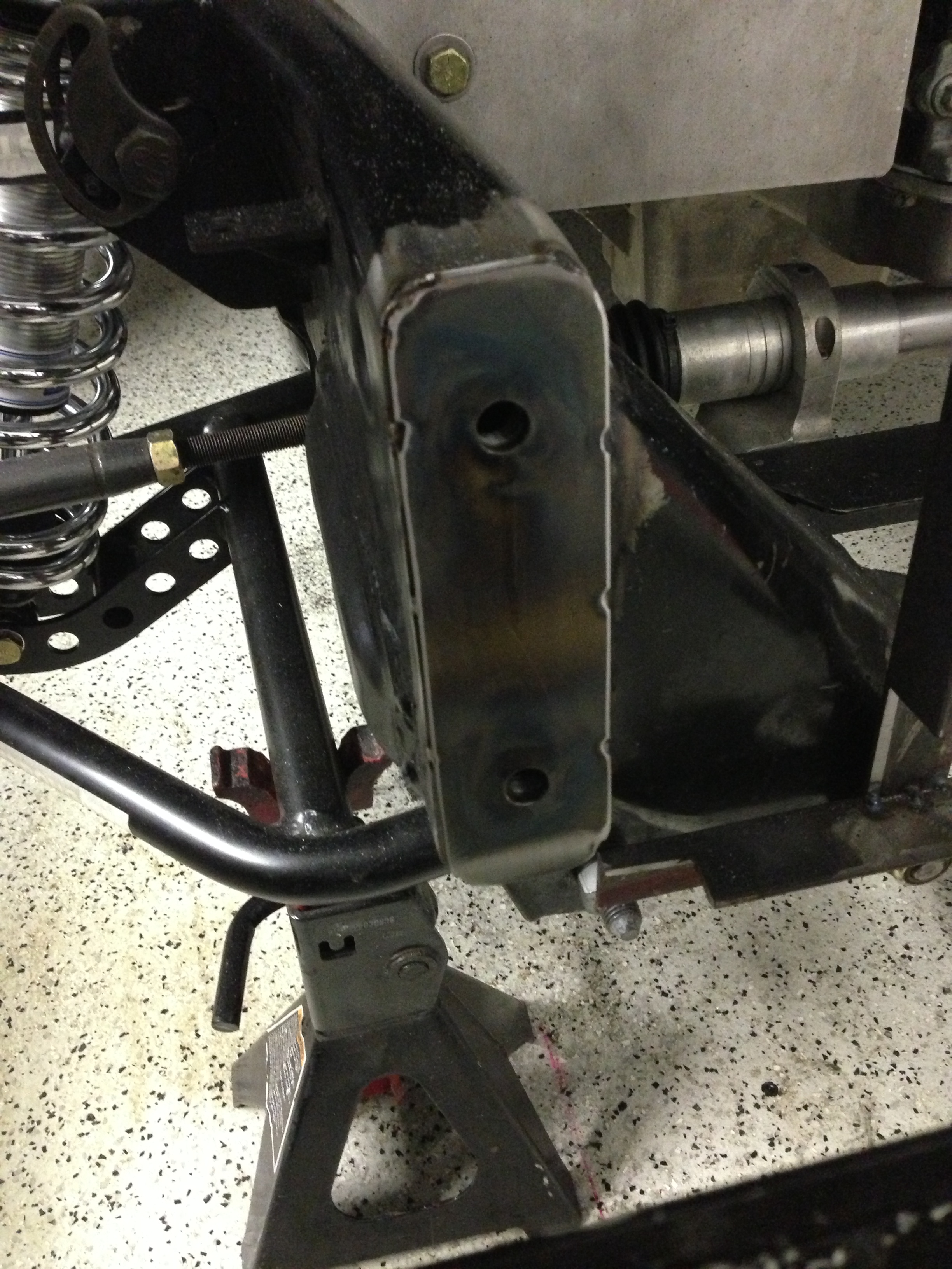

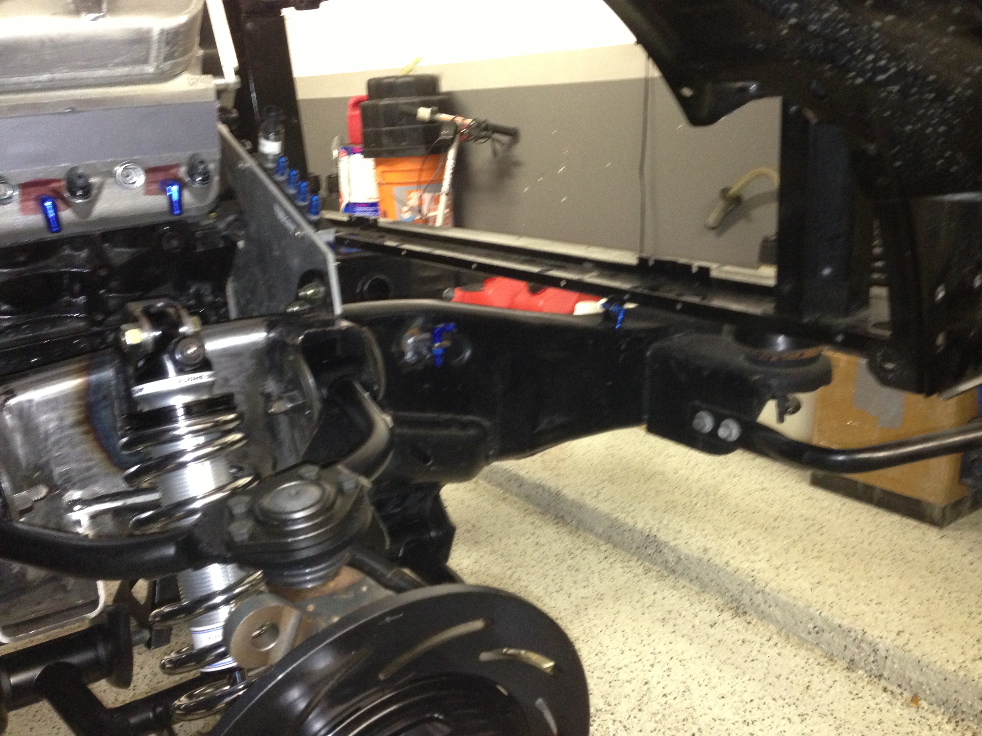

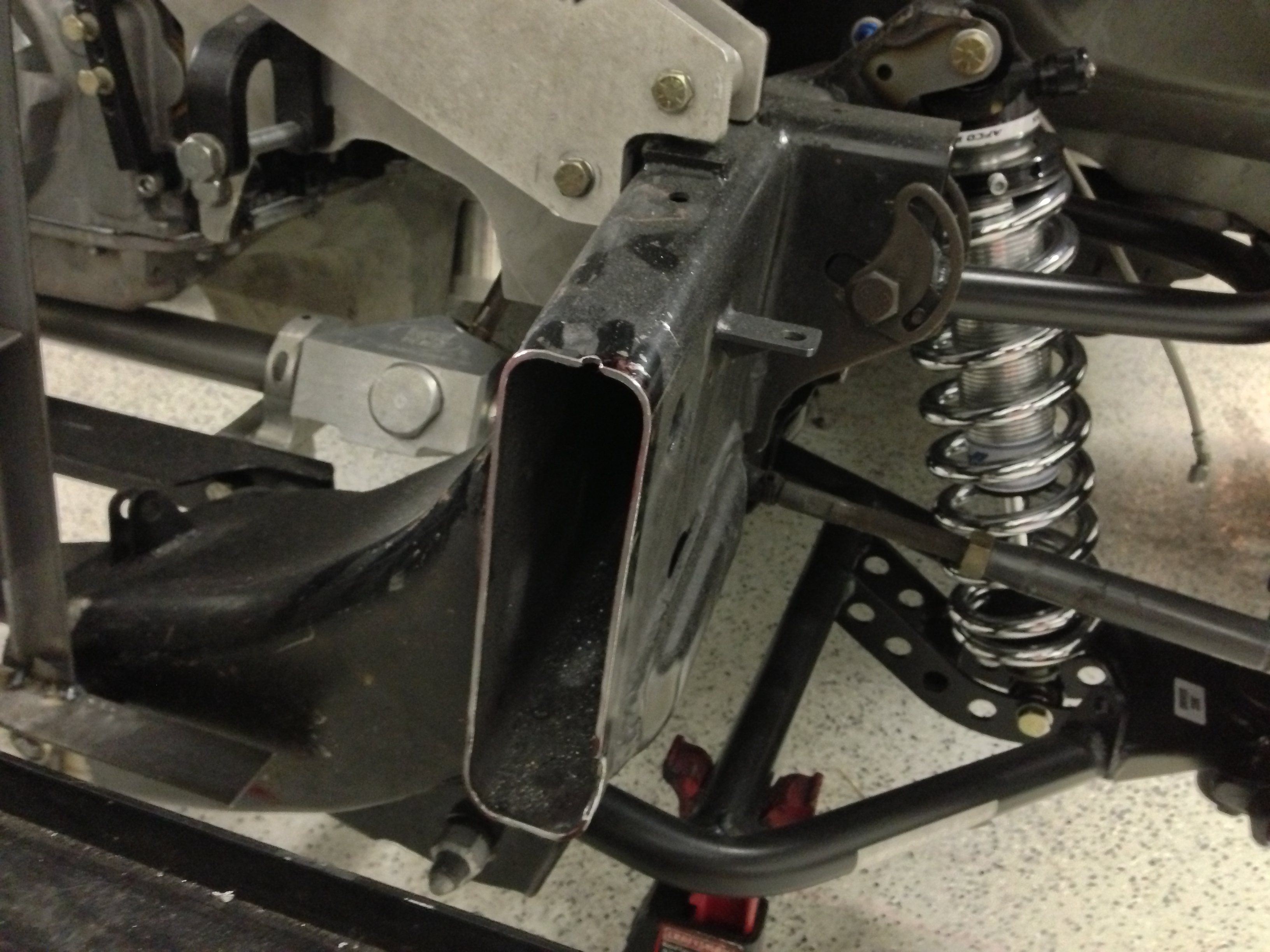

Some pics after the cut:

This mod should be worth about 35-40 lbs off the truck in front of the front axle centerline.
That should be a huge benefit in getting the front/rear % improved.

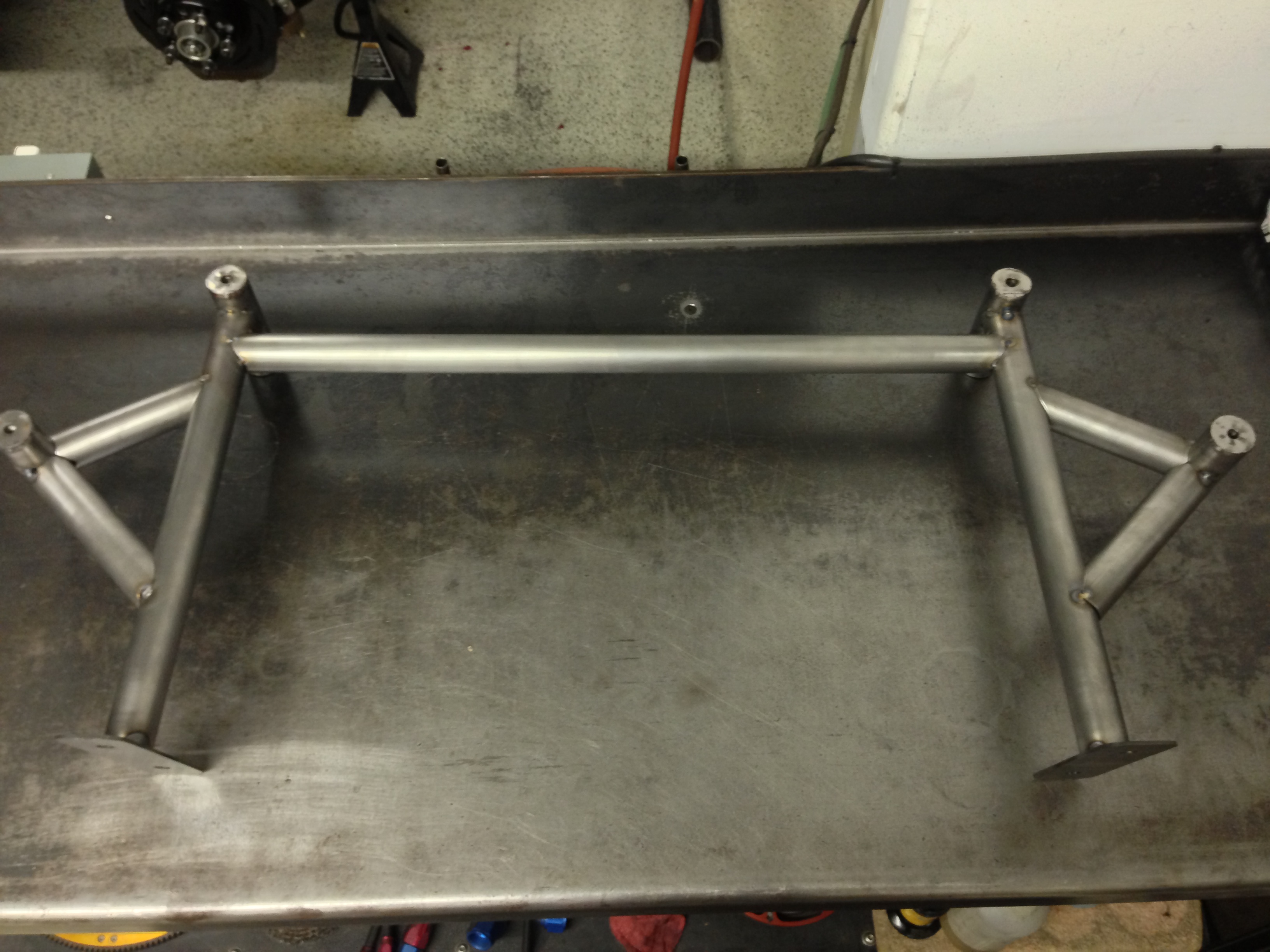

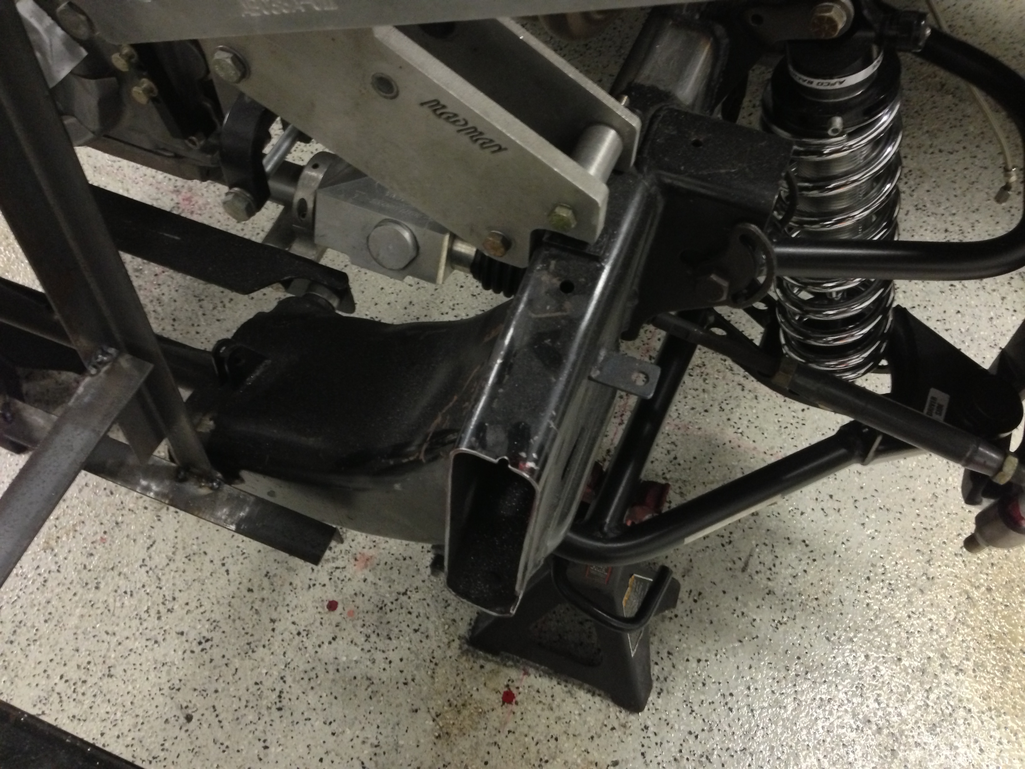

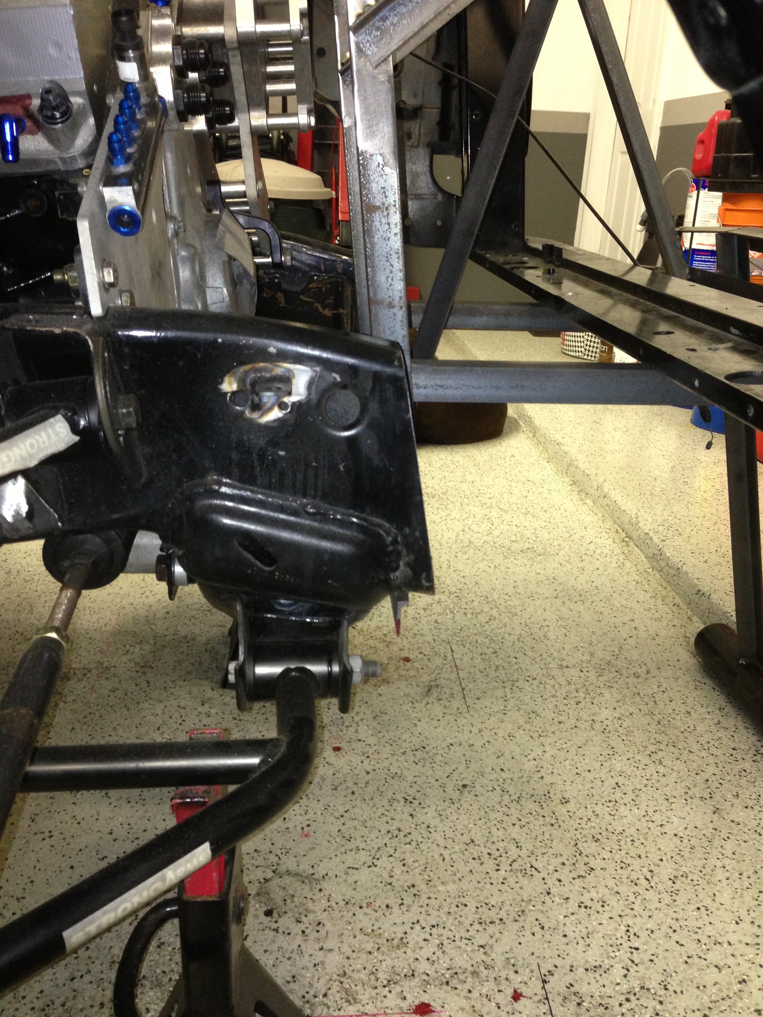

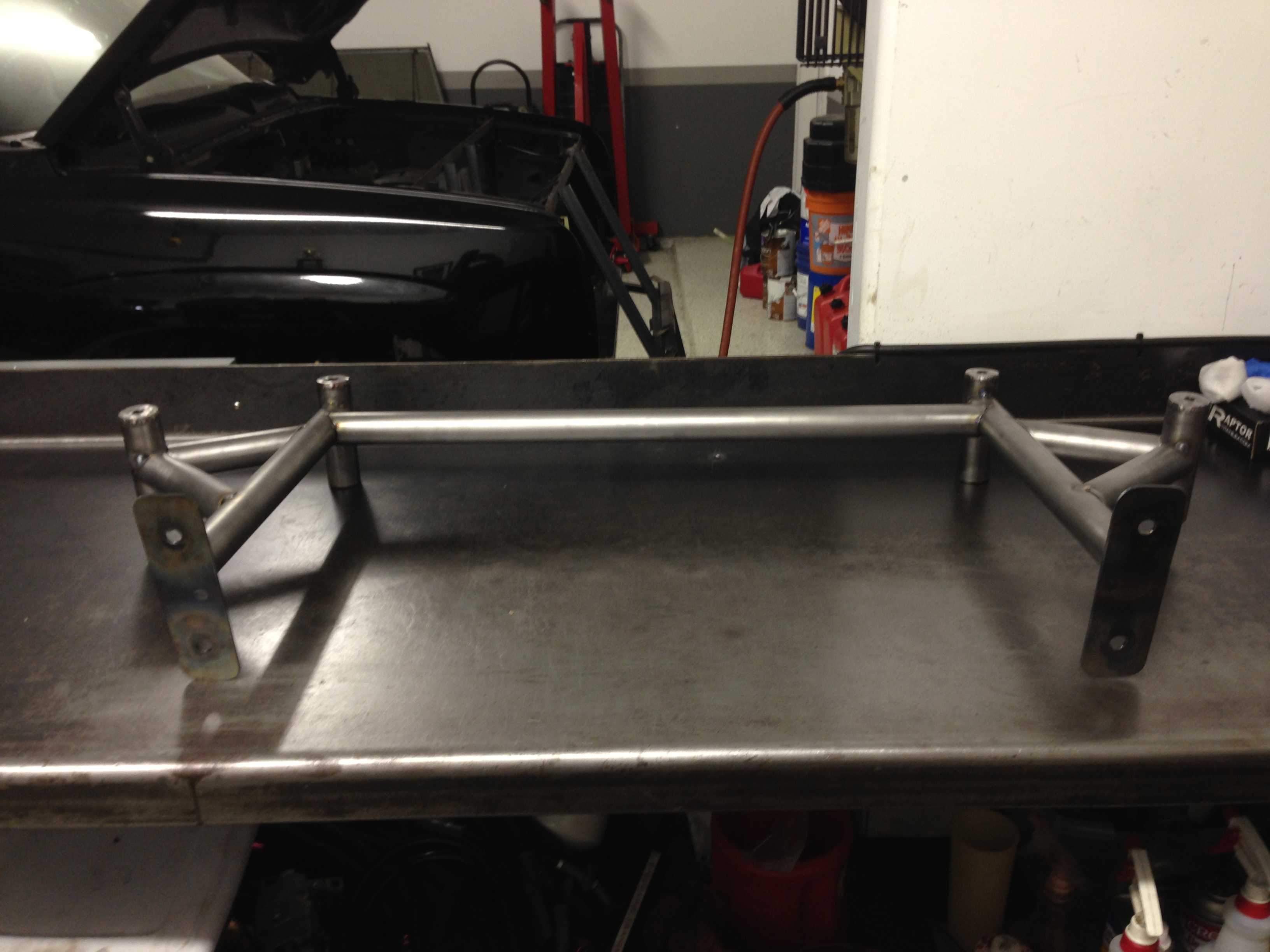

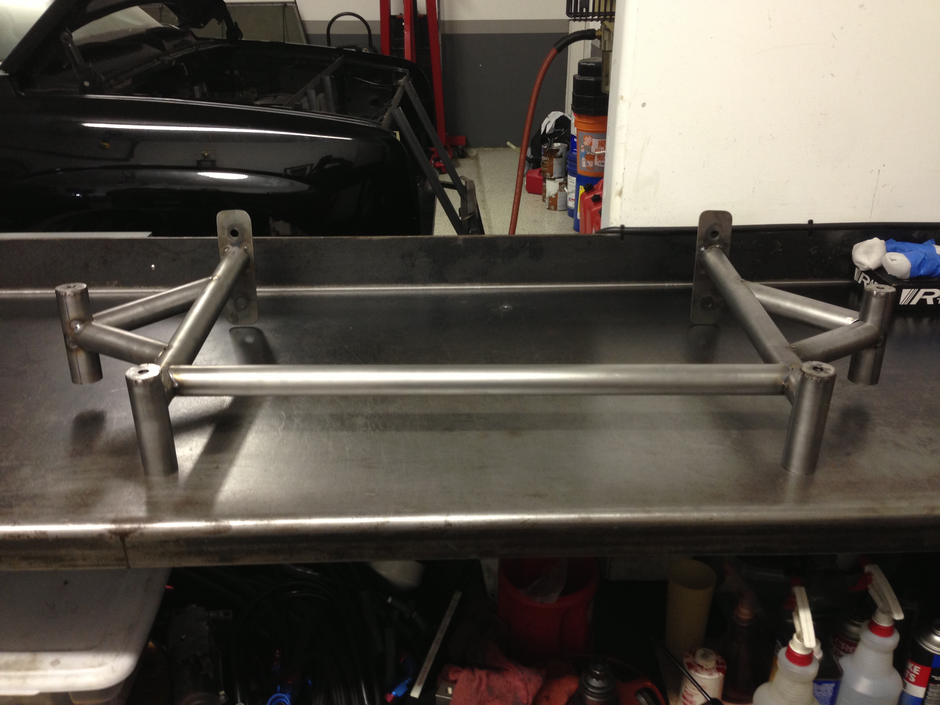

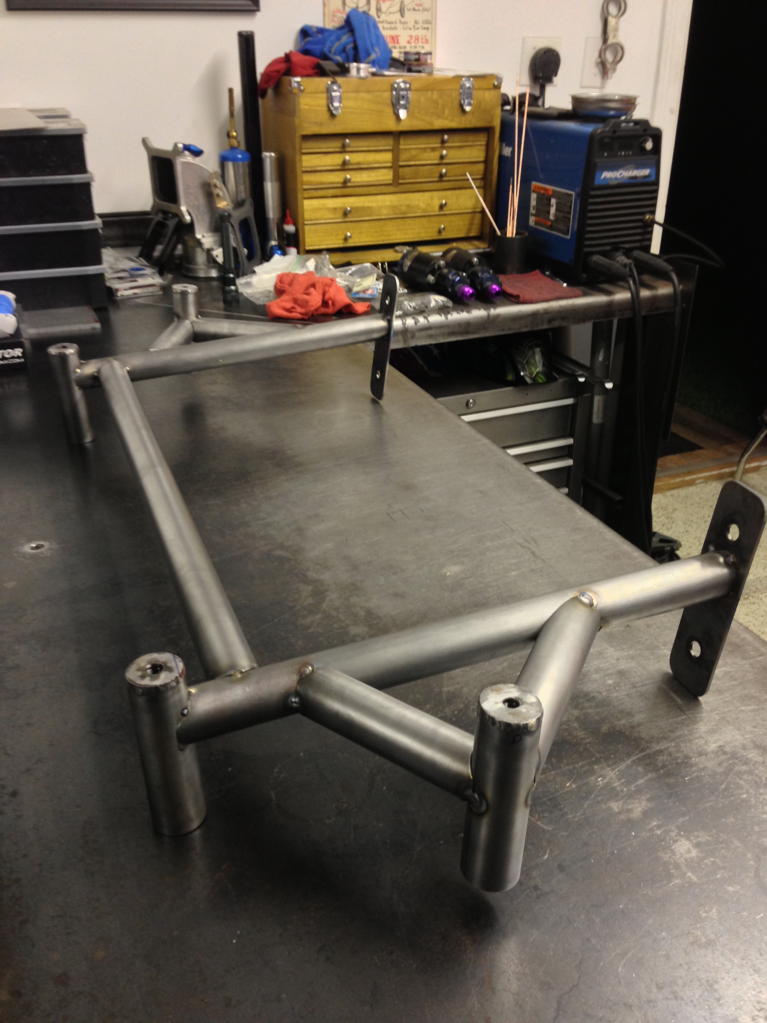

Got the front sub frame all fabbed up. Just need to weld it out. I think it turned out pretty decent.

I weighed what was left of the stock frame horns and they were 45 lbs.
I weighed the fabricated piece you see above and it came in at 10 lbs.
So total weight savings is another 35+lbs.........in front of the front axle center line. HUGE!
