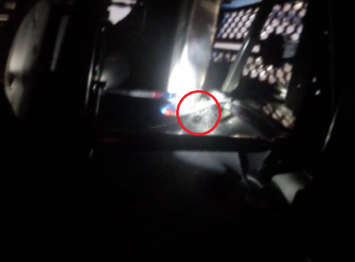

Like Atomic said, looks to me like its either coming from the line or the top corner of the HX itself.
