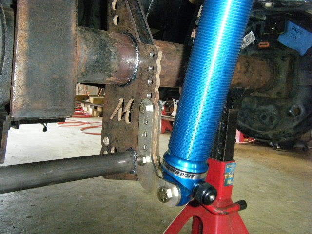

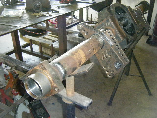

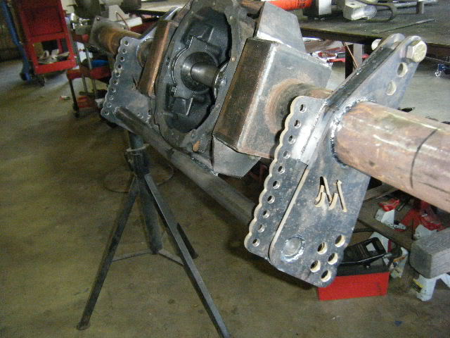

Madman called today and we were talking about some things and he told me that he redid all the 4-link brackets on the rearend housing. Something about he didn't like the way the first set came out. I must say is looks killer.

We're gettin the rear centered in the truck and the 4-link brackets should be in by the end of today. I'll send some more pictures when all that's done.

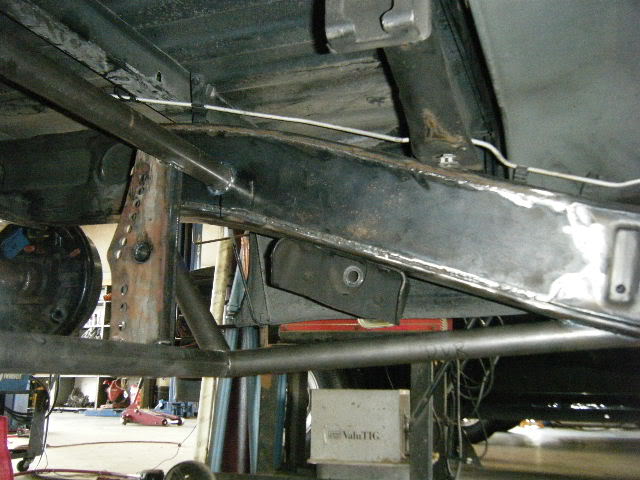

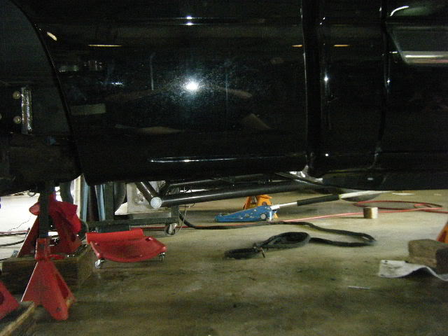

Thanks for the pics, looks good.
