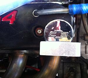

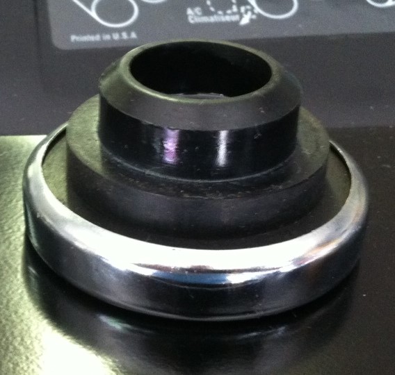

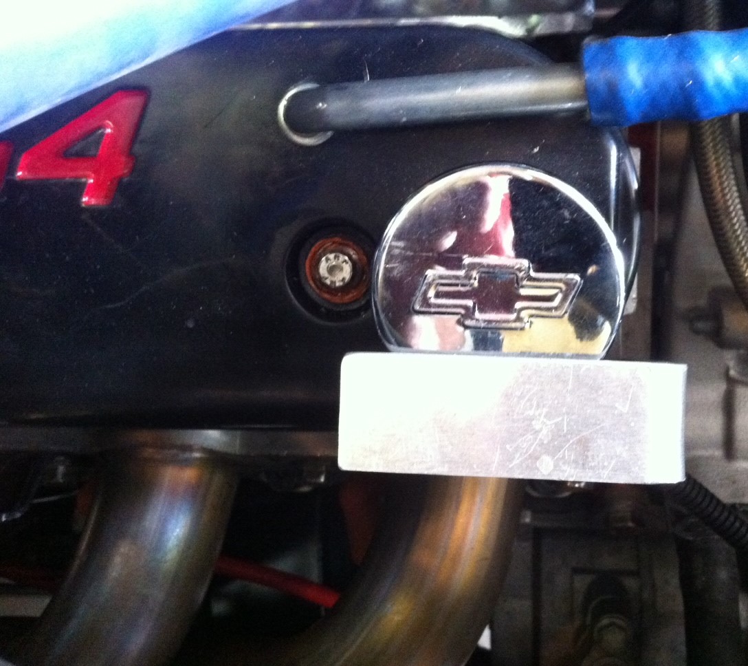

Purchased my GMPP set a while back. My spares from Summit could be Proform. Purchased them 2-3 years ago. Didn't see any difference. Maybe both Summit and GM have a newer design. Maybe they are actually one in the same?? Pics of my current cap below.
https://www.corvetteforum.com/forums...ve-covers.html
