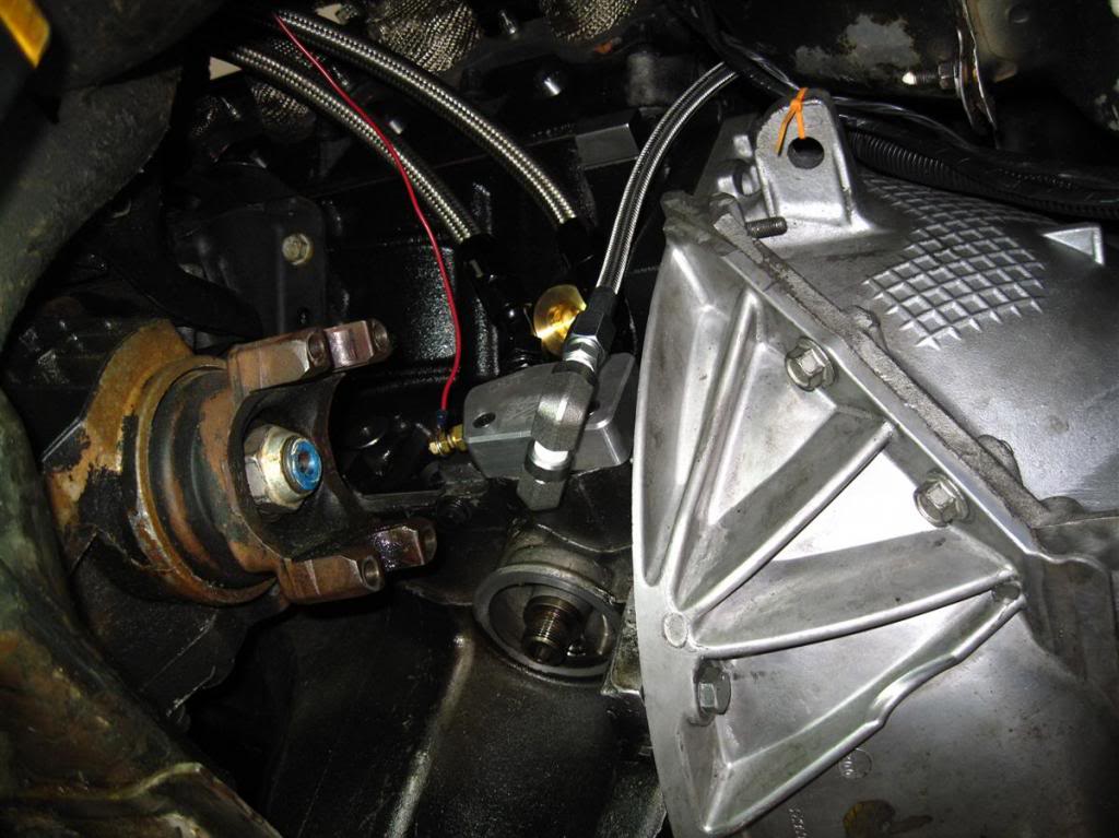

Yea that looks way too far inward torwards the trans. I dont have an exact pic of it from the same angle, but heres about where the driveshaft is.

Corey , are your transmission ears cutoff? and how closed is it to the park/neutral switch?

Yep they are cut and it is about 6-8in away from the switch. Tons of room

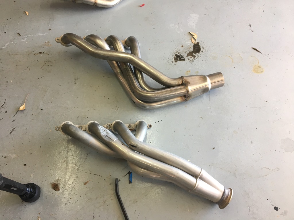

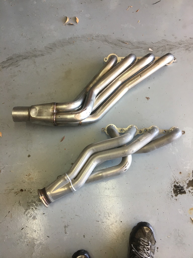

Kooks vs tsp headers.

wtf were the kooks headers aimed at. that's a weird collector angle.
instead of denting the header, what about putting a 2" hole saw to the frame and spraying the exposed metal down with primer and undercoating?

Yeah i am gonna recess the frame a little where it hits.

the kooks look small vs tsp, how much boost did you make with the kooks? do you think you might loose some boost?
