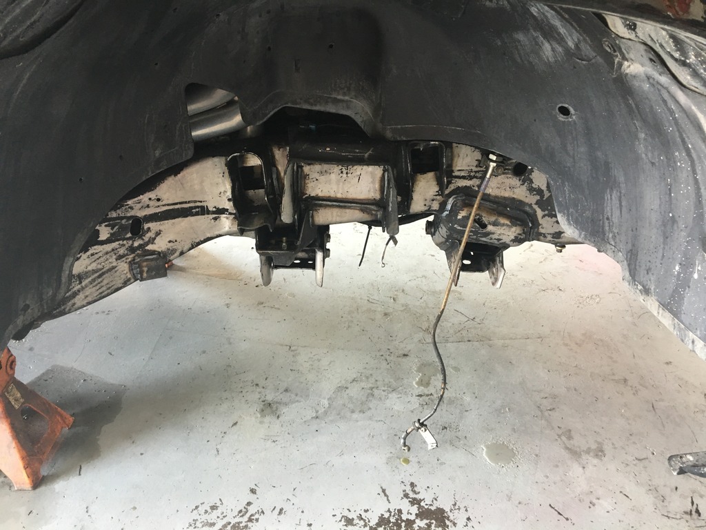

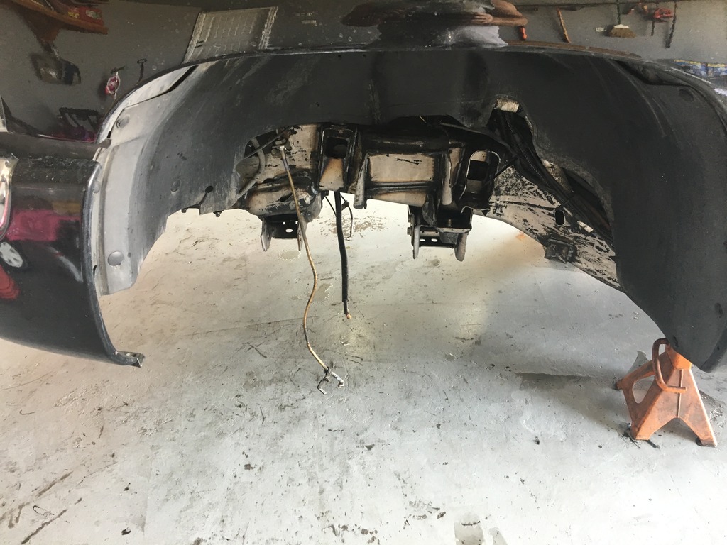

All pressure washed. Man what a ******* mess. I gotta throw some paint on it now.

some wesleys bleach white along with that pressure washer will make your fender liners black again.

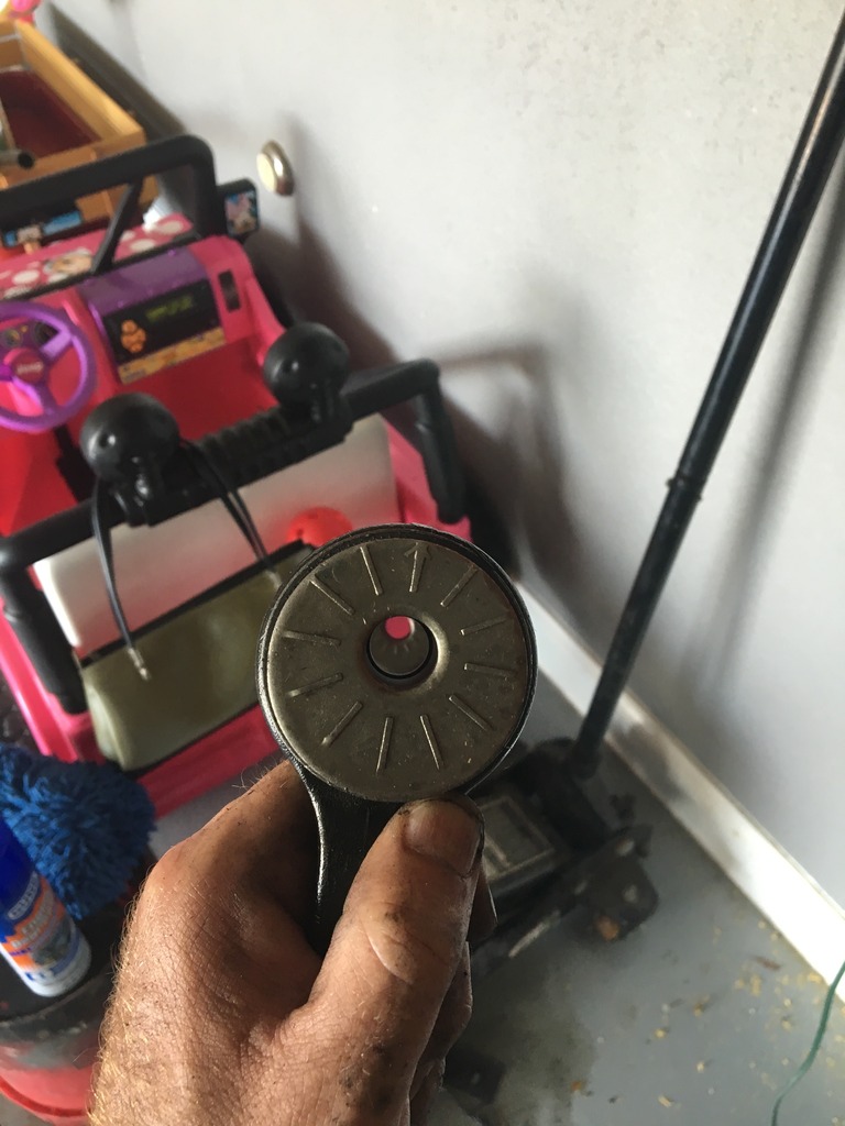

Offset bushing. You can see it is just slightly offset
Old Jul 1, 2016 | 04:51 PM
  #436
lxcoupe's Avatar
Joined: Nov 2004
Posts: 1,127
Likes: 22
From: California
Those look really nice. The Belltech offset bushings are actually narrower than the OE so when you tighten down the control arm bolts, you see the tabs compress inwards. It would be hard to ever get stock uppers back into mine.

Wow the frame looks good under there. I didnt think pressure washing alone was really good enough to strip that stuff. I had heard you needed a hot water pressure washer.
The wheels are going to look great.
Old Jul 1, 2016 | 06:07 PM
  #439
BlackGMC's Avatar
Resident Retard
iTrader: (31)
Posts: 17,216
Likes: 20
From: Fort Worth - TX

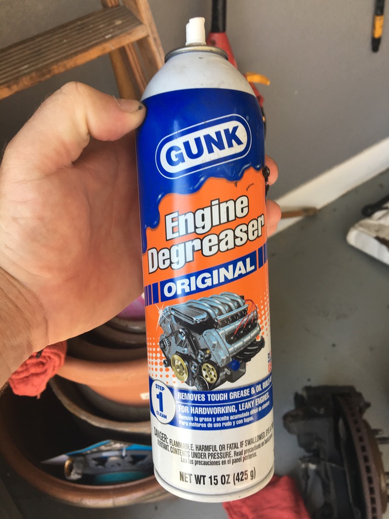

Apply this stuff first ehen everything is dry. Let sit for 10-15min. Then that frame coating **** blasts off. It does make a horrible mess
