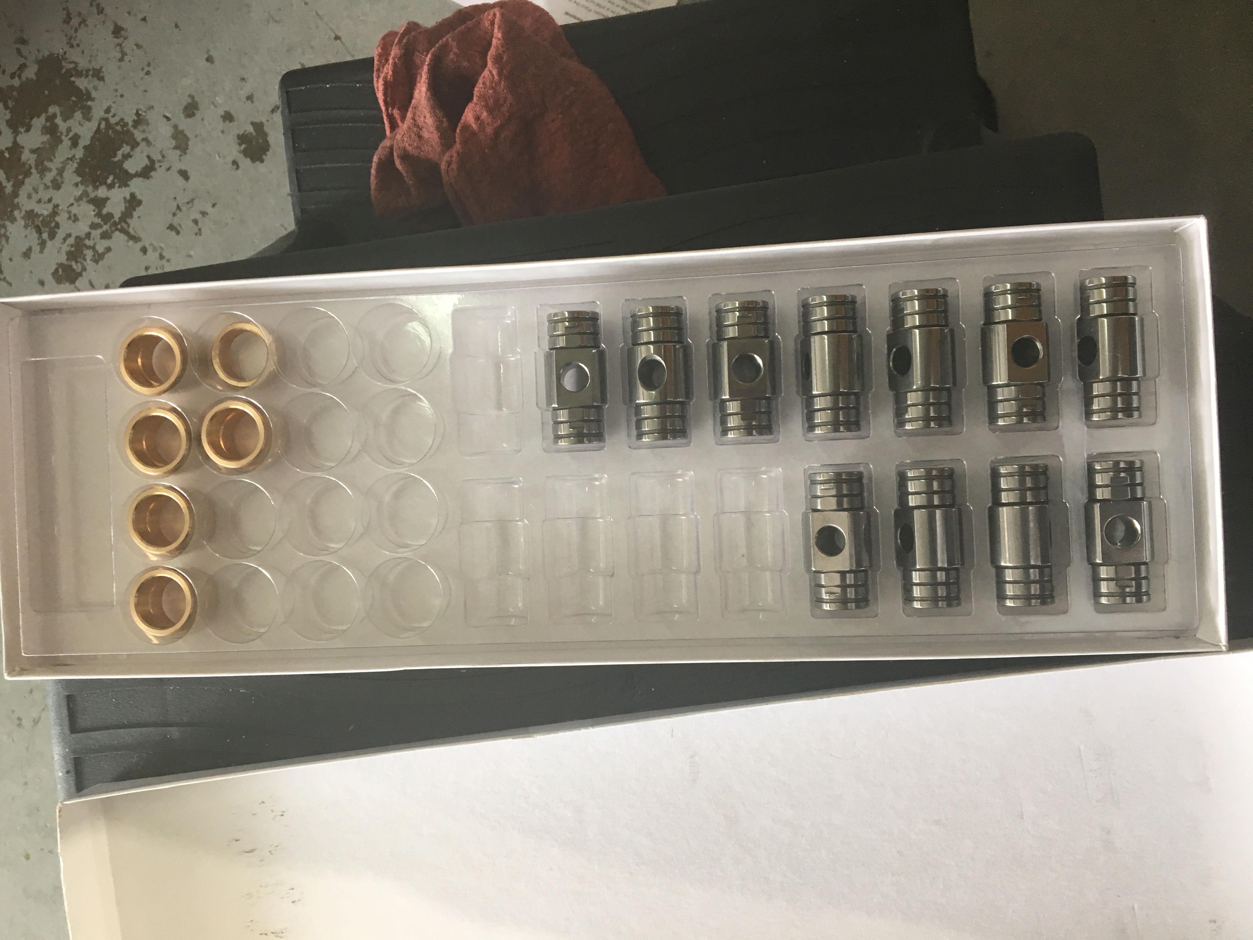

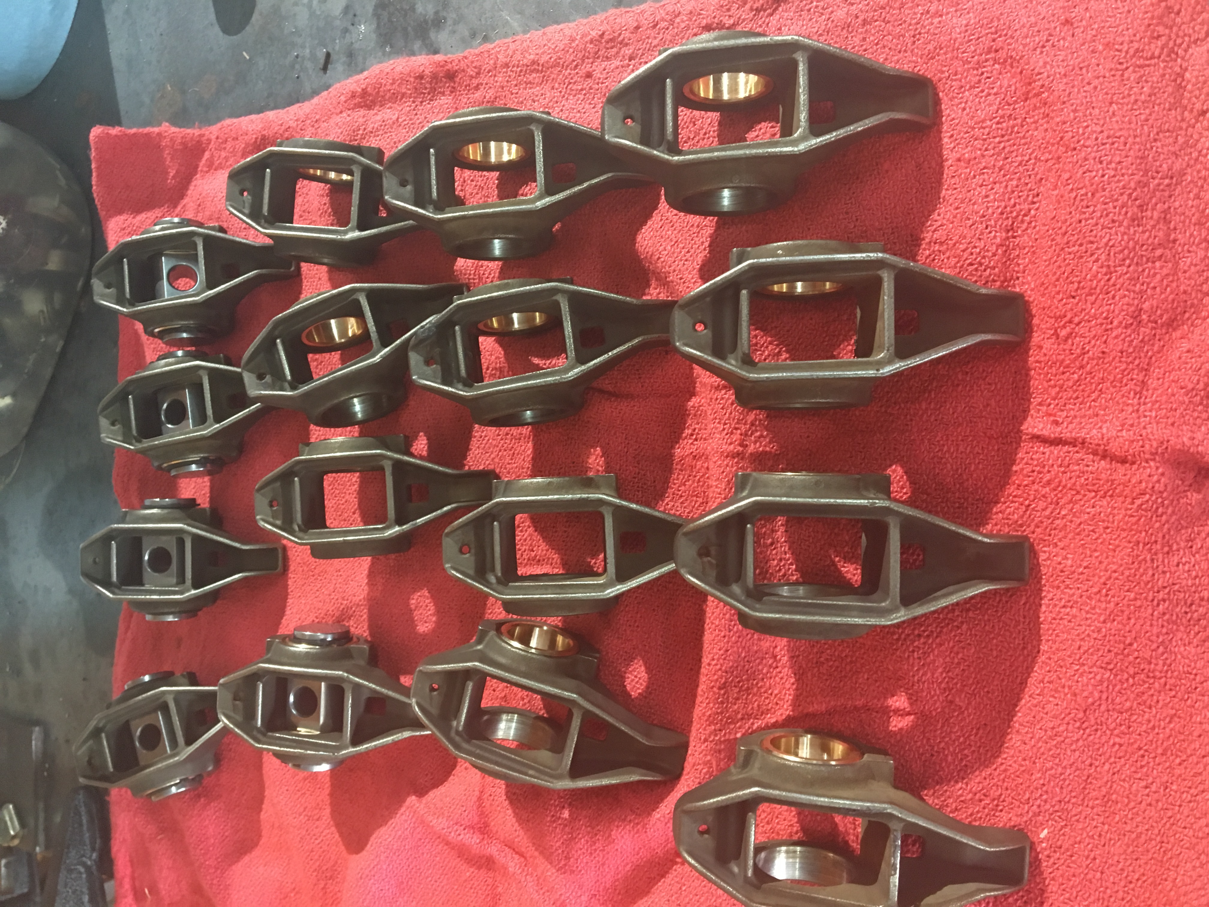

Still waiting on parts and the heads.
Pics of the trunion upgrade.
Attached Thumbnails BlackGMC build take 3 - Supercharger Time-img_5860.jpg   BlackGMC build take 3 - Supercharger Time-img_5861.jpg
Is that the Summit trunnion kit?
