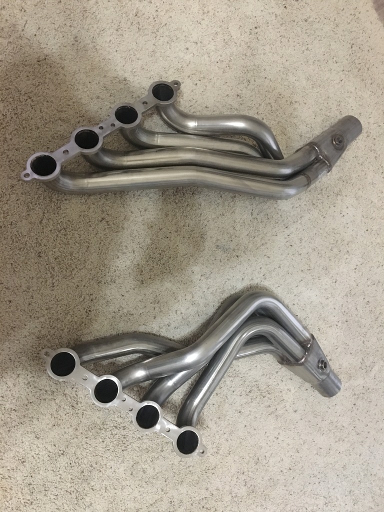

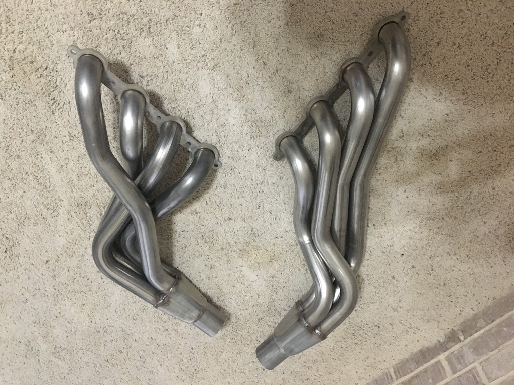

TSP 2in fbody Headers arrived. I will try them on in a few hours

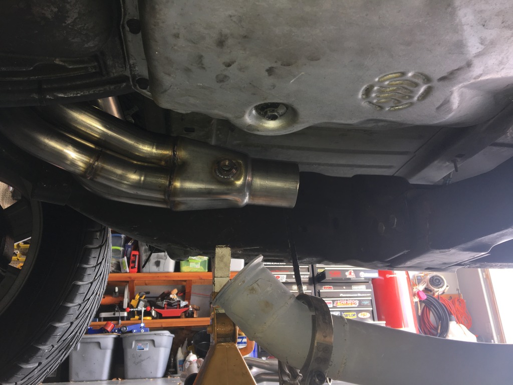

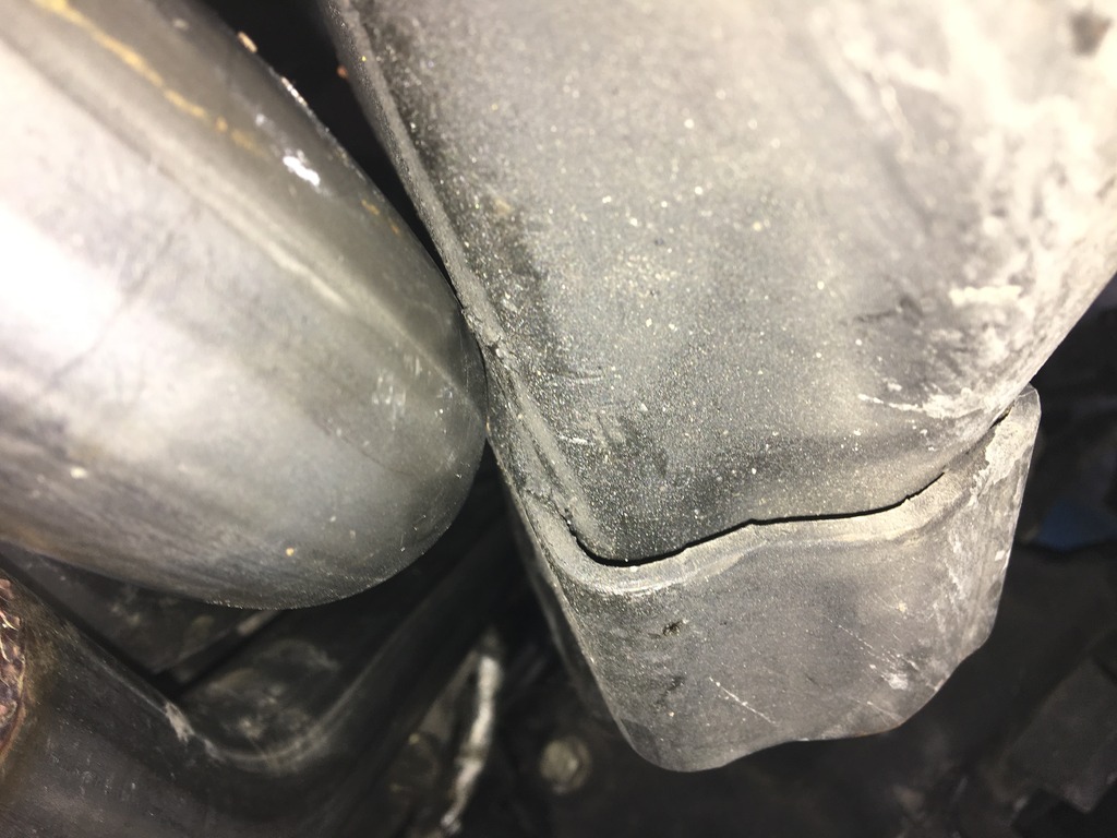

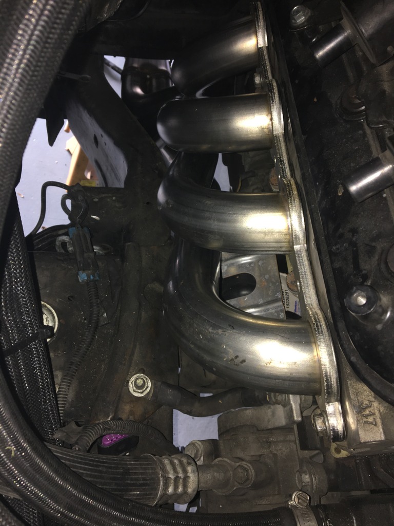

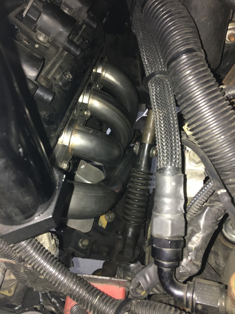

Well they fit pretty good except one spot where it hits the passenger side frame rail. I gotta say they fit better than my kooks truck headers. Tons more room around the steering shaft and they dont sit on the passenger side frame rail

Here is where hits

Wonder how these would fit on a NNBS in that area?
And what was the actual part number you ordered if you dont mind?

Are these the same ones? https://www.texas-speed.com/p-4909-t...ollectors.aspx

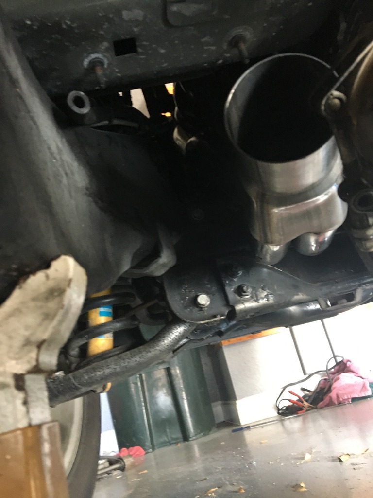

If that one spot is the only issue ill gladly wack it with a hammer to save $600 over some ARH headers.
Do you have a picture from straight back on the driver side? I wonder how close it would be to a front driveshaft on a 4wd.

Yep those are them. I could have fit the 35 collector easily
I will get you a pic from the back. I am gonna leave them one today so if you want measurements just ask
