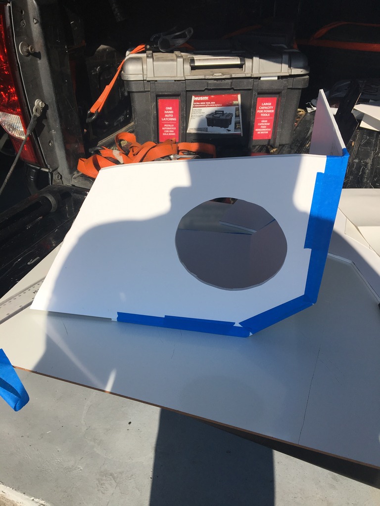

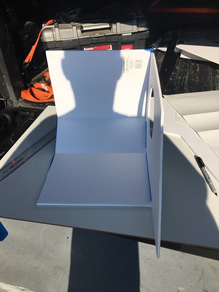

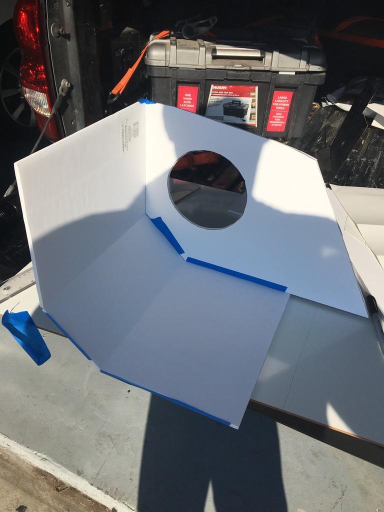

New heat sheild design.

Gonna go with aluminum or steel?
Old Nov 12, 2016 | 03:24 PM
  #736
BlackGMC's Avatar
Resident Retard
iTrader: (31)
Posts: 17,216
Likes: 20
From: Fort Worth - TX
It will be aluminum.

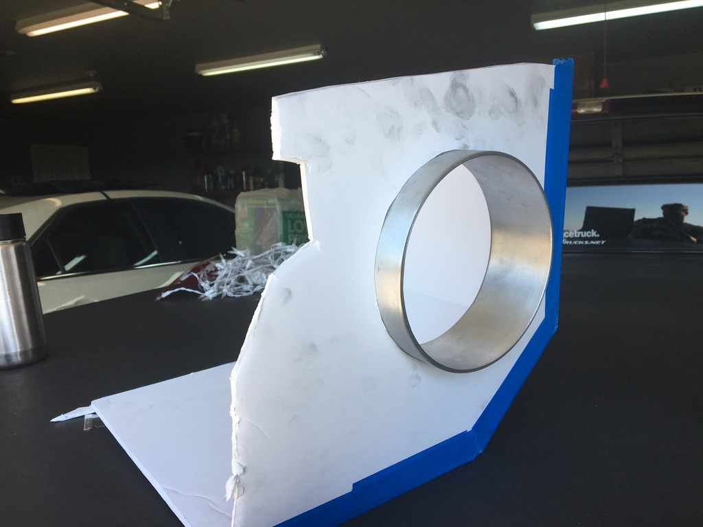

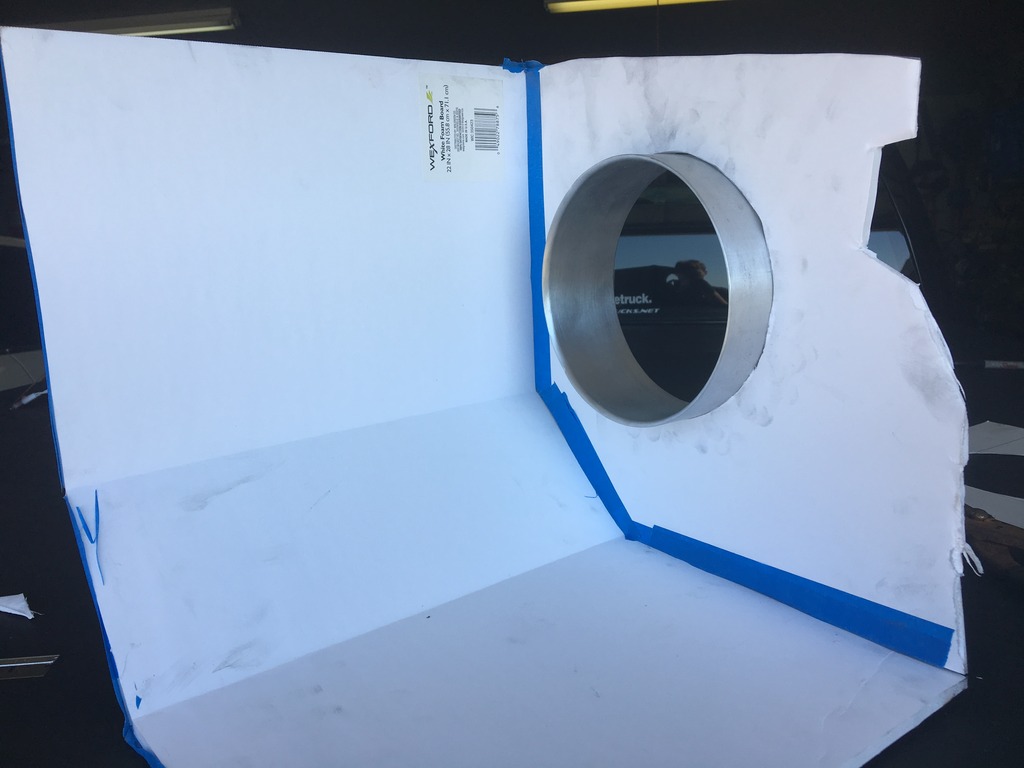

A little more mock up. That is a 6in wide 1/8 thick tube that the filter will mount directly too. Then a 6in to 5in coupler will attach to the intake tune.Name:  E0CB2C07-F6E6-4E08-B572-4A6DB3AAD6B8_zpsaqgcuzsl.jpg

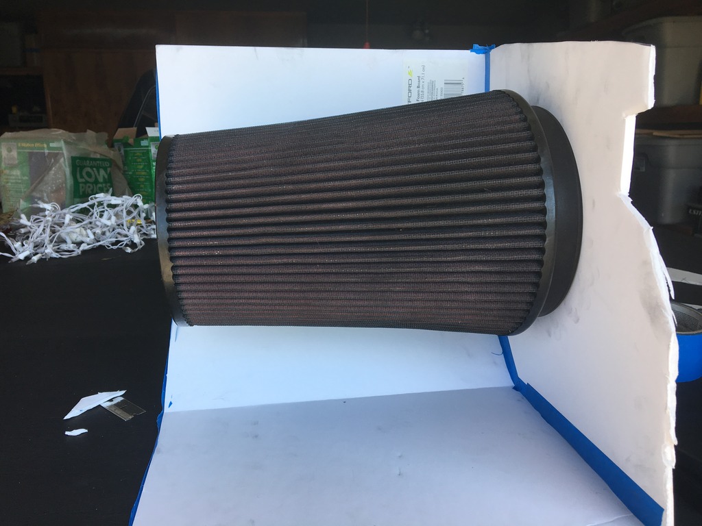

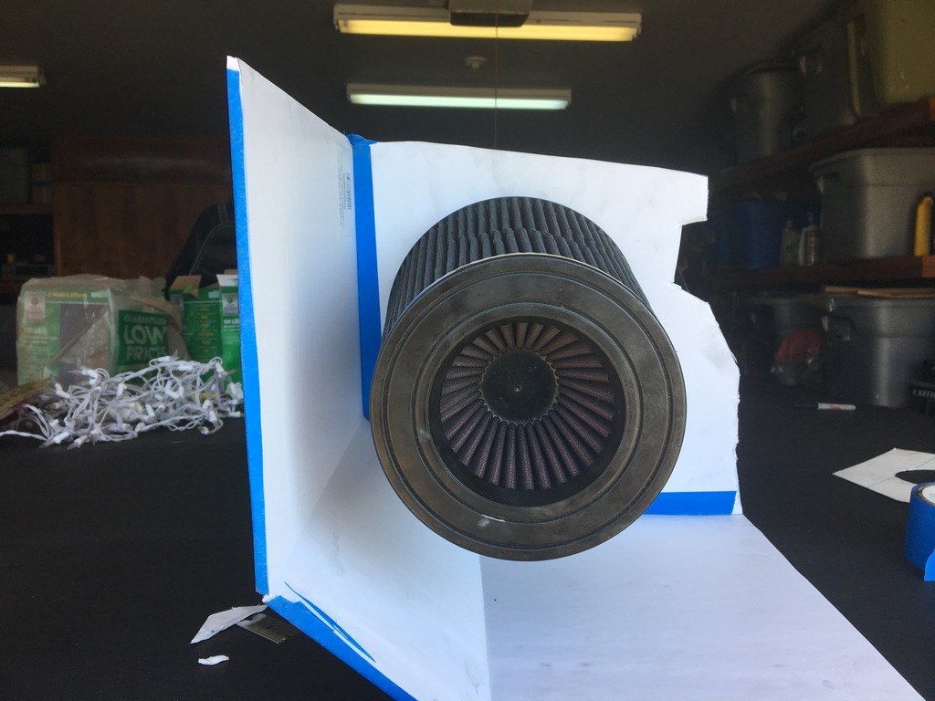

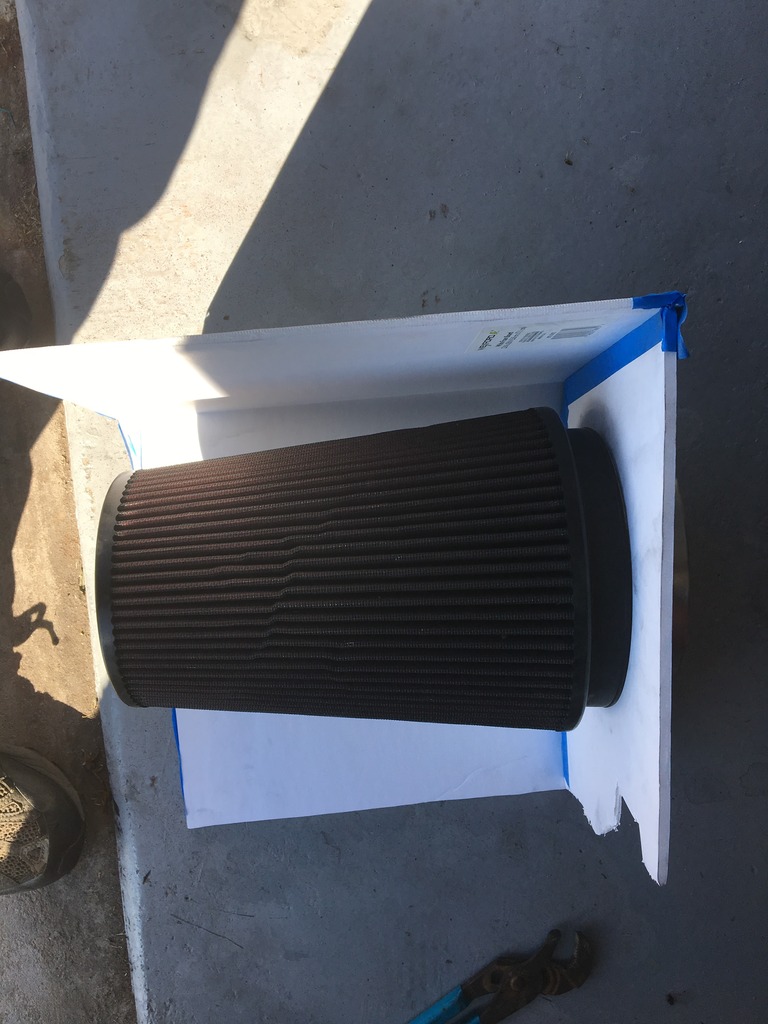

Filter attached
Old Nov 13, 2016 | 01:14 PM
  #739
GM1697's Avatar
Joined: Oct 2014
Posts: 1,568
Likes: 12
From: in MA or SC
I like it.
Make 2.
