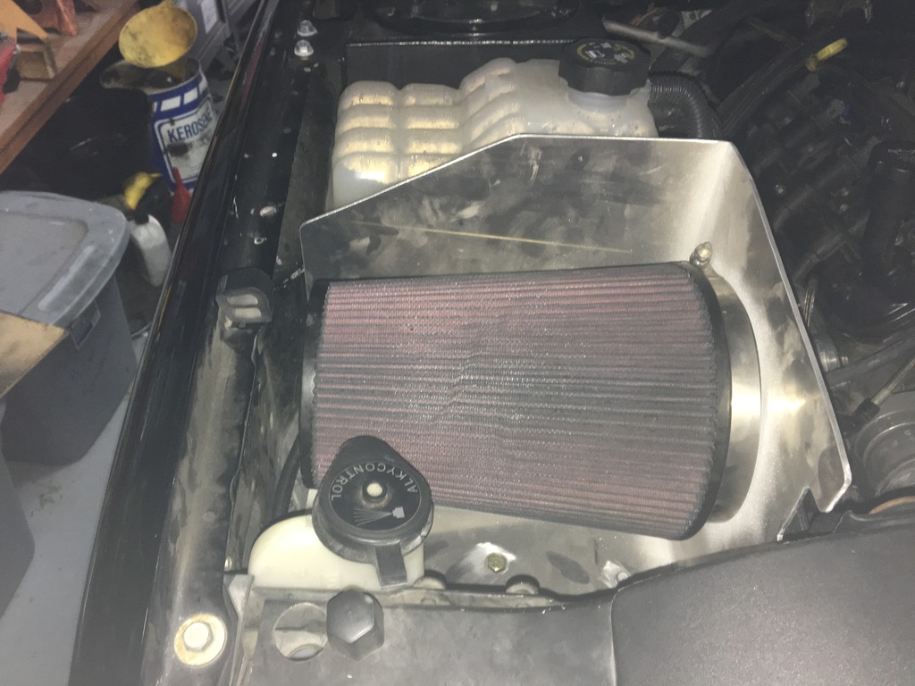

Looks alot like my Cold Air Inductions setup....
Do you have some pics?

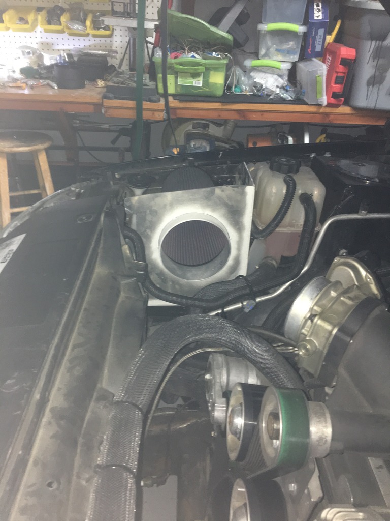

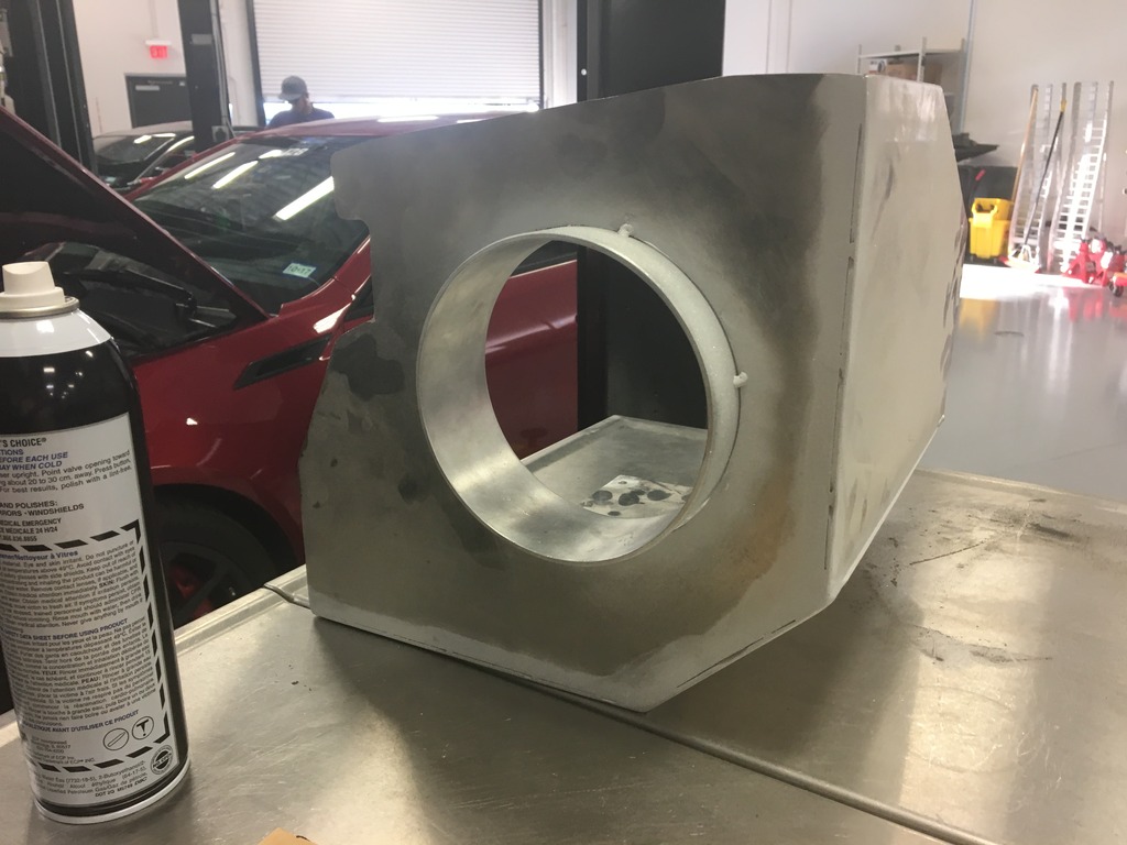

Tacked up.

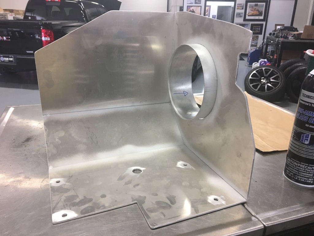

Looking spicy. What's the white stuff?

He sand blasted it allready in prepeartion for welding. He said it helps to get nice welds.

I need friends with aluminum fab skillz. looks good!

Fits good!

off topic, but that resi you've got for the meth, is that just another factory one?
And it fit perfectly in that location?
Yep pretty much. Not perffectly but close enough. It needed some triming and a bracket to hold it.
