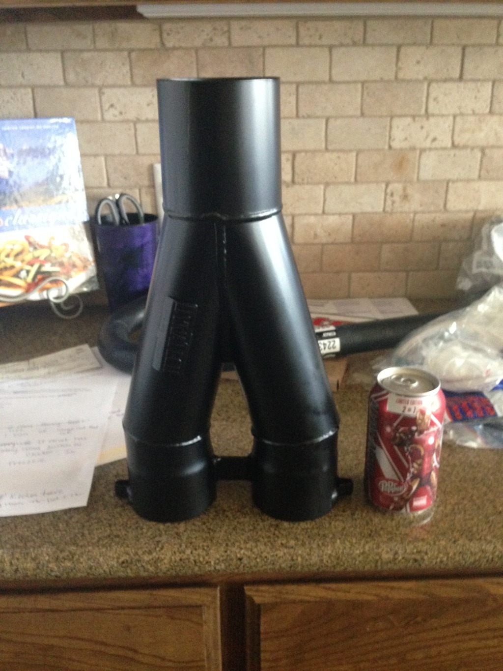

Exhaust part finally came in today.
Here is the ypipe. It is from Dynatech and it is freaking LONG!

Here is the basic way i plan on building it. It will run directly under the tranny the curve over. I gotta trim back alot of the pipes but you get the picture of it.

you're going to go under the trans with that? Won't it scrape the ground??

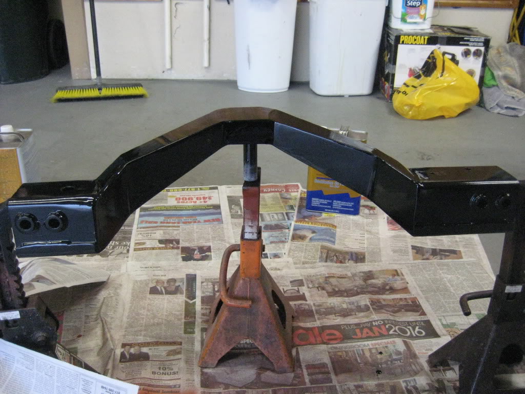

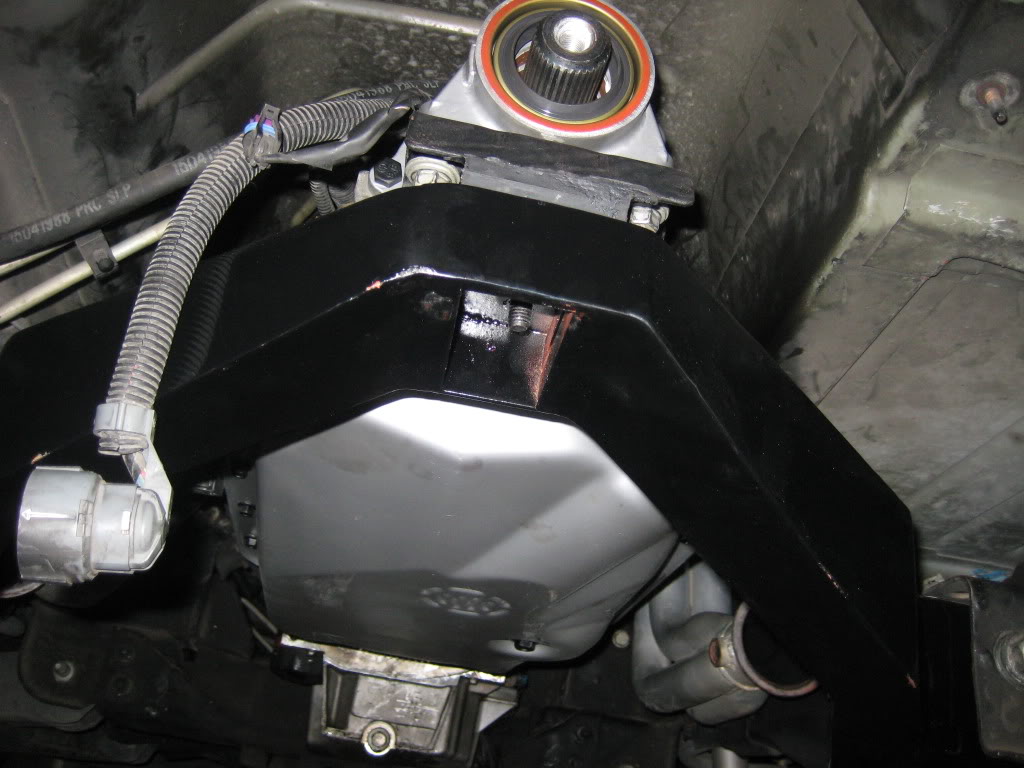

Nope. I have done it before. This is my tranny crossmember. I built it this way so i could run exhaust under it.
