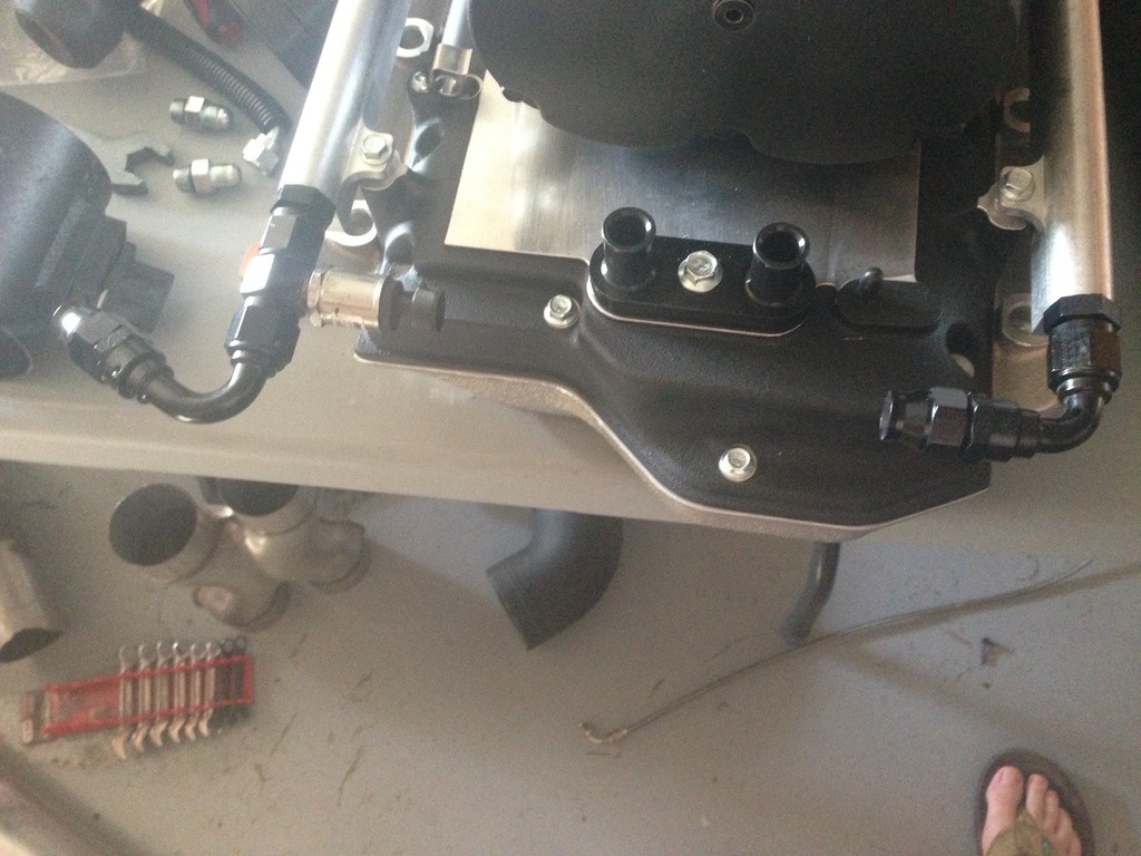

Here is how i plan to feed and return fuel also i will be hooking my FPR gauge right at the output of the rail. That is a 120* hose end on the left. I might need a 160*

All those AN fittings seem like overkill at the time but damn don't they make it nice taking things apart and putting it back together I fully intend on running everything I can in With AN fittings and hard lines/compression fittings if I ever build another one. So much cleaner, fewer leaks (none if done right) and it usually lasts a lot longer than regular rubber hose.
They are expensive, a PIA and expensive but IMO they are worth it to never have to worry about leaks.

Looks similar to mine, -8an 90 into pass rail and -6an 120 out of drivers rail to regulator. The fragola -6orb/-8an fitting can be drilled out to open it to -8 the whole way FYI.
