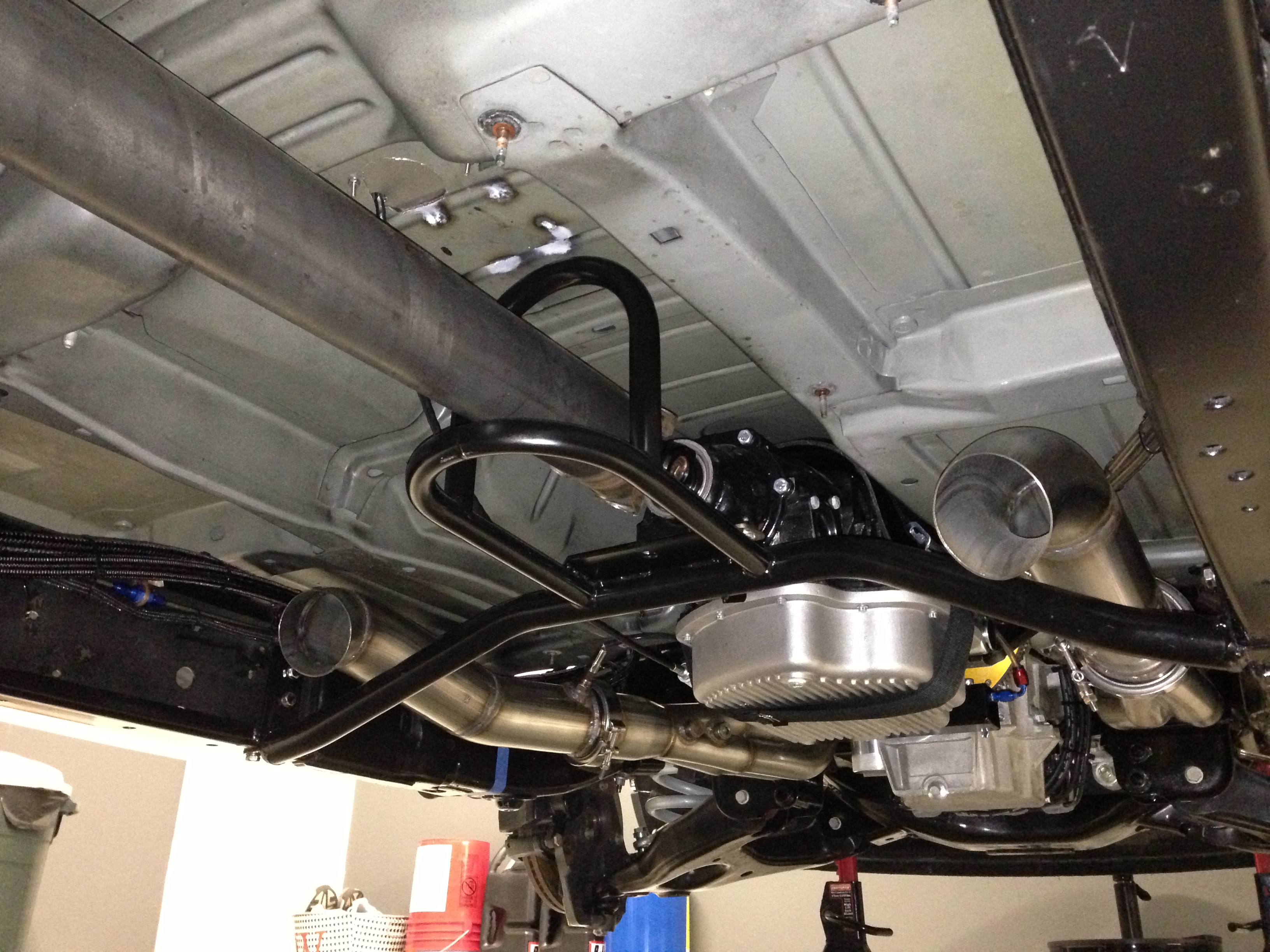

For yalls ideas........mine was made with running the exhaust over the crossmember. For reference that is 3.5" exhaust.

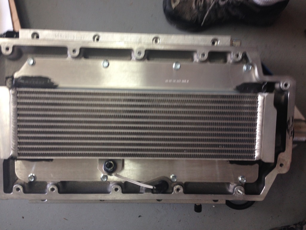

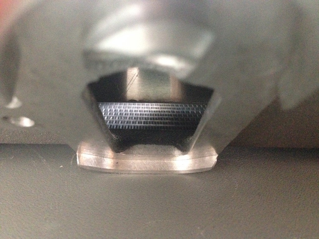

Besides cam swap part 2 today, i got the blower spacer put on.. That was pretty decent, it would be nice if the kit came with instructions but oh well...
so here is before the space, note how close the intercooler is to the bottom of the manifold.

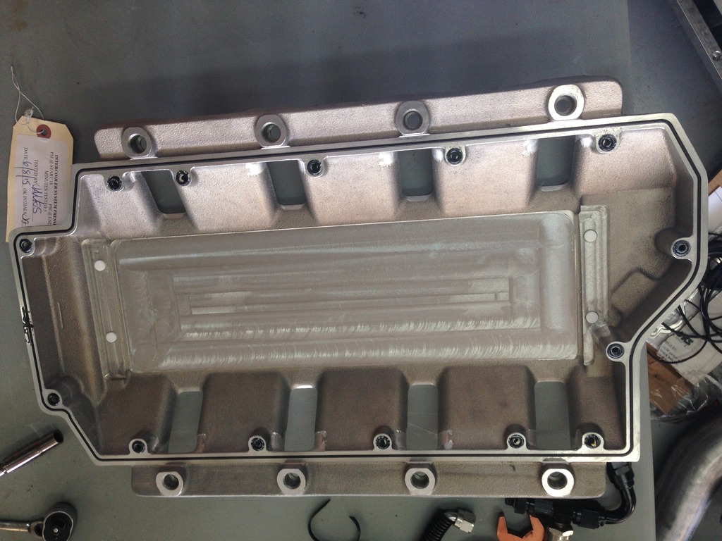

here is after the spacer

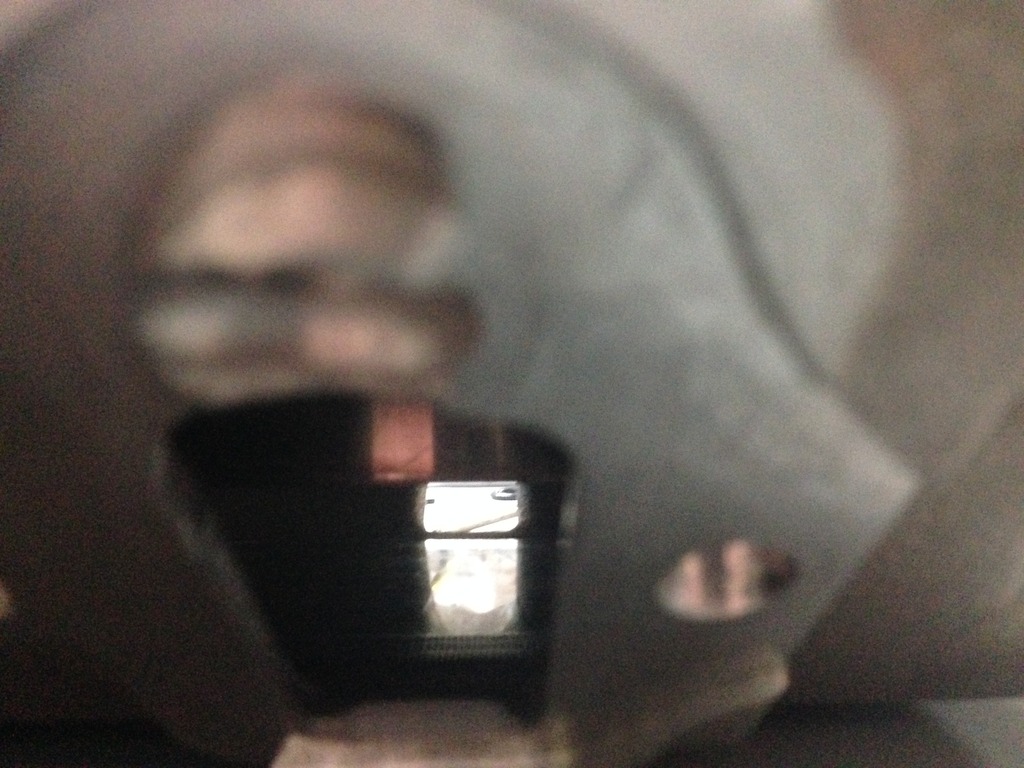

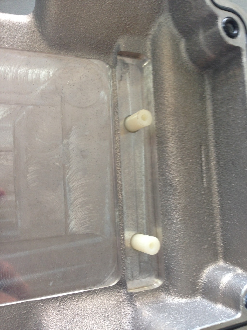

here are some pics of inside the blower

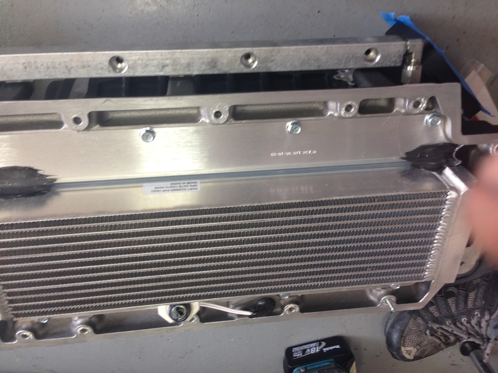

these little stand show how much the intercooler is raised.
finished product
