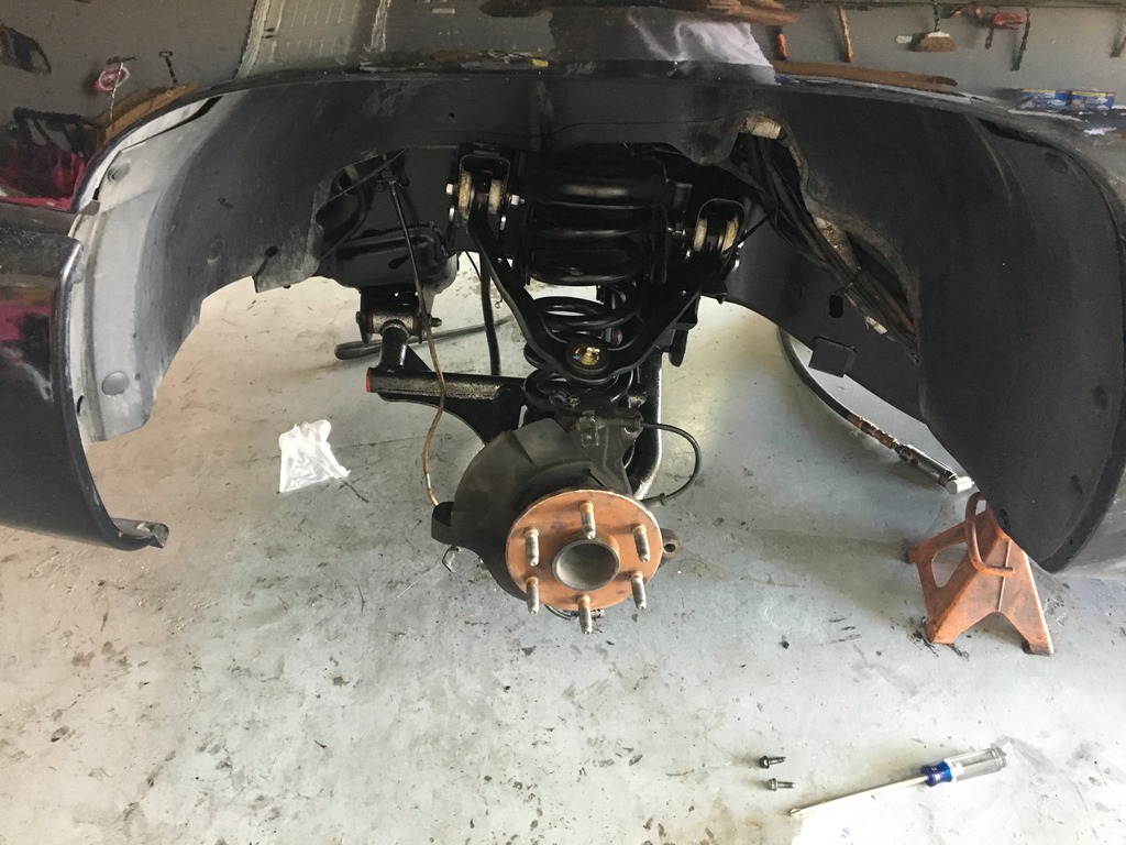

Half way done

Old Jul 2, 2016 | 12:51 PM
  #445
TXsilverado's Avatar
iTrader: (19)
Joined: Jan 2005
Posts: 18,364
Likes: 291
From: Humble Texas
aluminum control arms?
Old Jul 2, 2016 | 01:00 PM
  #446
BlackGMC's Avatar
Resident Retard
iTrader: (31)
Posts: 17,216
Likes: 20
From: Fort Worth - TX
No they are DJM with that crappy hammer tone powder coat
Old Jul 2, 2016 | 01:13 PM
  #447
GMCtrk's Avatar
iTrader: (27)
Posts: 12,275
Likes: 19
From: Dallas
Did you let your master run dry??
Old Jul 2, 2016 | 01:35 PM
  #448
BlackGMC's Avatar
Resident Retard
iTrader: (31)
Posts: 17,216
Likes: 20
I just disconnected the brake lines so ya probably

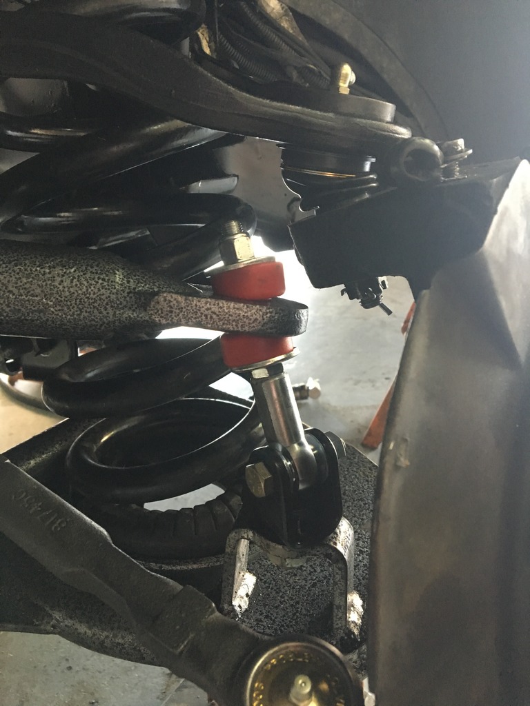

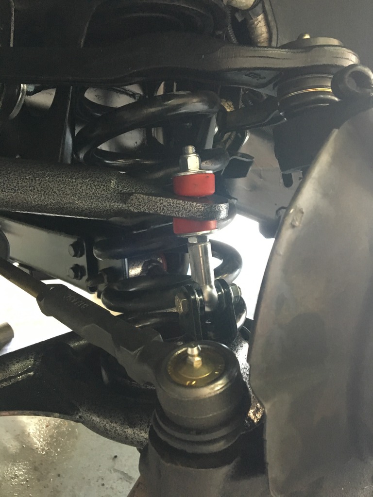

New Hellwig 1-7/16 sway bar fits pretty good. I went ahead and put on Energy Suspension greaseable poly bushings.
Sooo new end links
At ride height.
All the way extended
Old Jul 3, 2016 | 10:46 PM
  #450
Steve-O-08's Avatar
Joined: Oct 2009
Posts: 991
From: West Jordan, UT
I just put a set of those ball joints in my DJM arms. The ball joints that they cam with were junk. Also ran those links too, mine didn't hold up too long unfortunately... I was pushing the truck pretty hard when I bent them though. The angle of the link mount on the control arm isn't the greatest.
