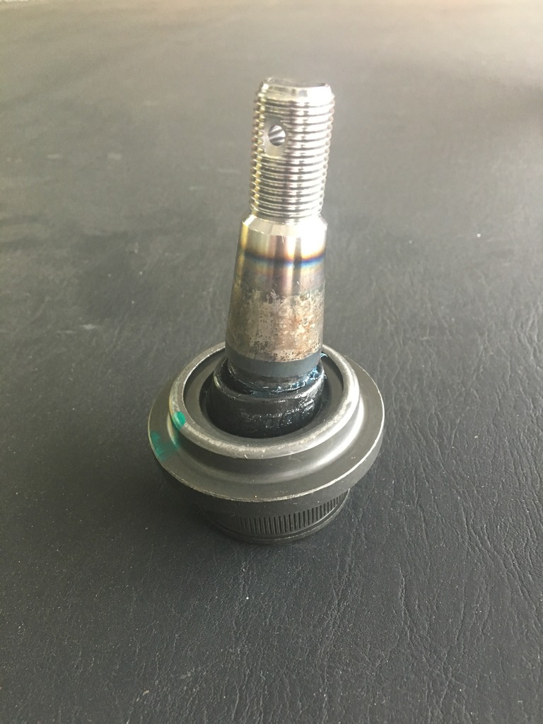

the new lower ball joints are kinda cool, i think. they have an intergrated grease boot. my old ones the boost never fit right and i could see the damn joint..

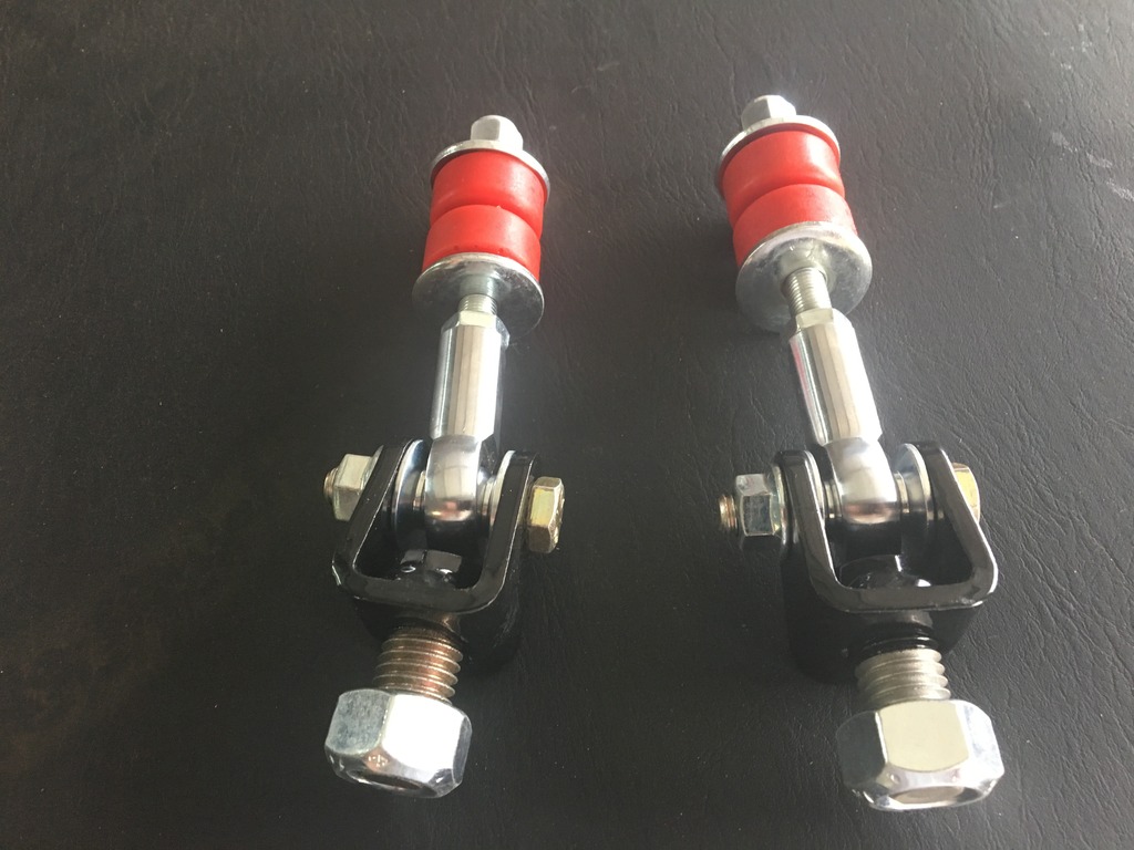

Also i am gonna try these sway bar endlinks. They look kinda cool and if you have ever raised your truck then lowered it with a jack the endlinks move ALOT

Damn those endlinks are sick. You might need the cams in addition to the offset bushings, I know I did and my truck is not lowered as much.

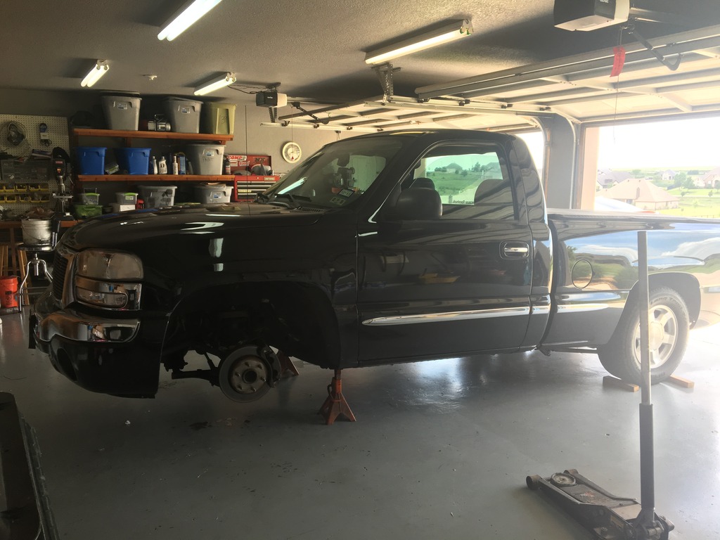

Truck is in the assumed position

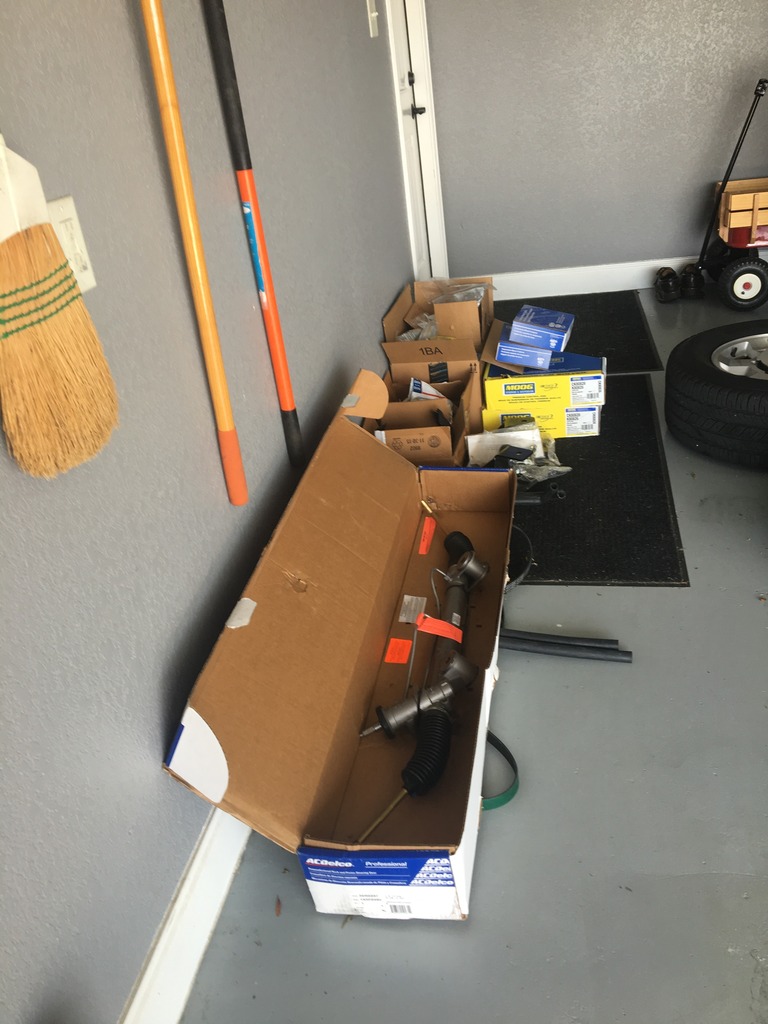

Pile of parts

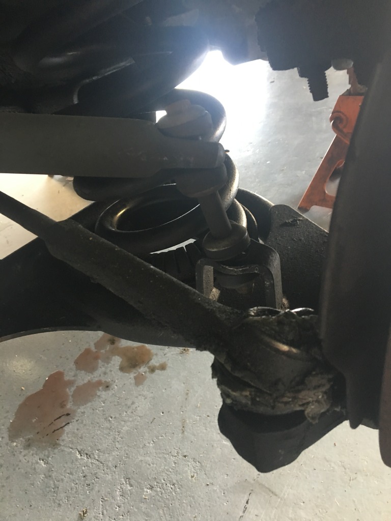

This is the reason for the new frint endlinks. At full extension they are really angled. At ride height they are straight up
