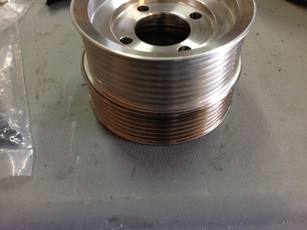

This is going on next. 3.2 pulley. I should see 11-12psi with it. I am gonna add more meth and more timing Then 3.0 pulley will be on order soon probably.

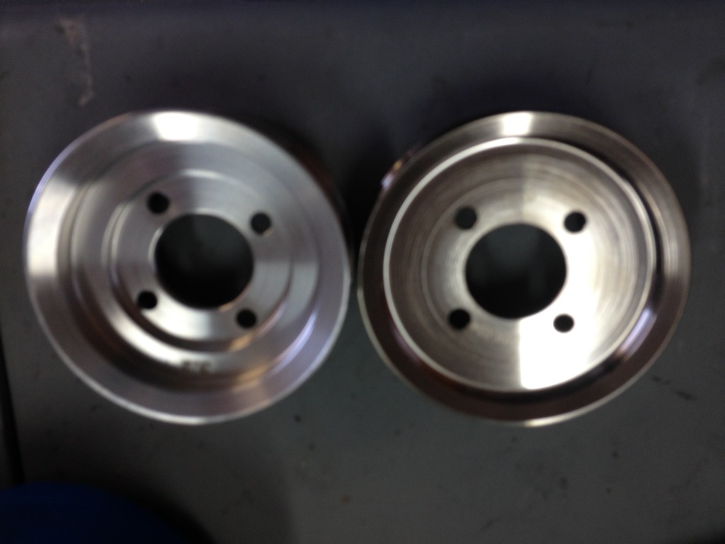

3.4 vs 3.2.

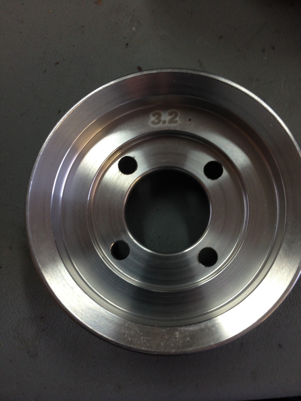

Crazy how little difference between the 2 but that little difference is worth 2psi.

I just said screw the shoulder. 3.2 pulley installed

So i was ae to sneak out to the store to see what the 3.2 pulley would do. I will be damned if that wasnt the funnest time i have ever had in the truck. This **** just plants the tires and freaking goes! The turbo never ever hit this hard nor pulled this hard. The tires are starting to complain. They wimpered a few times. As long as it was a flat road they just freaking hooked. The truck was hitting 10-11 psi in first just freaking moving. I did kick it sideways once on a downshift into first ******* with a charger. That kinda got the heart pumping and puckered the botthole a little.
Anyways i am gonna stick with the 3.2 pulley for awhile until i get comfortable with the new TQ curve.
I wi get some videos soon. All of this was in 95-100* outside temps tooo. I can wait for winter.
