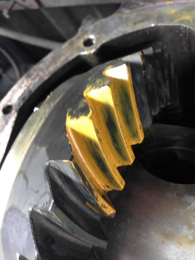

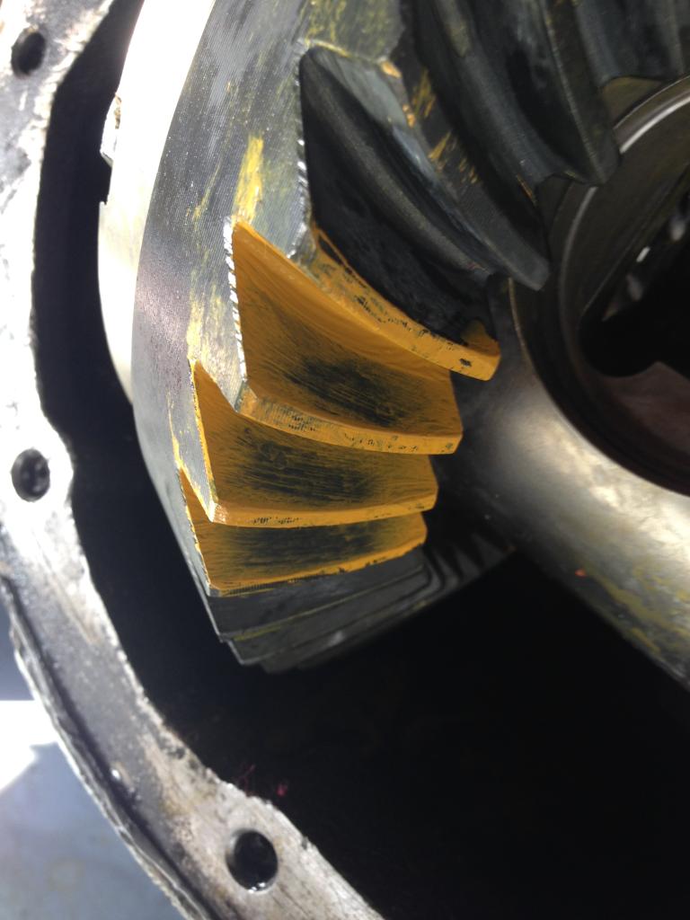

I got the backlash set to .006.
Anyone want to comment on my gear pattern?

695
oakley6575
Dec 2010
5,235
Las Vegas, NV
Pattern looks fine to me. I would run backlash a little looser but thats just me.

silver-mod-o
Hunt&Fisherator
Nov 2005
14,314
17
SETx
Not bad for a window licker!!!
Nice to see you saved the yellow crayon for the gears... I'm sure the others were eaten promptly.

Quote:
Originally Posted by
silver-mod-o
Yeah i only saved the final one. All the previous one were horrible.
