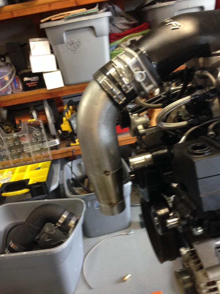

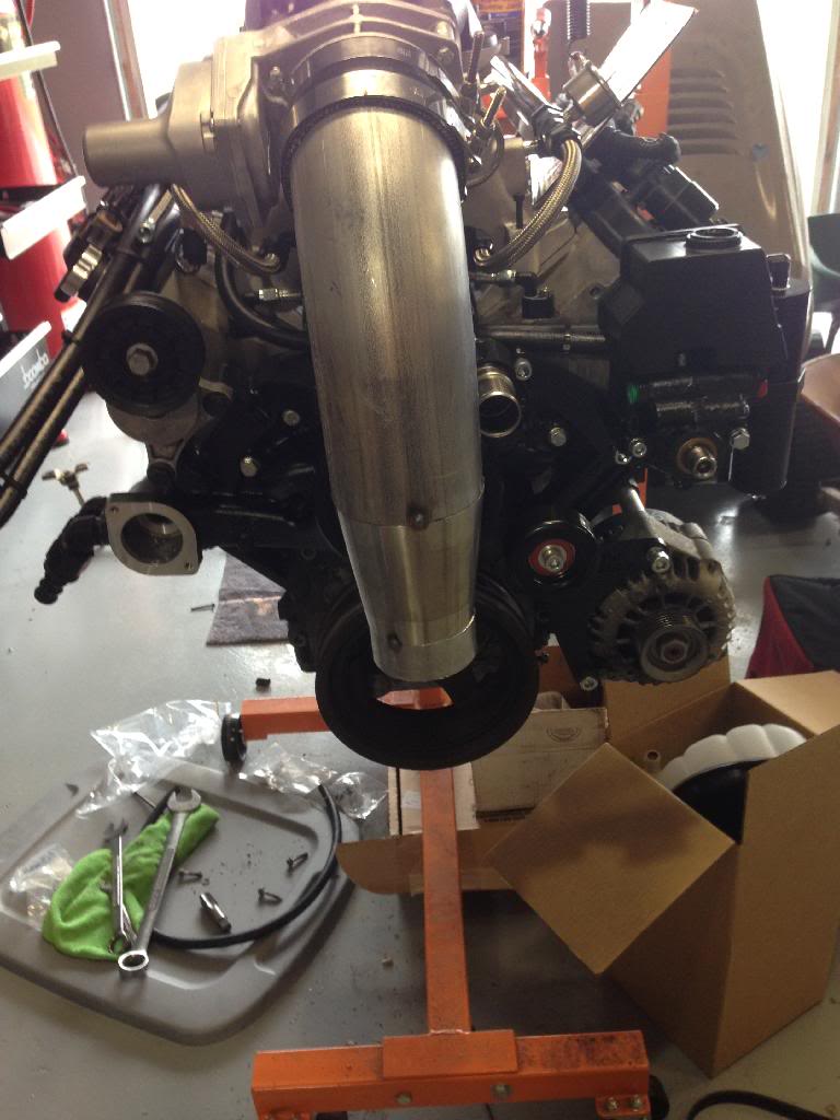

I finished up the mockup of the new pipe going to the TB.

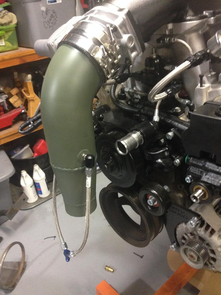

The pipe is all welded up. Bungs for the meth nozzles and iat sensor all burned into the pipe. I need to get some shorter lines for the nozzles. Those are 10inches. The smallest pre-made ones i can find are 6inches. I have not choosen the color yet so it is just plain self-etching primer on there now. I still need to rolls some beads into the pipe ends but i will save that for another day.

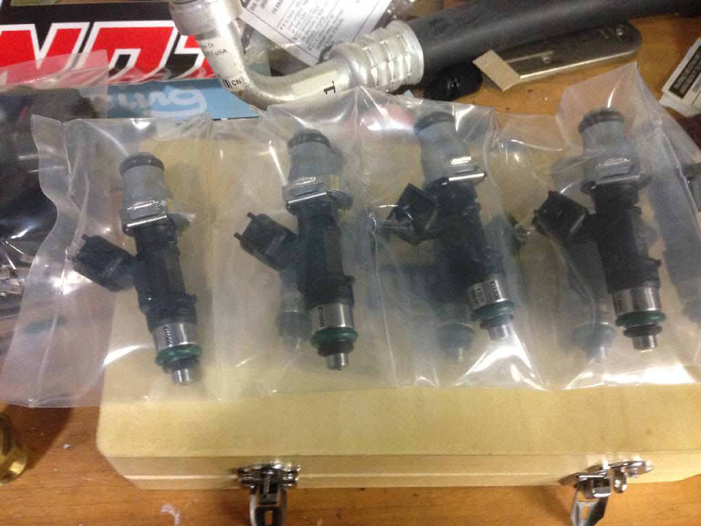

I picked up a set of ID1000s today . Just another piece of the puzzle.

Who did you buy the ID's from. I'm thinking about the ID1300 E85 injectors

A local guy i know that runs a shop. Dynosaur.
Never thought I'd say this about injectors, but those are sexy !!
I've heard a lot of good things about ID injectors, please keep us posted on them and how you like them.
