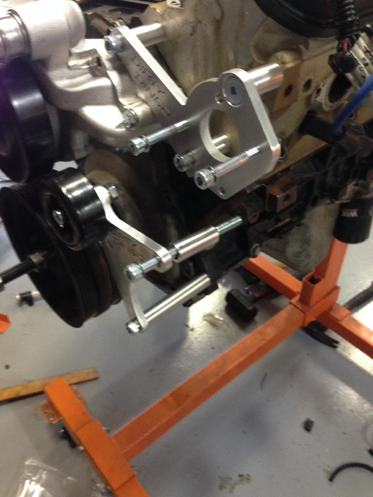

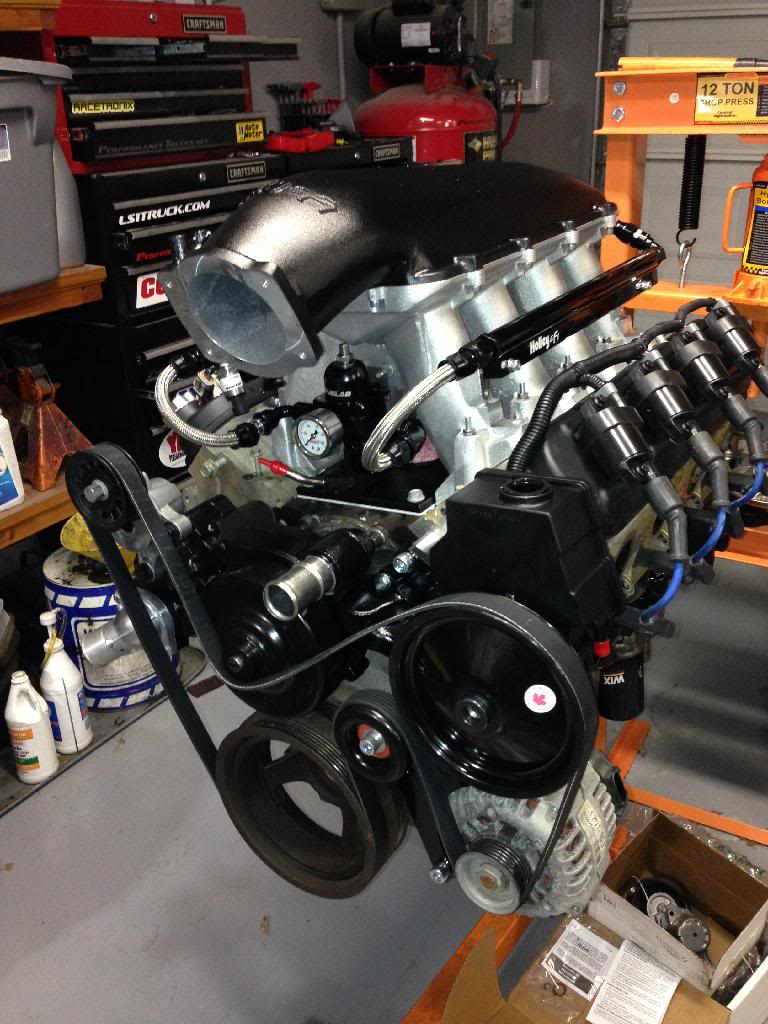

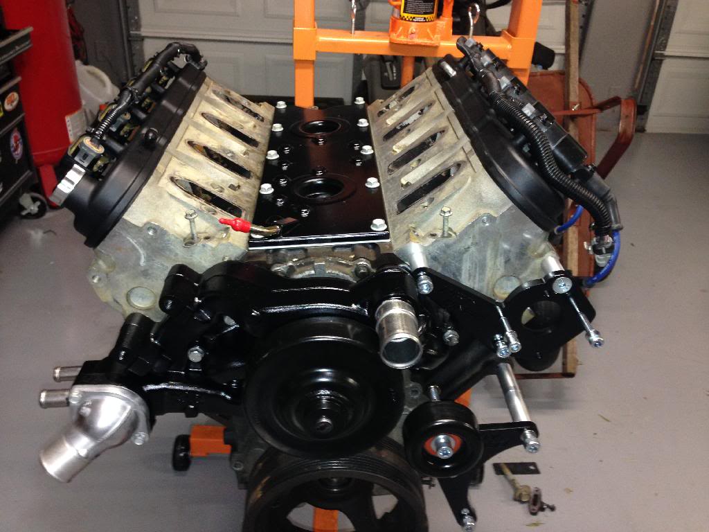

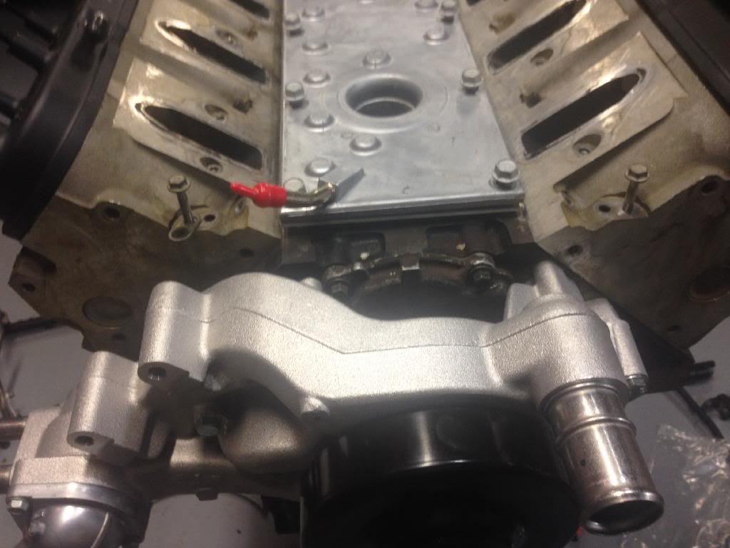

I figured it was time to update this thread since parts are here. I decided to switch over to a camaro style front belt drive. I ordered some brackets from dirty dingo. I got a camaro power steering bracket and alternator bracket i got them with the truck offset. I also ordered a 2010 camaro water pump and tensioner. I also got a ls6 valley cover so i can redo my pcv

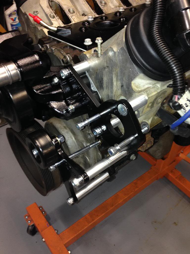

All painted

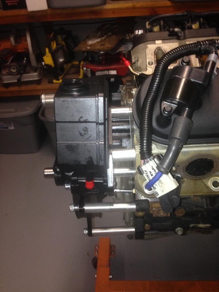

Camarp power steering pump

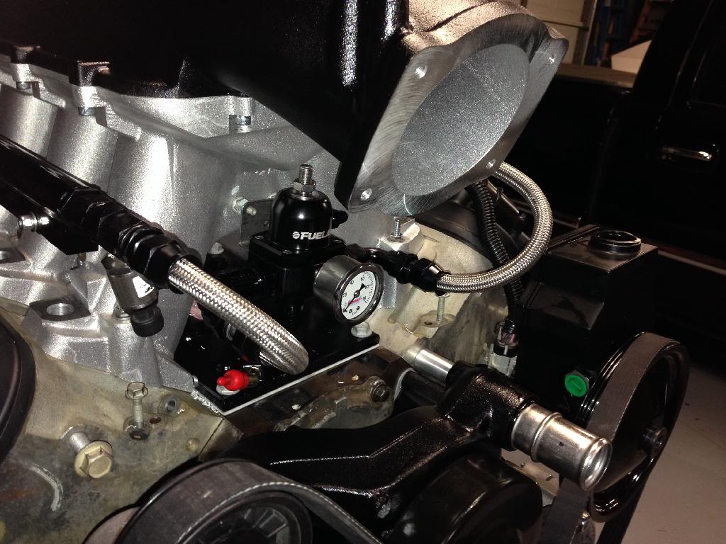

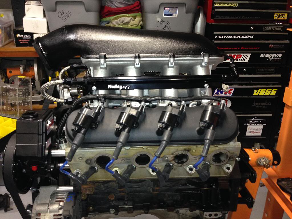

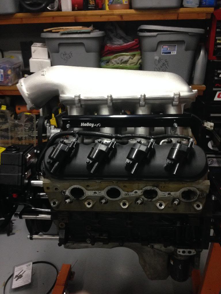

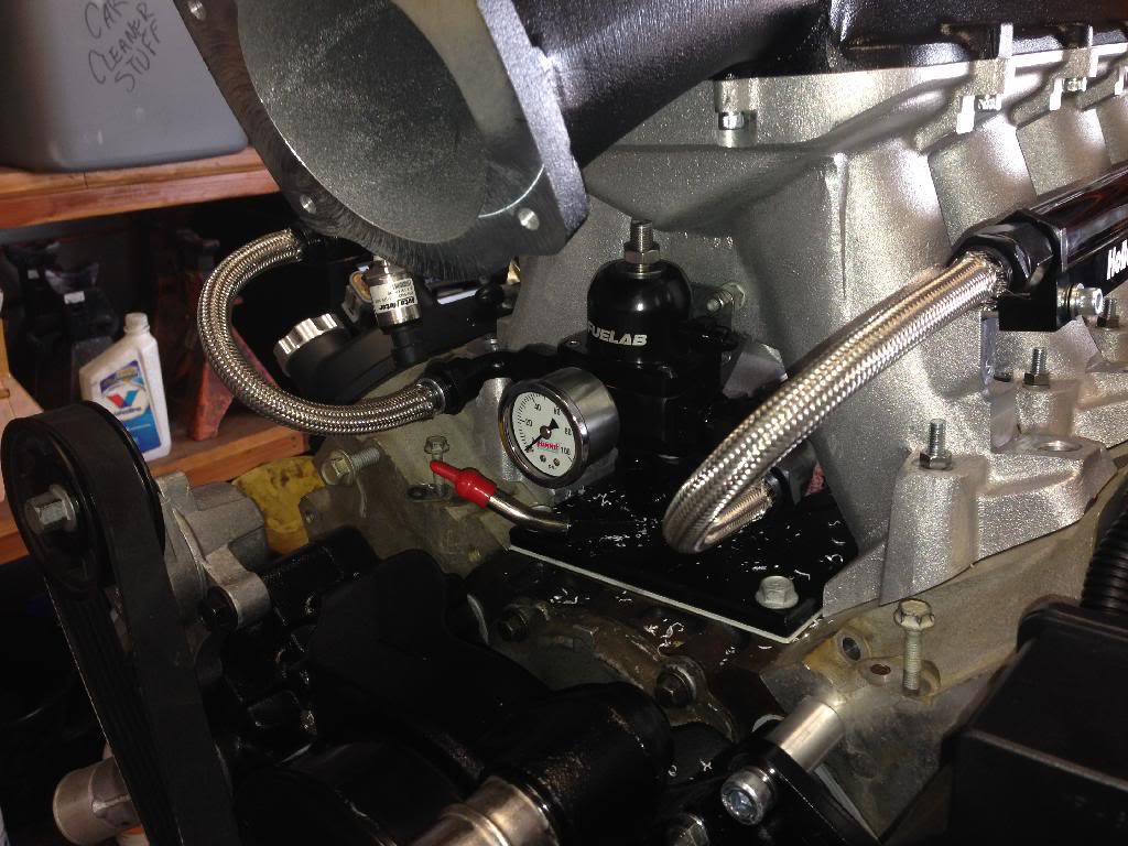

Next i got the Holley hi-rise and a new Fuelab FPR
I did not like the bare finish soo i painted just the top. I know some dislike the two-tone but i kinda like it. Also i mounted my FPR below the intake and mocked up the fuel lines. These are teflon lined braided steel. One nice thing about using telfon line is they bend tight without collapsing.
