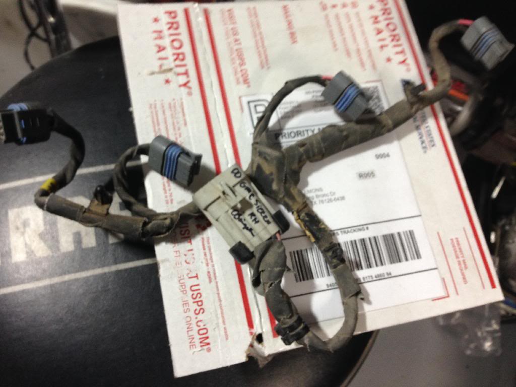

I started working on the coil wiring today
Standard harness

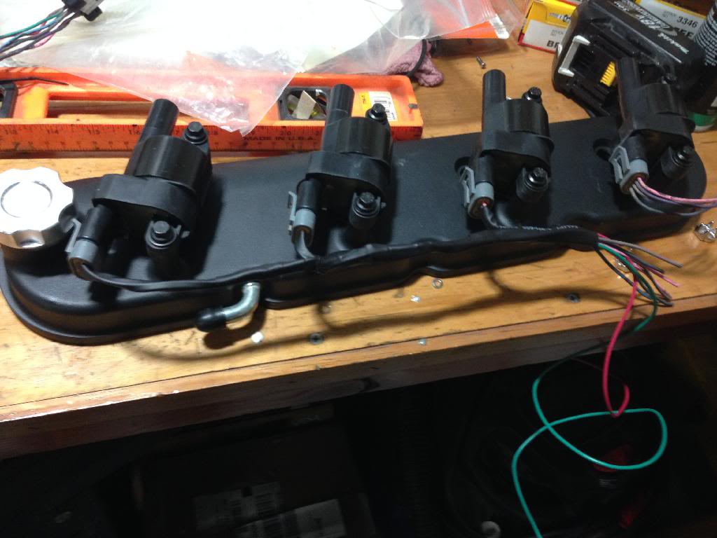

Cut up

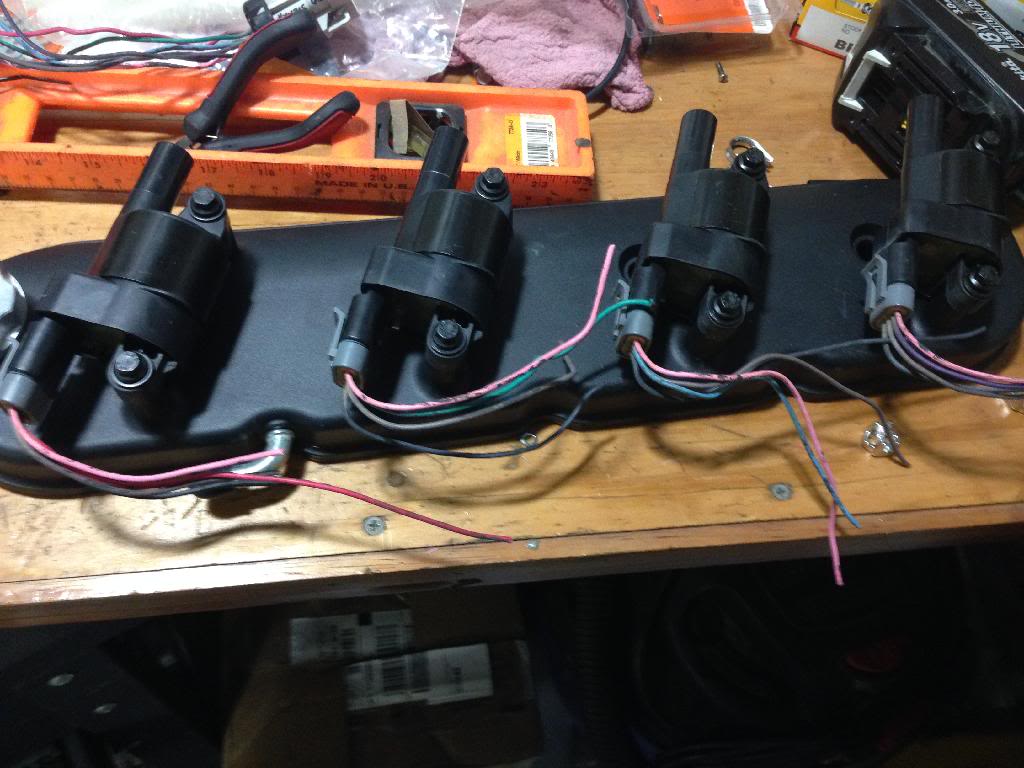

Almost done. Everything soddered and wrapped in heatshrink. What a pain in the ***.
