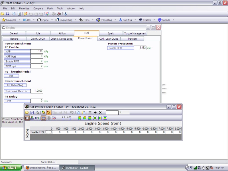

Setting it up like this should pretty much make it hit PE only when I am at about 3lb of boost. I forwarded this info to the shop so see what he thinks.

makes sense the way Area47 breaks it down...
mine is set at 45% tsp. doesn't do **** for kicking in at 45%. still kicks in at wot.
one parameter must be met before another can be activated. in a sense. even if you set the kpa trigger to 40, it still wont kick in until the tps requirement is met, and the pe delay trigger is met.
if the tps is set to zero it voids this table. if the pe delay is zero, it voids this table. if map kpa is set to 110 kpa, or somewhere above 100, it will use this trigger regardless of tps. using tps as a trigger is a null idea in my eyes on an FI setup. tps% varies gear to gear. 30% in first is not the same load as 30% in 6th. one is in boost, one is not. by setting the kpa trigger to something above 100, this is the final number it will use. 3 psi trigger in first is the same trigger in 6th.

Ya makes sense to me. Once we get into tuning we will try it and see how it reacts

I would want it to hit PE before you get to 3lb. I like to be in PE at 85-90 ish and at 105 my boost enrich table takes over. Granted you are not 2bar but still, I would want more fuel before it hits 3psi. Just MO

Ya not sure the best spot to have it come in at. With the way above it's easy to change though. I think I will look into a 2 bar setup also. Will get with Roger on that.

How much fuel you need as you roll into boost is dependent on where MBT is for your particular setup. If you can maintain a reasonable amount of timing getting into boost, you'll make more power. But you'll need more fuel to do it. Thats for pump gas, things change a bit with alcohol.
