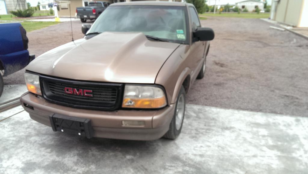

Well havent really had time to post some updates. Here are some crappy phone pics. Running on 11 psi of boost right now. Tune still needs some work. Im in the process of making some better hot side and i need to really really clean up the engine bay. Looks like crap. Also, an ls1 intake is going on soon. Ford 8.8 rear end is already under there. Need to take some pics of that too.
Any questions or comments, go ahead!
