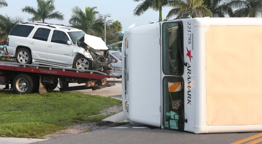

Definitely doable. I actually have the lowering kit from my 05 Yukon Denali that met an untimely death due to 15000 lb Stepvan that decided to pull out in front of it. Caught it right in front of the rear wheels. As it drove over the front of the Denali, it rolled itself over on its side. So she didn't die in vein. The Stepvan didn't make it either...
If/when you're ready, I may still have it. Just LMK.
