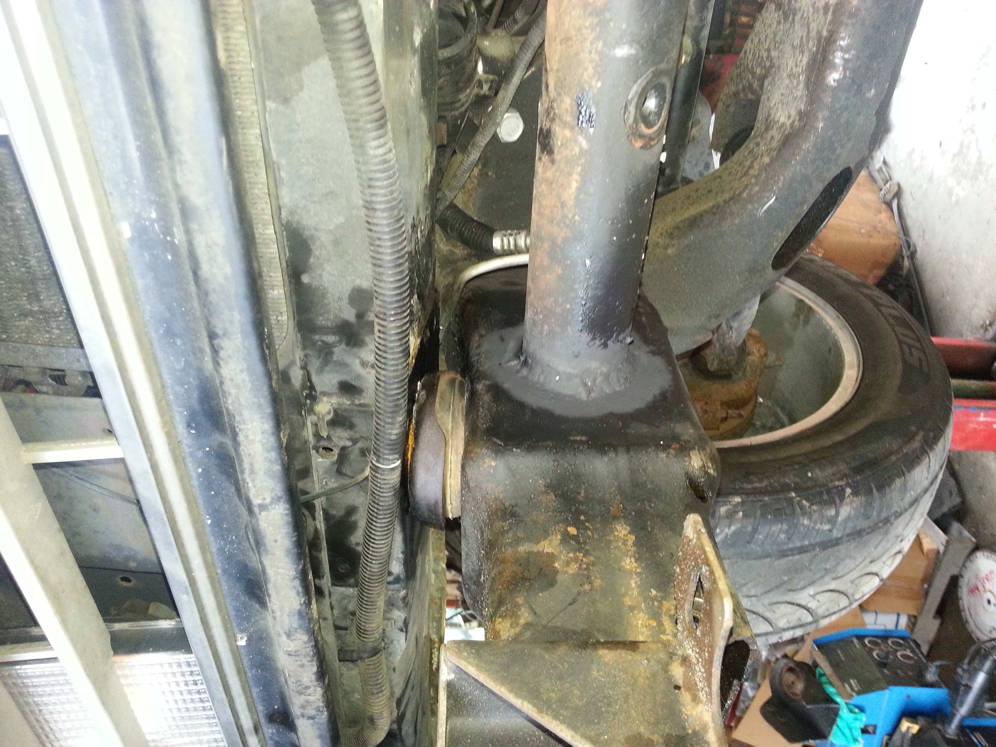

Anyway, this weekend we mainly tckled the cab mounts and height over the frame. We had get the bed leveled so we knew where the cab had to end up. We wanted the core support cab mounts the end up centered on the front frame rails. Had to remove the front crosspipe that went all the way trough the frame rail. Here is a shot after the cross pipe was cut inside and out and the piece driven out of the frame then welded back. Ended up rosette welding a flanged nut inside the core support for these mounts

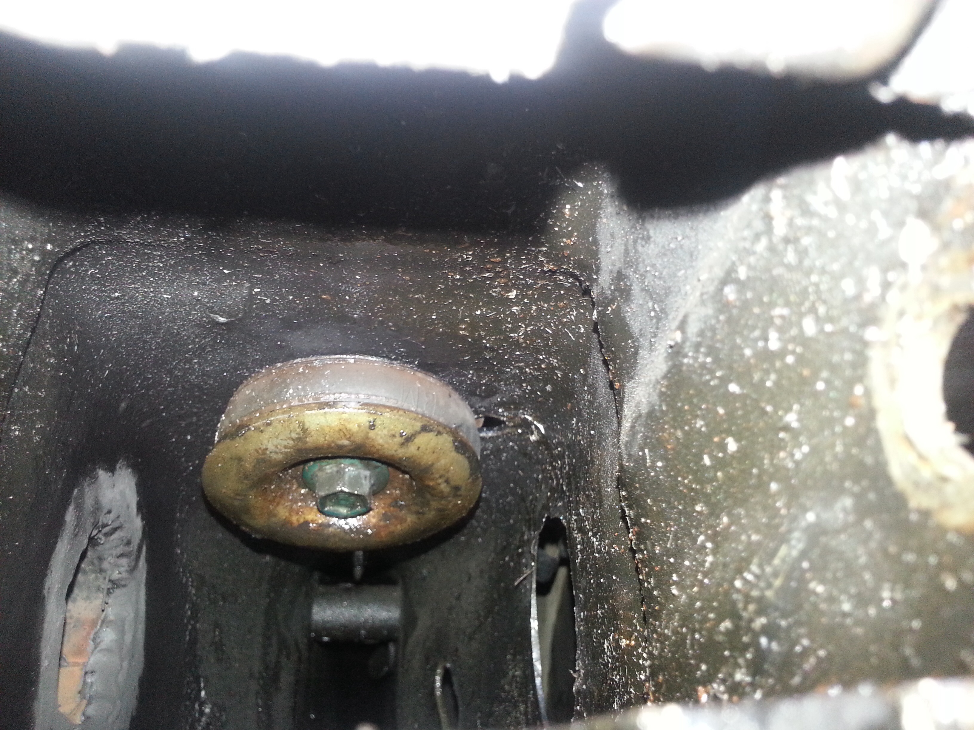

Here is the lower side of the mount inside the frame rail.
