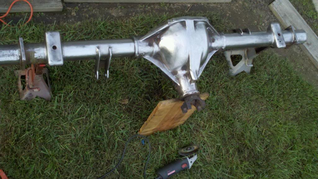

This is after quite a few hours with a flap wheel, cutting wheel, and wire wheel. Still more to go. Sharpshooter and I will be moving the spring perches this weekend, and installing 4.11 yukon gears with an eaton posi.

The 88-98 perch to perch distance is about 2 inches narrower than the 99+
Do you plan on moving the shock mounts?
