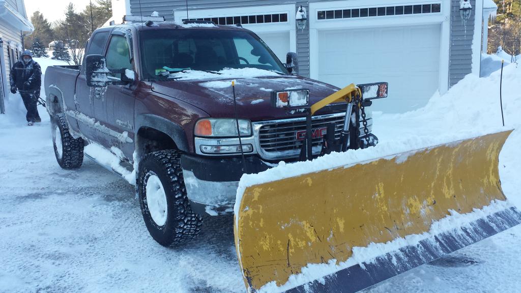

Havent changed anything on the setup really, I got a detroit trutrac for christmas and thats in there now. The oil seal on the exhaust side of the turbo is letting go, you can smell the burning oil and it smokes at idle lightly. When spring comes Im planning on getting the On3 78/76.
Im goin to college in Vermont and the truck couldnt be happier up here, nothing gets the IATs colder than when its -5 up here lol
Plowed with the truck for the first time and it pushes snow like a diesel. Only issue is I have to careful about the plow angle while driving or else the temp starts climbing
