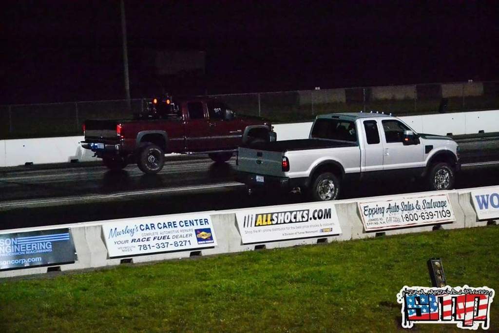

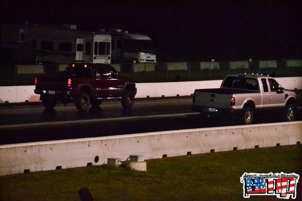

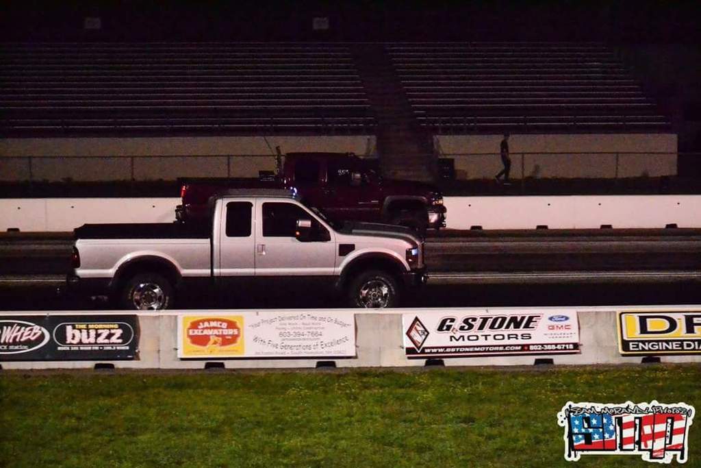

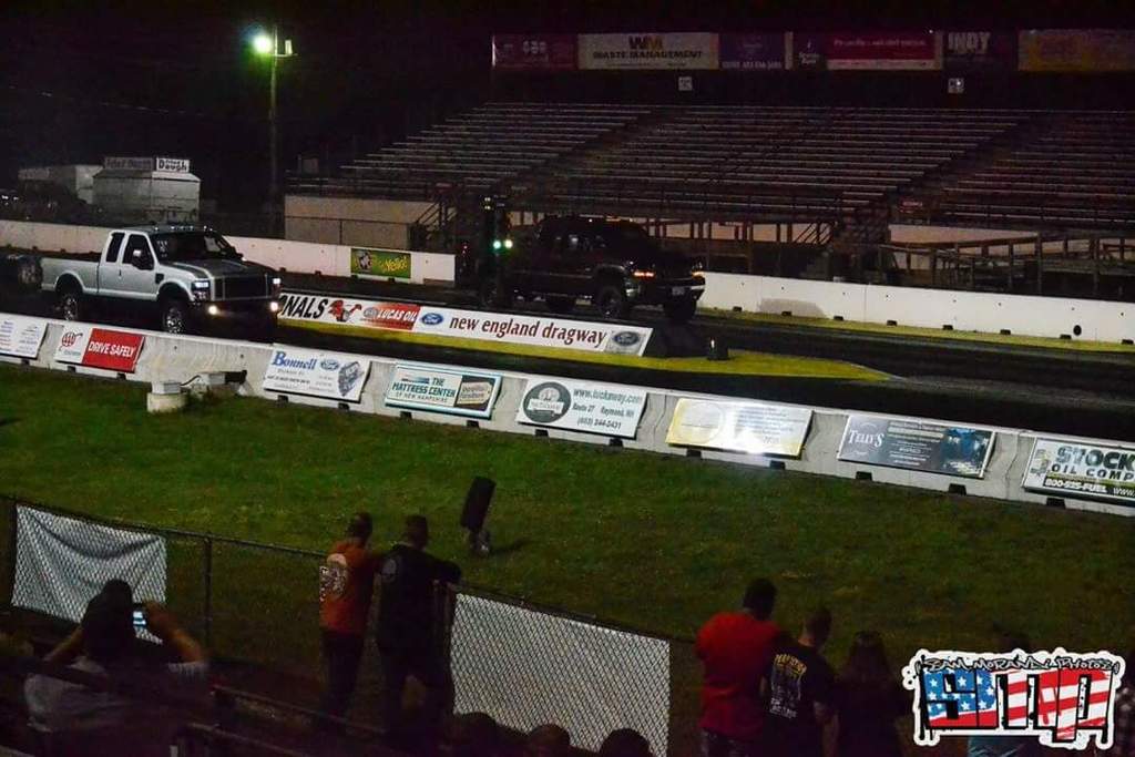

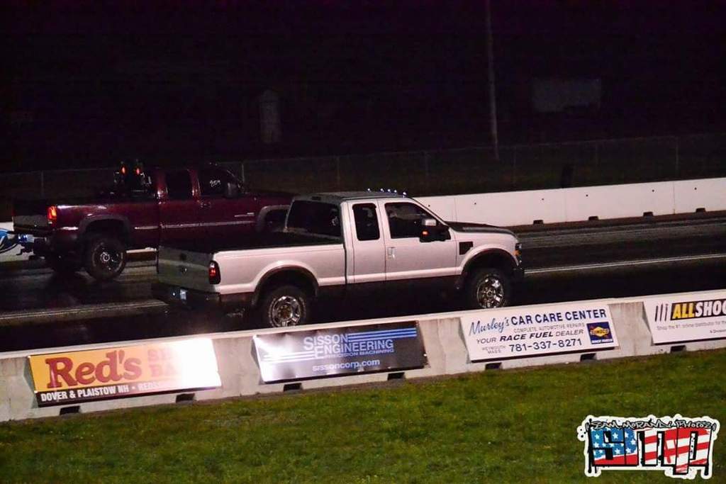

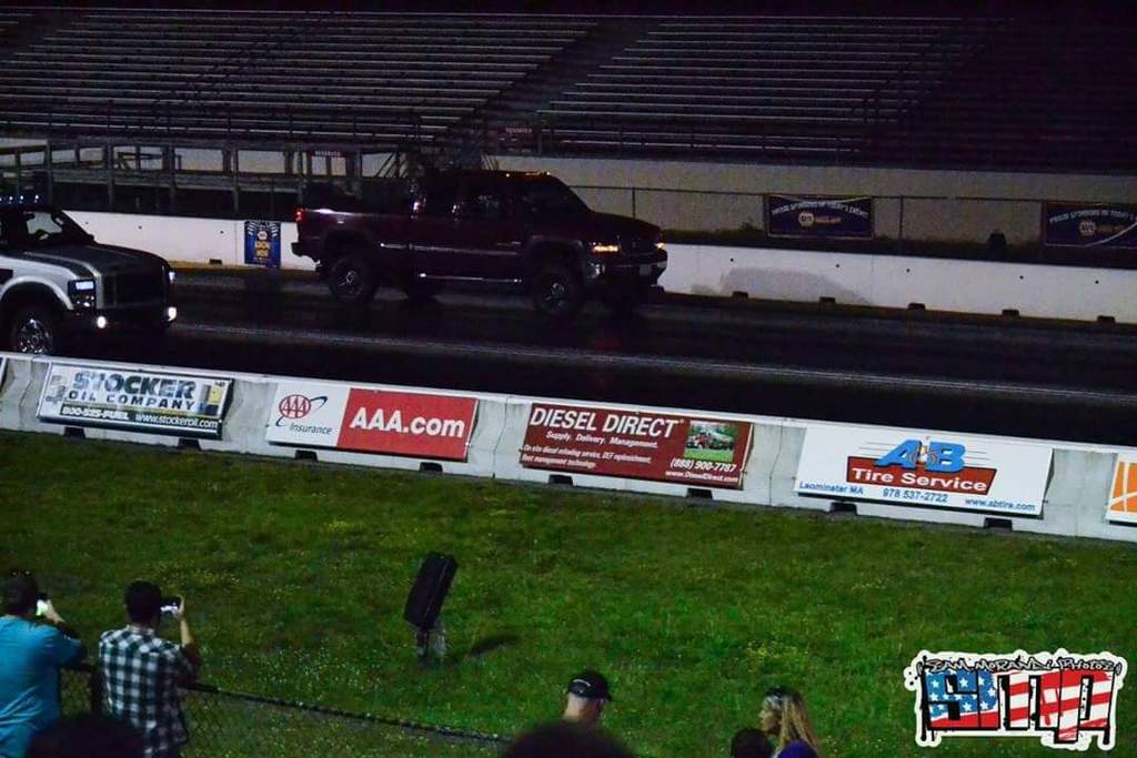

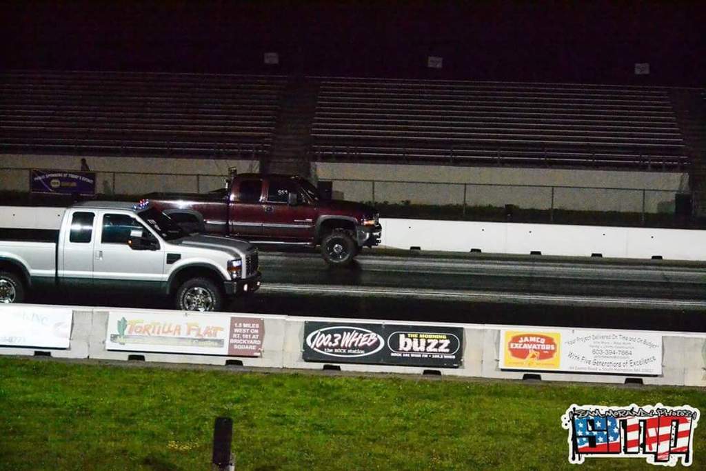

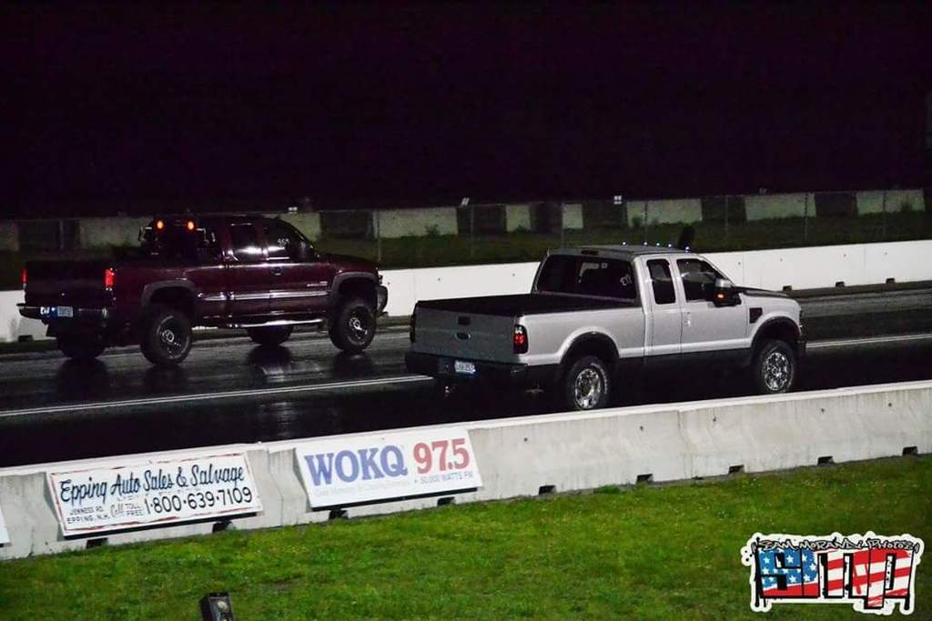

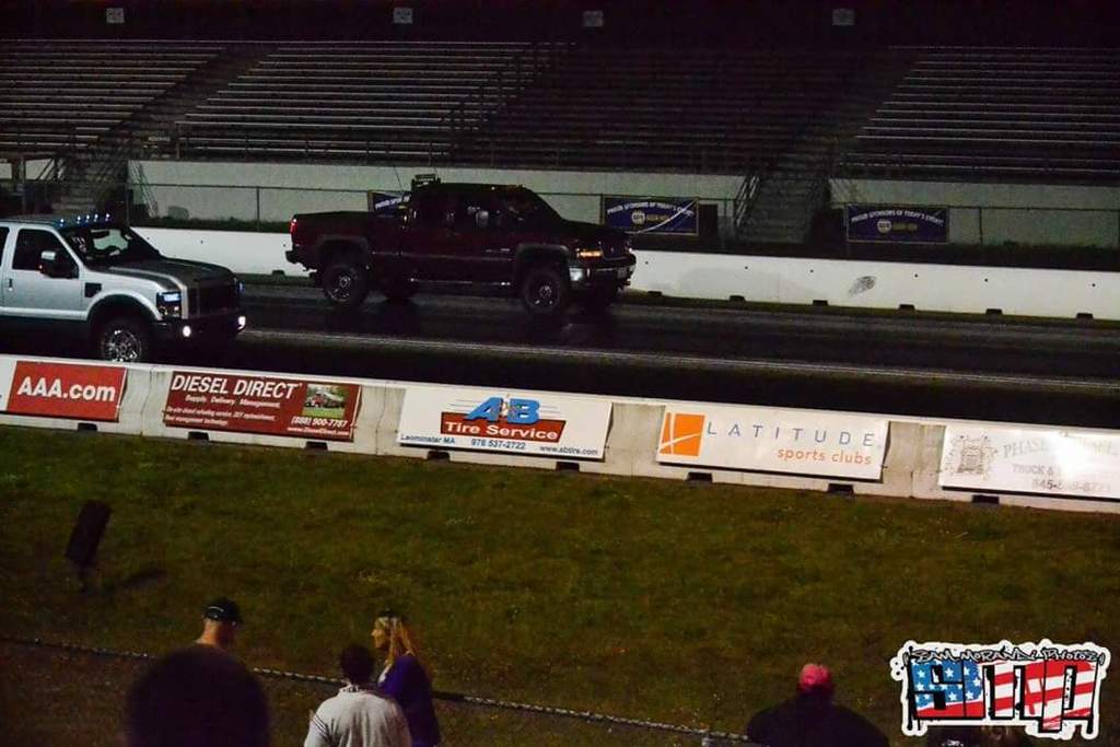

So I went to the track for the third time last night, got there wicked late cause I convoyed up with some buddies but at least I got some use out of the two runs. I have an OBD adapter for an app on my phone so I could see my IATs cause I was wondering how bad they were. At the end of the track they got to 155 and 158... Don told me when he tuned it he had the timing fall off at 150, which makes sense why the truck doesnt pull good at the top end. So until I do something about that I have a feeling my truck isnt going to go any faster...
I know I should get meth and itll help alot but I dont really want to drop that kind of money right now, I mean I dont want to drop any money right now since I leave for college in a month and Im not gonna be making money for a while. But a 4" intercooler is $200 and I was going to get a 3rd gen cummins trans cooler to mount behind it. The trams cooler is roughly if not bigger than a tru cool 40k but is cheaper.
Is that gonna knock down my IATs a decent amount or is meth the only good way? I know plenty of guys run it but it kinda sketches me out that if the pump fails lets say that the motor would be toast. Correct me if im wrong but I thought you have to lean it out to the point that without meth the tune would too lean.
Heres some pictures a friend of mine took, I was pulling on this 6.4 until the top end
And the track was wicked bad, Im fairly certain I spun the front tires a little bit when I launched both times
