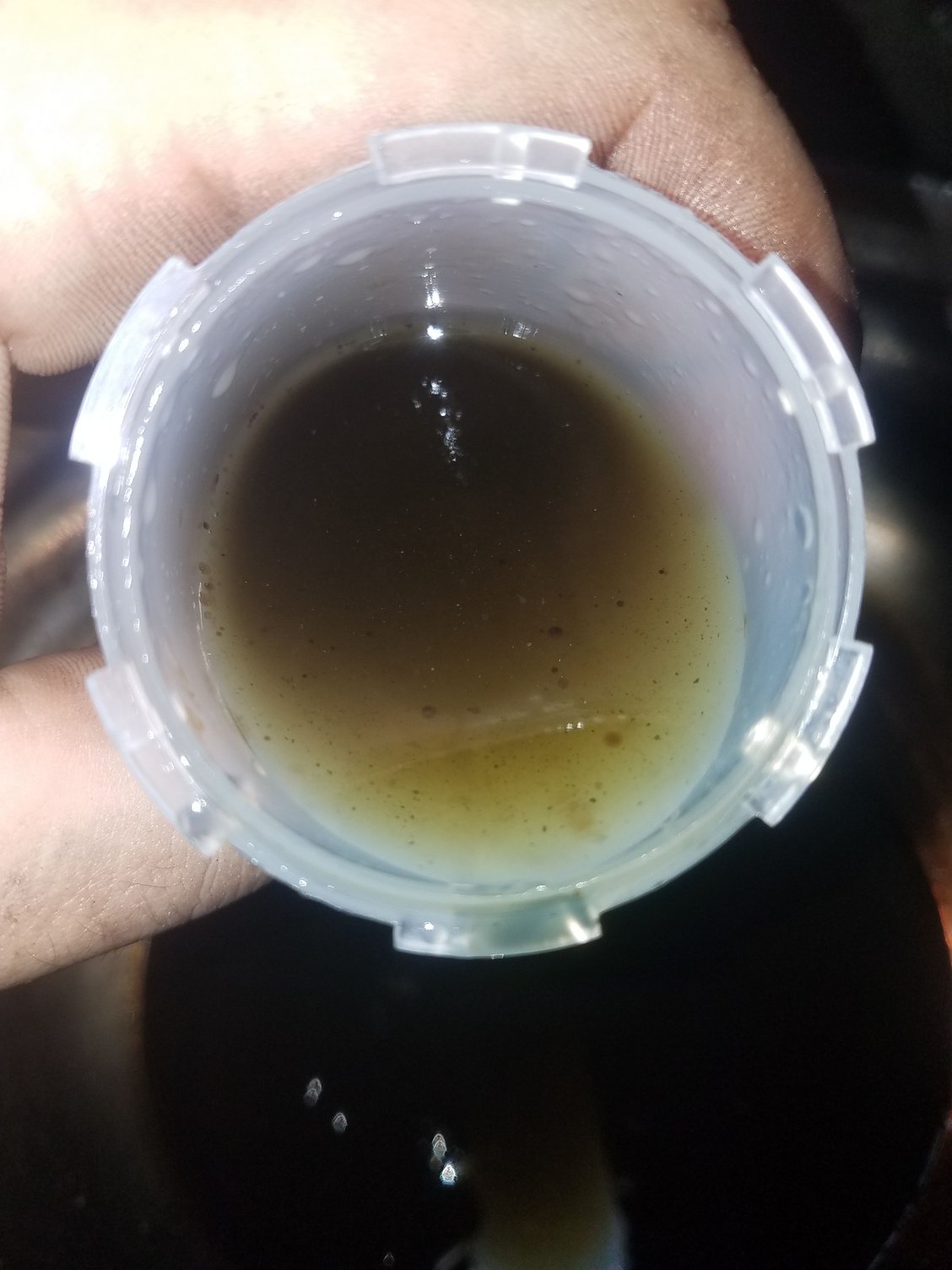

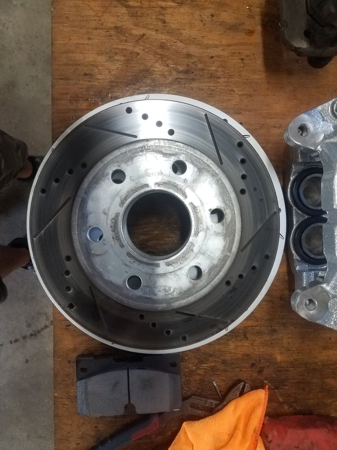

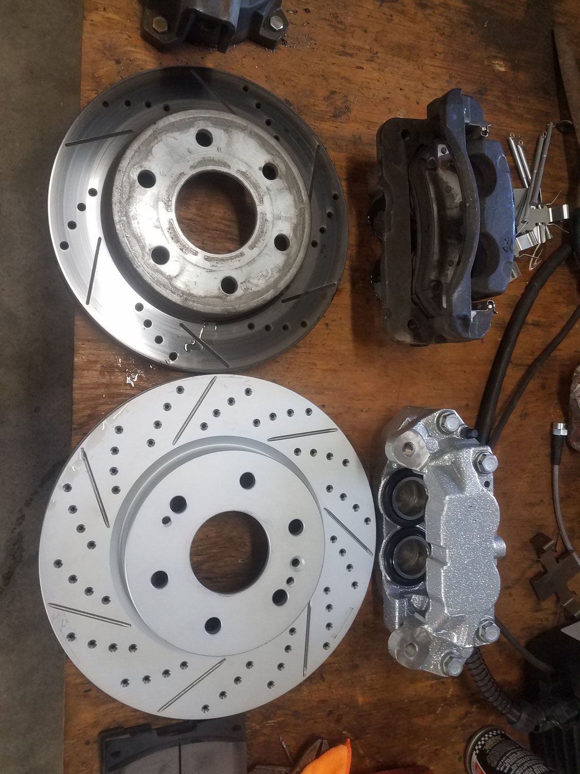

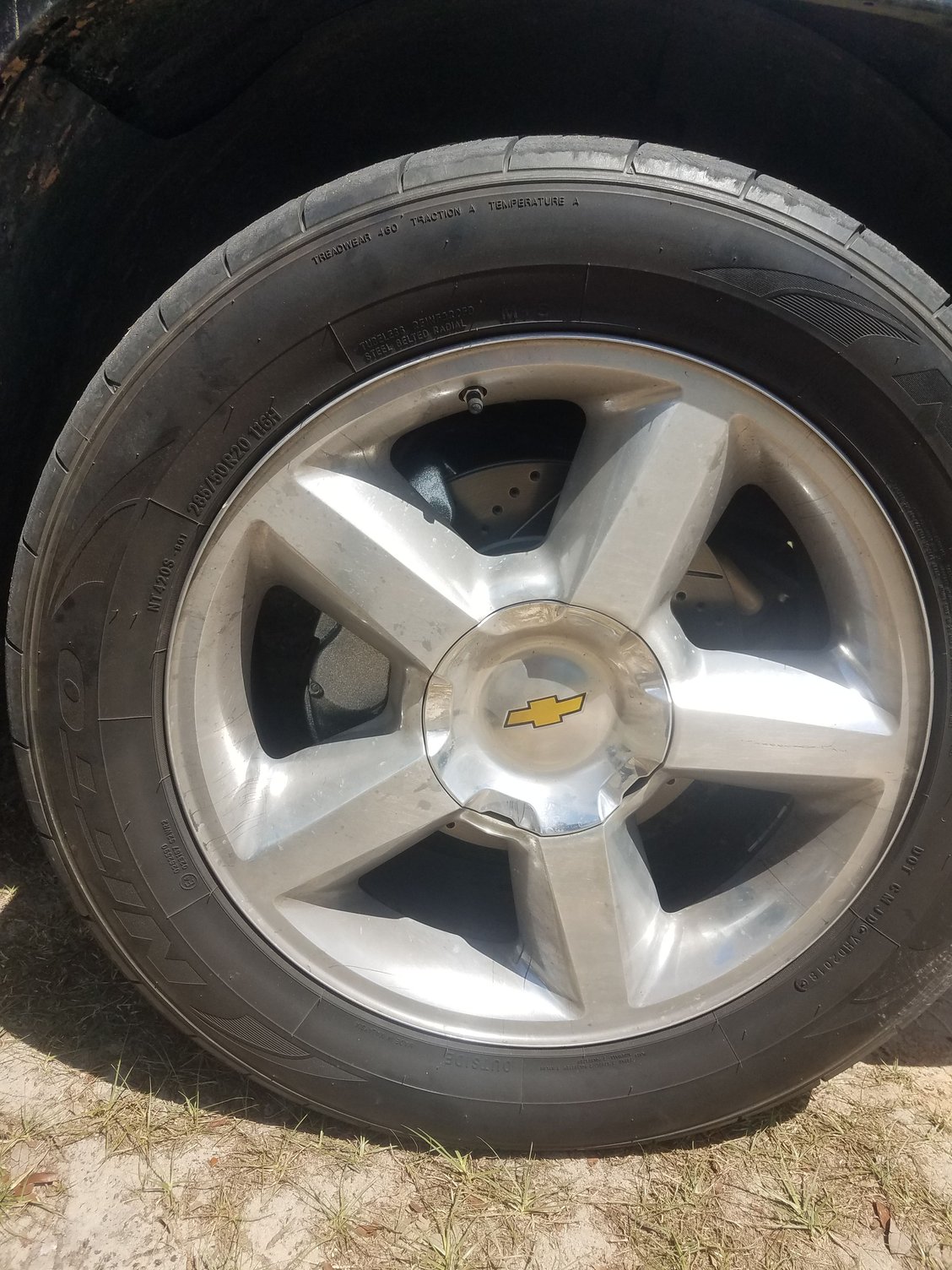

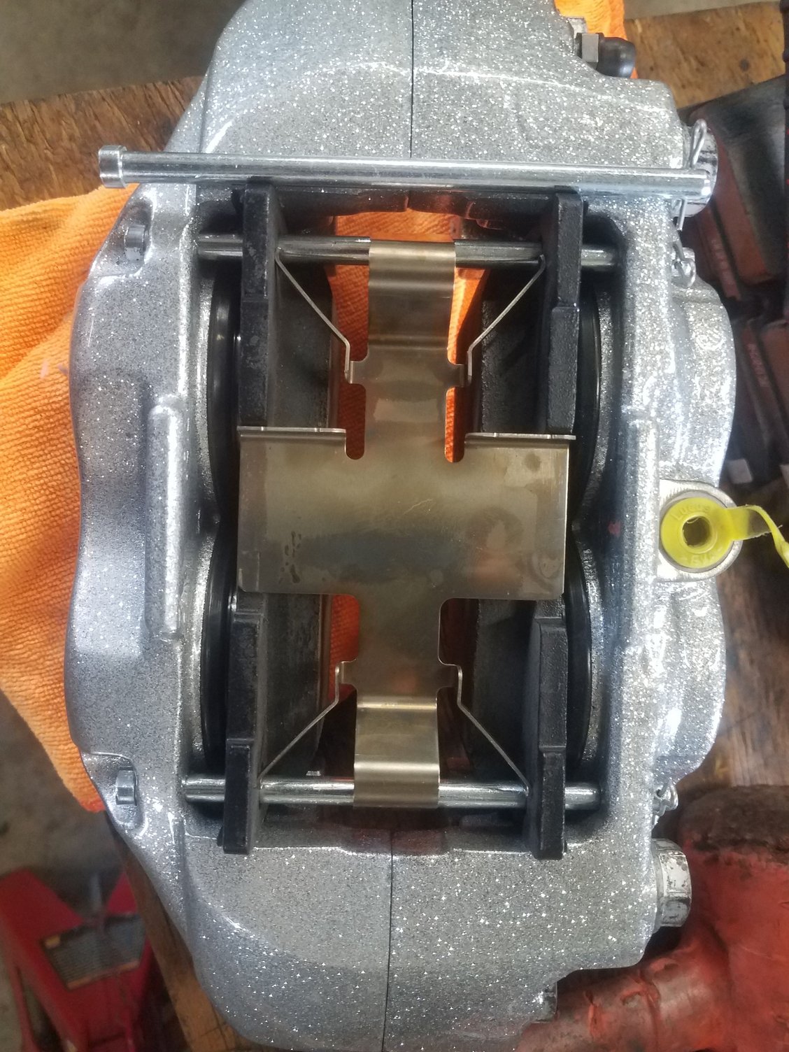

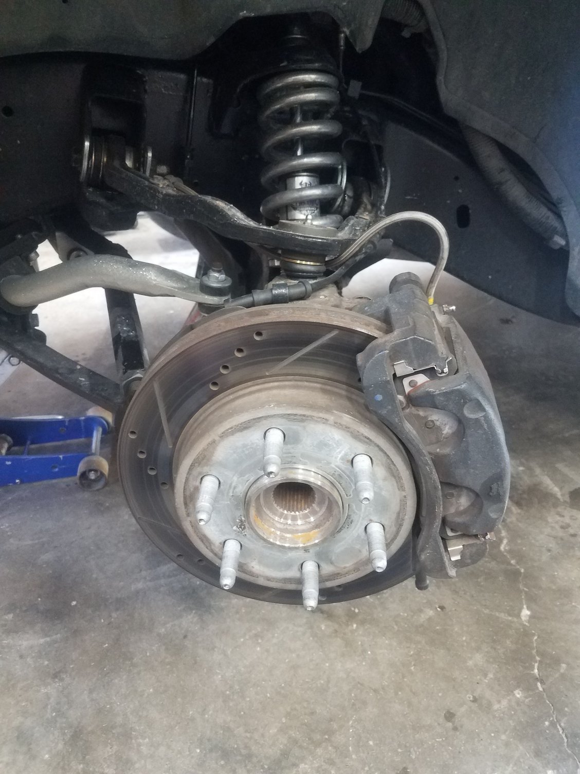

Finished my 2020 4 piston brake swap, it's just like doing normal brakes except you need a washer between the caliper and spindle, nothing real complicated unless maybe your IQ is under 70. Due to that, Squatted truck owners beware this may not be the swap for you.
Additional things to note are that the pads and clips are easier to assemble since they just slide in and the clip sits on the back held in by some spring tabs and 2 large pins with codder keys. Lastly, I would be extra diligent to use Loctite and torque the caliper mounting bolts down properly since the washer takes up some extra space and may limit thread engagement. Come to think of it a lock washer might not be a terrible idea.
Driving impressions: These brakes will not feel like you typed in a cheat code to your braking system. I don't feel that they helped the pedal feel any even though I bled 6 bottles through my braking system to clean out the black gunk in the master. No fault to these calipers but I'm fairly certain my "Mildly mushy" pedal is due to the 267k mile hydroboost master cylinder being worn out like my ex. The good news is that during hard braking the ABS activates much quicker than before which should mean the brakes are now overpowering the available traction. It seems to me that with the previous brakes the weakness in the system was the brakes themselves and that the tires had more than enough grip on a dry warm asphalt road to stop with minimal if any ABS intrusion. Now as soon as the pedal is fully depressed the ABS starts its voodoo to try and keep the tires from locking up and will throw all the **** piled up on the passenger seat into the glove box without remorse. The best part of the swap is not that they may or may not be contributing to a minor decrease in stopping distance but, that they look dope as fuh. I mean come on high-end looking calipers for a few dollars more than factory replacement stuff, like a sore dick, you can't beat it. I should also mention that you can beat it with sore ballz #Vasectomygang.

So would you say that swap is better or worse than the previous NNBS or whatever it was we were doing before?

It's a mild improvement, I believe the previous brakes were NNBS 13" rotors and a power stop kit and I had no issue with them besides the fact the brake pedal never felt as good as my RCSB after the hydroboost swap. It was still better than nearly every other GM 1/2ton I've driven but not as touchy as my Silverado. In short, it's an upgrade but I wouldn't do it expecting super brakes because that just doesn't exist.
