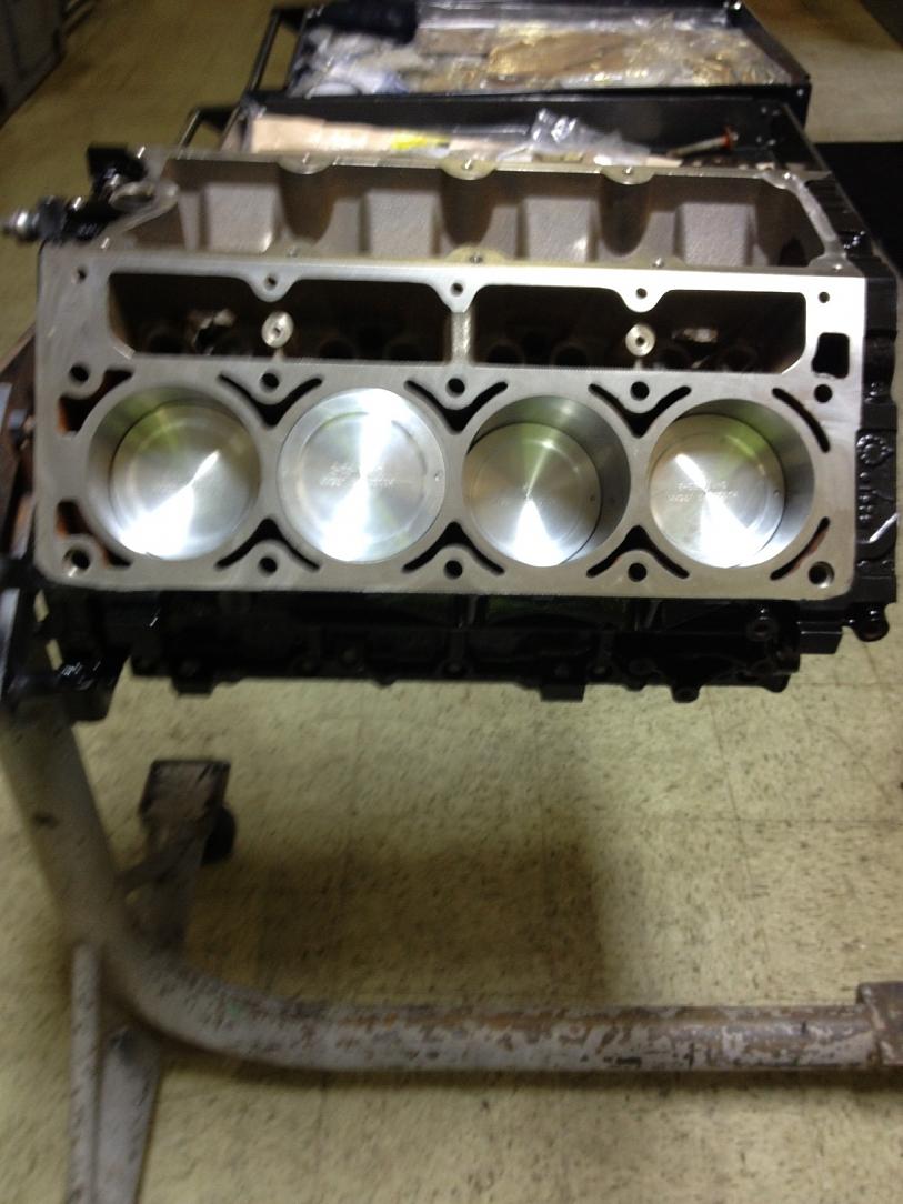

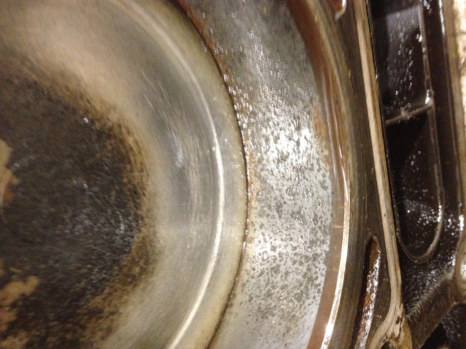

I picked up a complete minus intake 02 LQ4 6.0 that was a high mileage core for $300. Got it home stripped it down to see what i had bought.

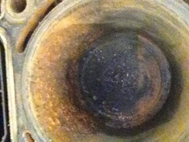

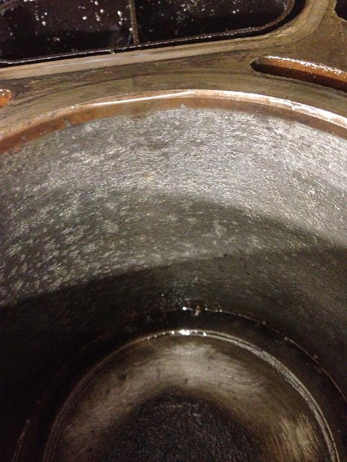

Upon disassembly i found 2 cylinders that had standing water in them.
Cleaned with a wire wheel to discover some pitting..

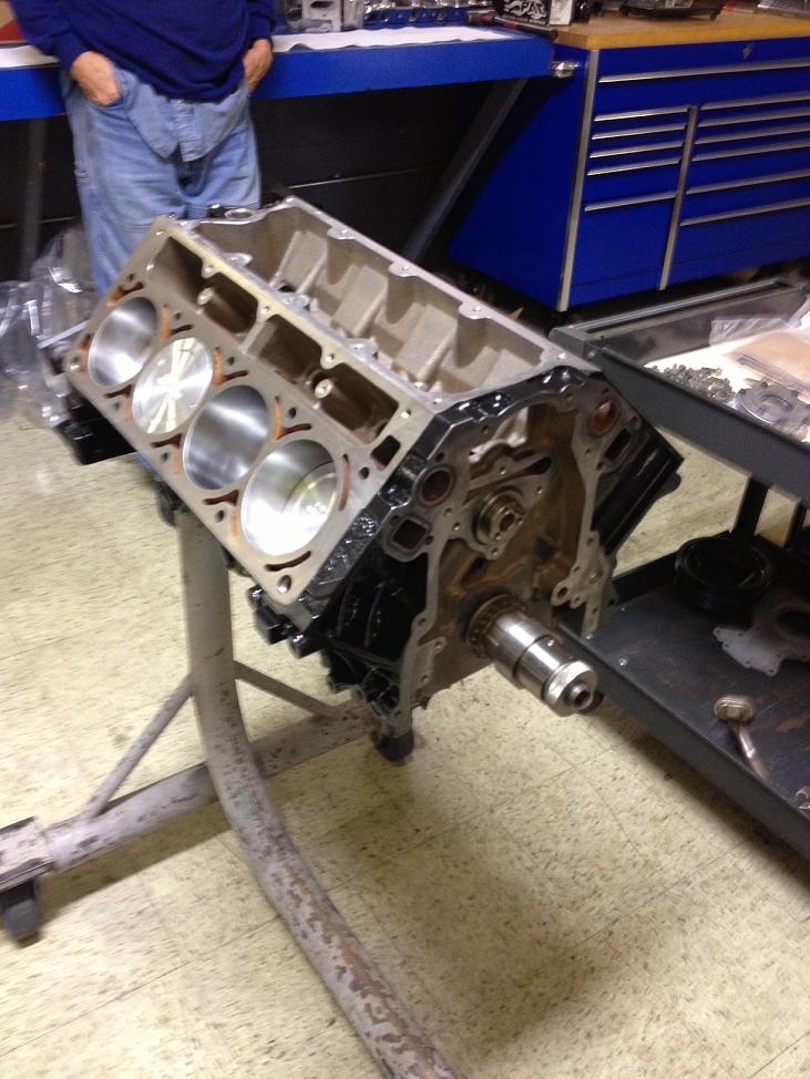

The block was then sent to WALL2WALL racing for machine work and assembly of the short block.
As you can see in the pics still in progress but this is where we stand!
224R cam is going in along with ls6 oil pump and then all covers n pan will be put on
Bottom end is complete..almost! ON TO THE TOPEND!

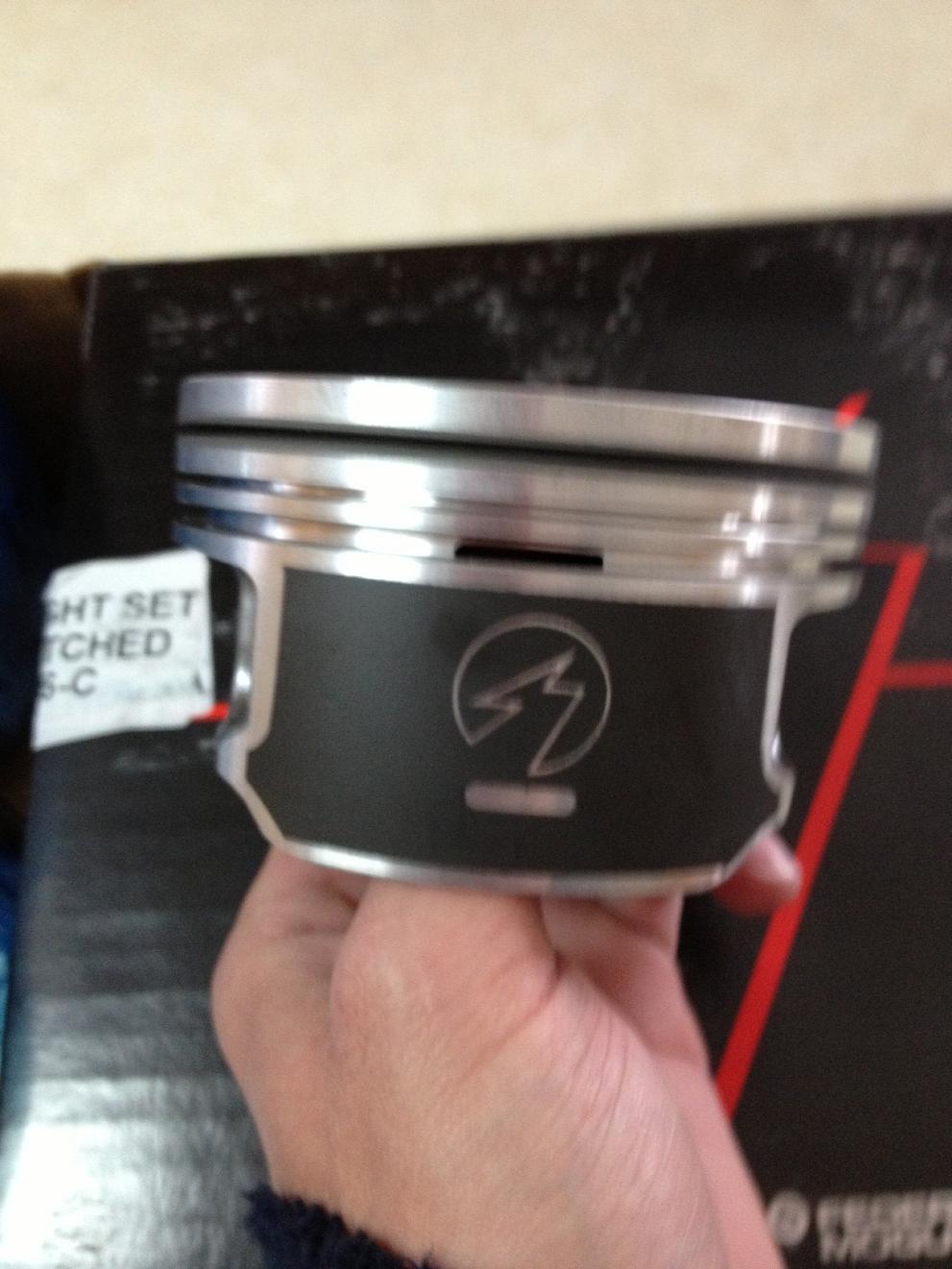

few more pics of various parts along the way

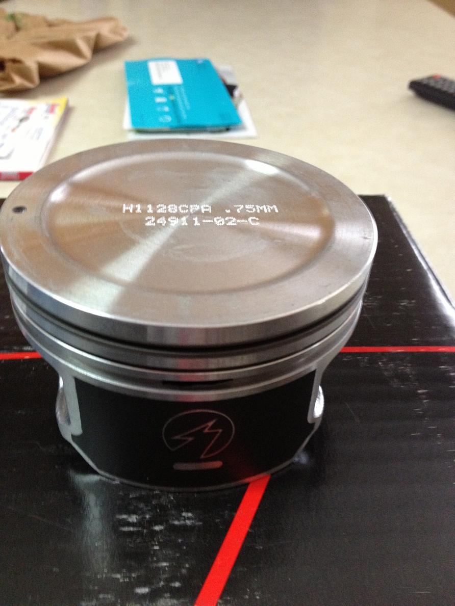

Speed pro piston and rings 4.030 bore

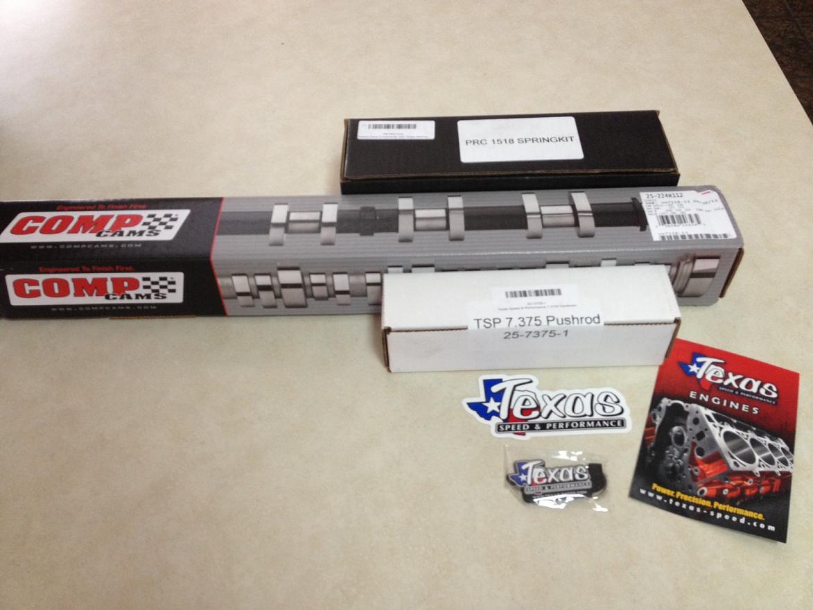

TSP 224r cam kit

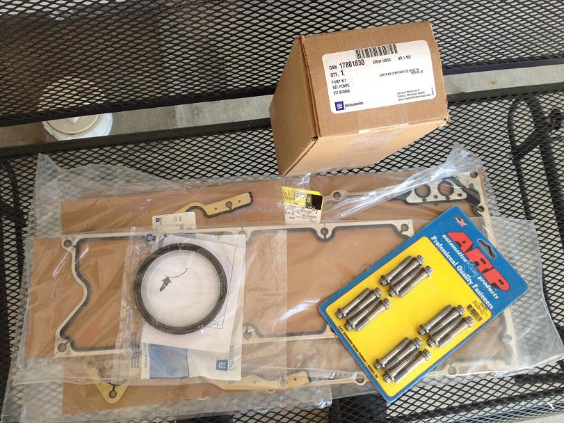

Oil pump,gaskets,ARP rod bolts
Attached Thumbnails 370 build on a budget-speed-pro1.jpg   370 build on a budget-gaskets-arp-oil-pump.jpg   370 build on a budget-tsp-cam-kit.jpg   370 build on a budget-short-block-front.jpg   370 build on a budget-speed-pro-side.jpg
