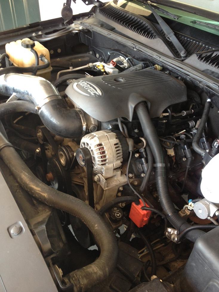

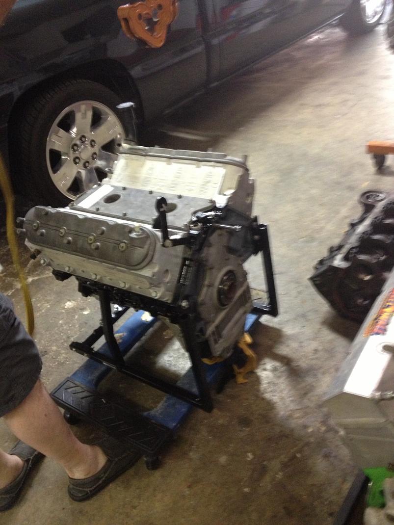

Heres a few pics from the build and a installed pic.
Put about 200 miles on it so far runs strong.
Got a lil tune done pulls strong till 6700 maxxing out my regular 8.1 31# injectors. At 6700rpm they are running at 108% duty cycle.Will swap in some 36 flex fuels soon.
Only made one pull to get a half way decent tune on it but its a beast.
Most say a 224r is to small of a cam for a 370 but it works perfect with my 390 gears and 3200 stall.Doesnt lack power or torque at any rpm!

Im surprised those injectors are only at 108% duty cycle. So I think the 36 lbers should be okay, but they may be over 80% IDC. When I was N/A at sea level with the 44 lb marines I was seeing 70% IDC (only 55% at 3000 ft above sea level lol)
