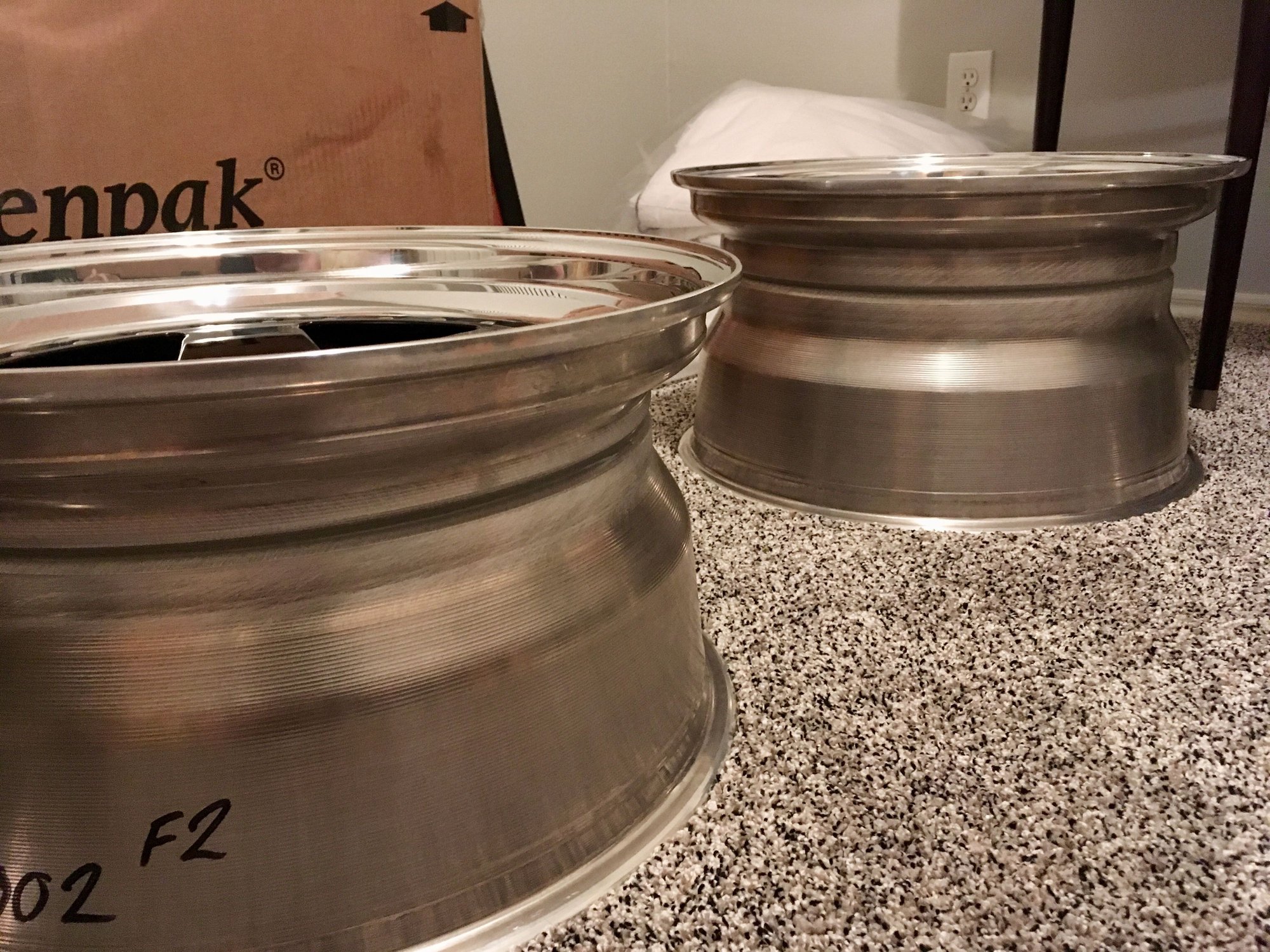

got some new wheels tonight...I wanted a light weight wheel and these popped up on Craigslist for a good deal...some 3 Piece CCWs Classic 5's...18x9 and 18x10...gonna run some Mickey Thompson 30"x12.00" which are equal to a 305/50R18...stock 275/55R20 are 31.9" tall so will only be a 1" drop from the tires and then I will also be installing the Tahoe PPV rear springs and removing the .5" spacer in the front so total drop with suspension changes and the new wheels and tires will be 1.5/2.75...fronts weigh 24lbs each and rears 25.2lbs each...tires weigh 36lbs each..should be a nice decrease in rotating weight...

Those look sweet.
