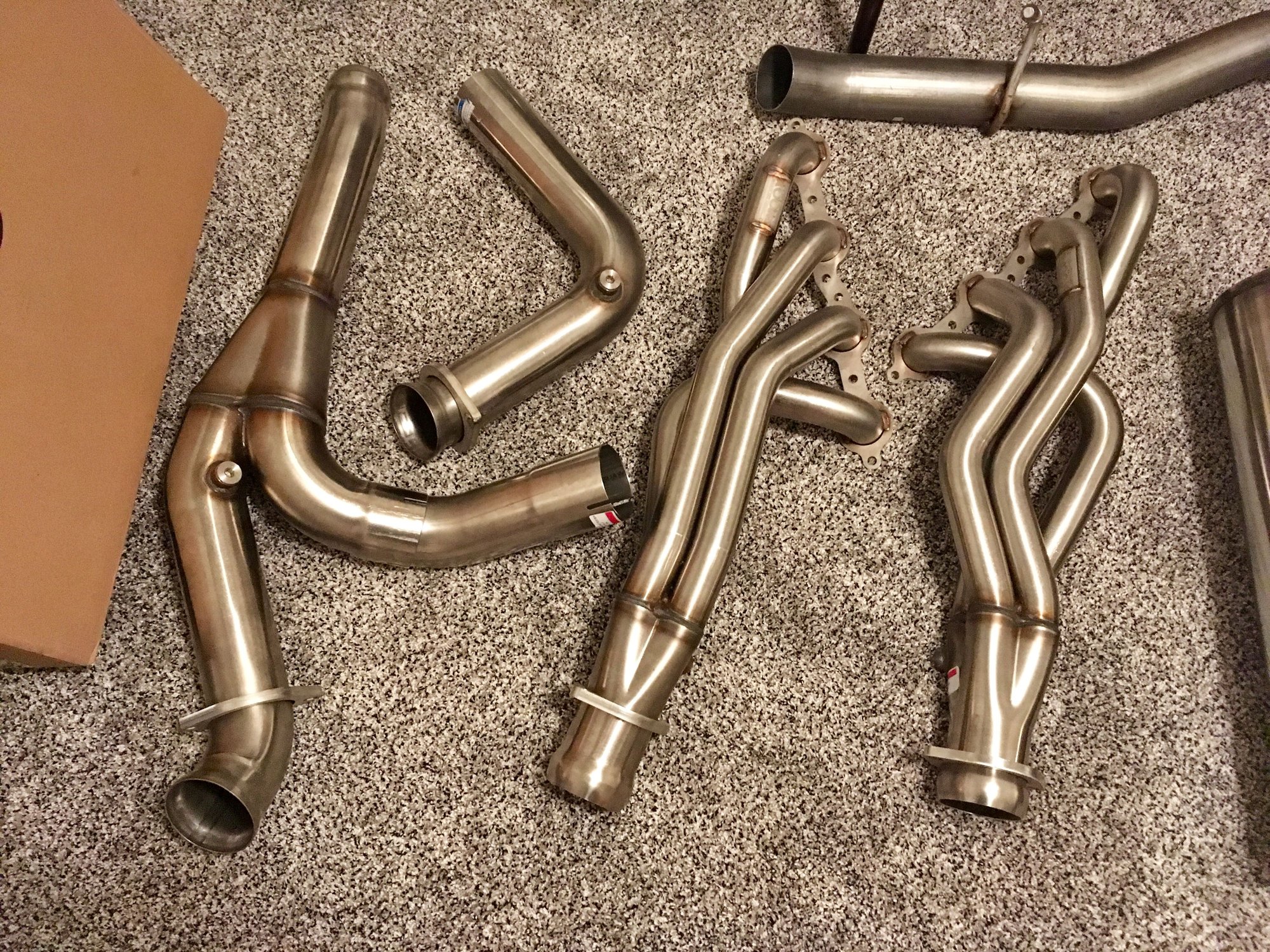

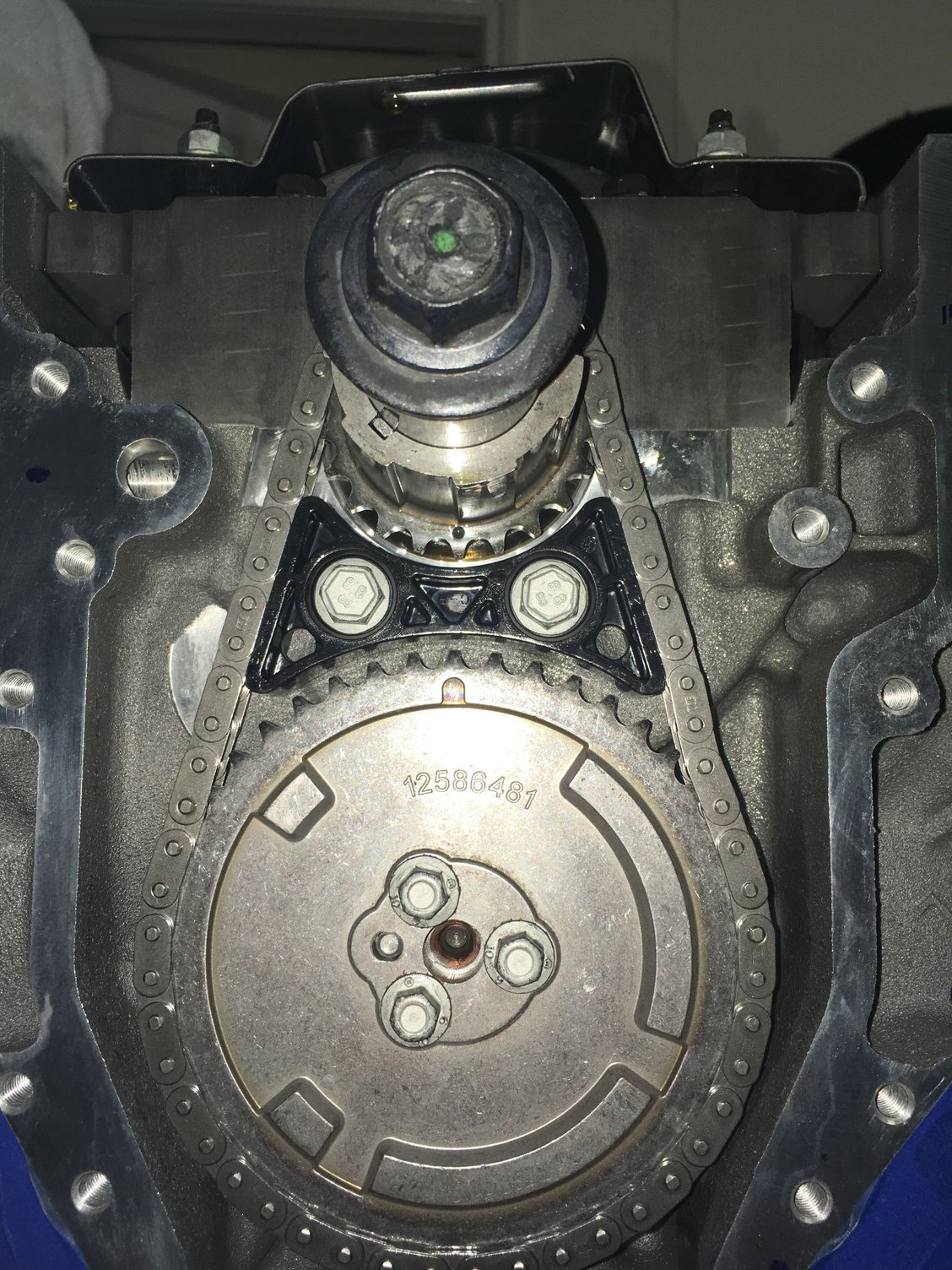

A little progress tonight...pulled the LS3 Cam and went back with the Cam Motion 6.2 Truck Cam...got the engine bolted back up and my 1 3/4" Kooks came in...
Pulled the Timing Cover, the Pan, the Pickup Tube (gonna have to swap it for the truck Pan and Tube)
Cam Motion (Top) Factory LS3 (Bottom)
Cam Motion 206/216 .553 .553 117+4
So I just turned the engine upside down on the engine stand so I didn't have to worry ab the lifters when I pulled the stock cam...Dot to Dot with the new LS2 Chain Damper

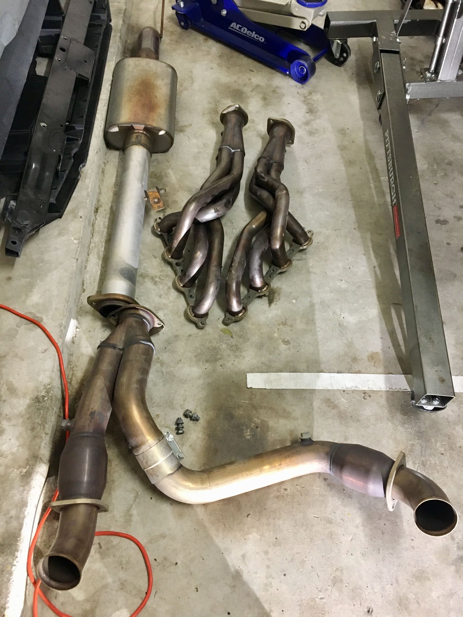

Some progress today...
Old Exhaust is out...
L96 is out...
Empty Engine Bay...
Done for the day...
